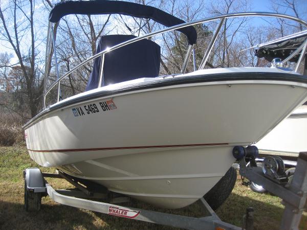

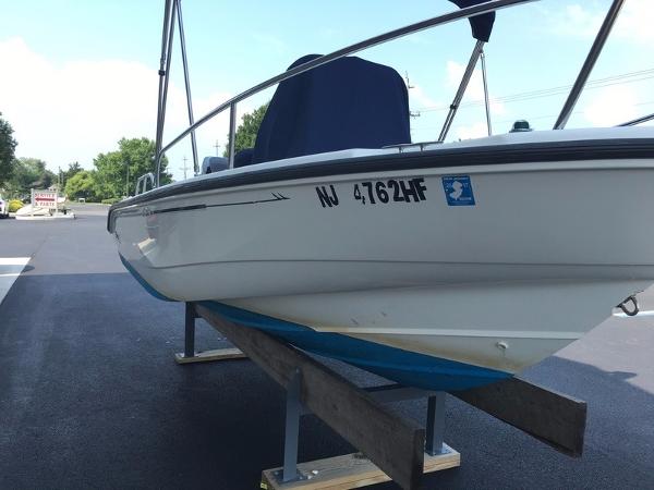

As you can see in these pictures the 2006 190 Outrage has a deeper and sharper bow entry (Deeper V) that is carried farther aft than the 2002 180 Dauntless. The Outrage will have better sea keeping abilities than the Dauntless. While the Dauntless will have better stability than the Outrage at rest.
2002 180 Dauntless:

2006 190 Outrage:

Wow--that 190 Outrage does seem to run deeper than the Dauntless. Thanks for taking the time to take the photos. admirable.
