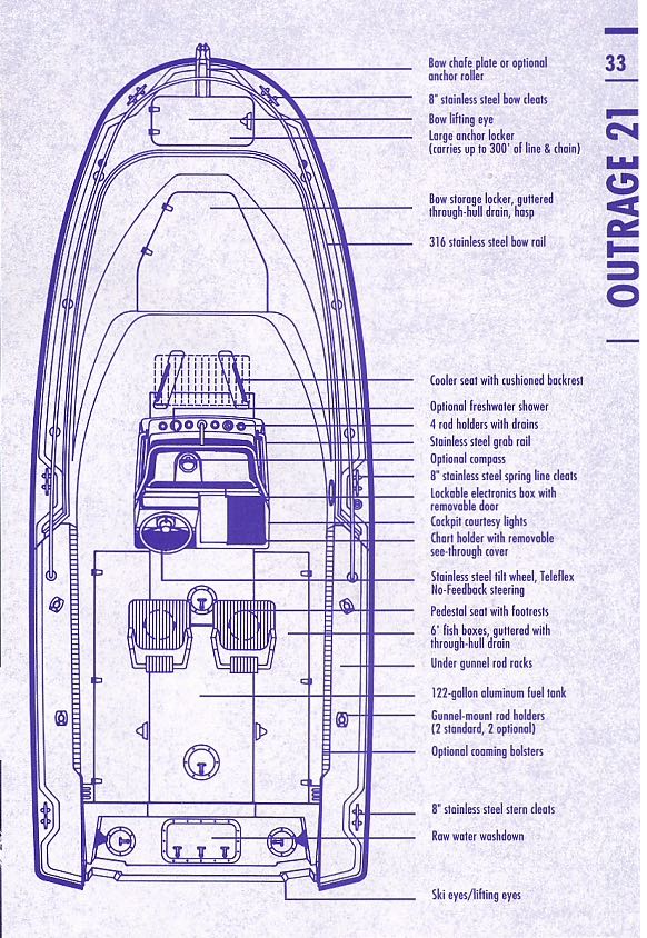

Many Outrage and Conquest models in the 1990's through today have an inspection hatch and access ports in the floor of the splashwell. Over many years of exposure to salt water and the elements, the gasket can wear and not maintain a seal.
The 1998 Outrage 21 has three hatches in the splashwell as do the Outrage 23, Outrage 24 and Outrage 26. Their Conquest cousins did as well.
Fig. 1. View of deck layout of an OUTRAGE 21.
I worked with several Outrage/Conquest owners from Australia recently to find a solution to their leaking hatches. After much searching and contacting vendors, it was decided to replace the large inspection hatches with locally available ones. Shipping from the US was too time consuming, and expensive.
