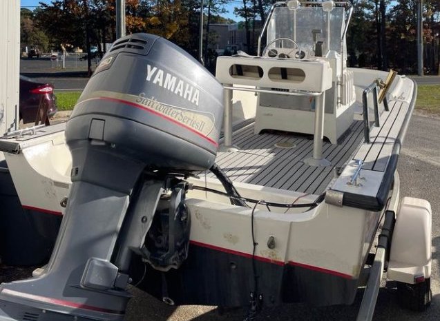

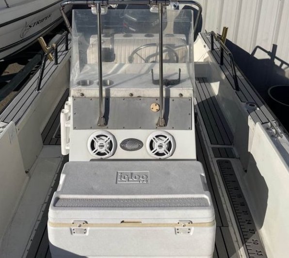

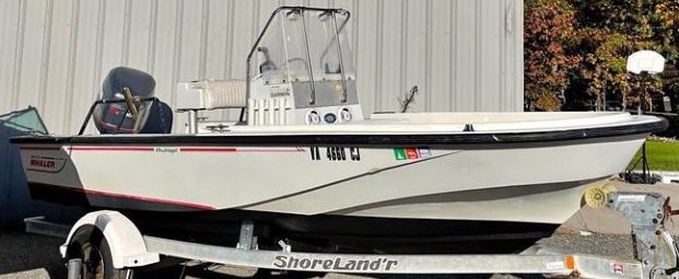

Thanks everyone for the replies. The boat definitely has 'Outrage' spelled out on the hull, not Guardian, however, some of the components appear to be beefed up. For instance the gunwale tops do not have wood; however, I am not sure if the wood inserts were removed and covered with EVA foam sheets (which is a little concerning but may also be used as negotiation leverage).
Below are some photos of the boat. Notice the stern rails and metal plate on the front of the console.
Fig. 1. The boat under discussion which the seller represents as a GUARDIAN.
Fig. 2. The boat under discussion.
Fig. 3. The boat under discussion.

Postby Phil T » Tue Jan 03, 2023 5:55 pm
It is possibly a workboat. See my other information I shared.
Several components have been replaced or covered up.
These days there isn't a premium for a Guardian versus an Outrage.
As presented the boat shows it has been used hard. Pricing opinions are going to run the gamut.
That trailer setup looks wonky. The aft cross member should be at the far end of the frame and it does not appear that way.
Personally I would be concerned with the engine, fuel tank and trailer condition. I would ballpark the boat at 10-14k.
Note:
New 150hp is 20-22K
Trailer 3-4K.
Fuel tank 1500-3000.
Also - I hate the foam sheets on the interior. It is used to cover damage or a superficial way to help appearance. It will not last very long and is a pain to remove.

Postby jimh » Tue Jan 03, 2023 9:35 pm
It looks like the hull decal says "OUTRAGE." The deck has been replaced with what looks like faux wood decking material. The leaning post is unusual; the typical OUTRAGE seating would have been twin swivel seats or a reversible pilot seat.
How long is this boat? Whenever you mention a boat model like OUTRAGE, you have to define the length. There have been OUTRAGE boats made in 17, 18, 19, 20, 21, 22, 23, 24, and 25-foot lengths.
Regarding the gunwale caps, the typical older (c.1984) OUTRAGE boat would have teak wood gunwale caps. At some point, there was an option to have laminated gunwale caps instead of teak wood. Then the standard configuration changed to laminated gunwale caps, and wood was an option. Finally, wood was no longer available and all the gunwale caps became laminated.
Many owners prefer the teak wood gunwale caps for their more classic yacht appearance, but the laminated gunwale caps are more practical as they don't need much maintenance.

Keep in mind with the age of these boats, owners have often modified them from their original state.
The decals have been changed. The top stripe with the model name was a 1990's thing. A 1980's boat would have the black 1" stripe and the model name (Outrage or Guardian) in black below the stripe on the aft corner.
I would suggest the gunwale caps are fiberglass or painted aluminum. Tap on them to determine which.
