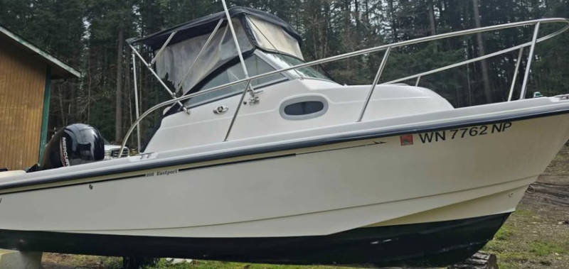

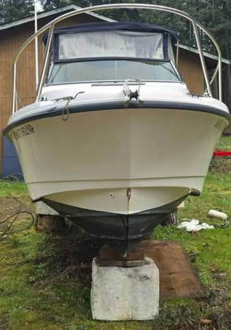

Q1: what is a suitable trailer for a 2005 205 EASTPORT that weighs 2,800-lbs (dead weight) with its engine?
Q2: Should I be buying a 4,000-lbsrated tandem axle trailer?
ASIDE: I'll be towing it with a Tacoma.
