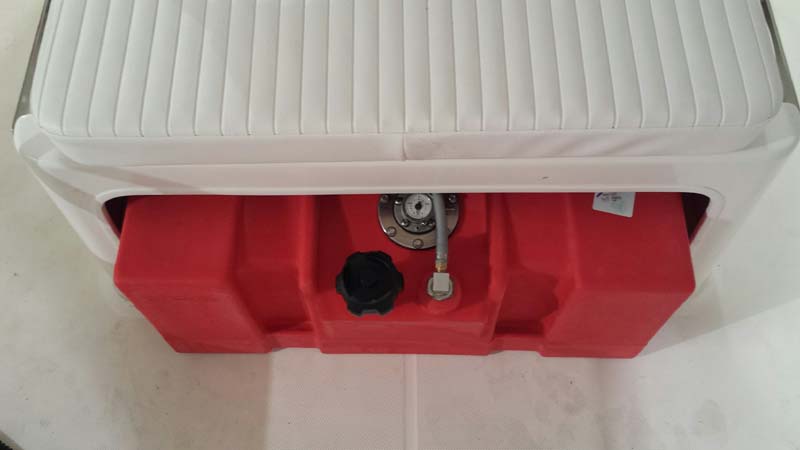

timf
Posts: 32
Joined: Mon Oct 19, 2015 4:26 am
Location: Oregon
Re: Moeller 22-gallon On-deck Fuel Tank
Postby timf » Thu Mar 31, 2016 3:14 am
Ridge Runner wrote:Correct - I have the brackets screwed into just the deck (no wood), but I did bed the screws and brackets with 3M4200. After seven years of heavy and rough use, mostly water sports so a lot of stress with a full tank in quick turns - jumping on plane - wake jumping, ect, I have not had any problems. I have had replaced the filler neck fuel cap/gauge twice.
I had the same experience on a Montauk 170. The front tank screws hit wood and the rear did not. I also used 3M4200 and is holding fine.
I used this type of strap kit to hold the tank in. It makes it easily removable and a clean installation.
http://www.marine-products.com/moeller-hold-down-strap-kit-035711-10.html
This picture was before the straps were installed. The EPA compliant version of the tank is red. I ran wires to the console in case I wanted to add an electric sending unit later, but have not done that.
