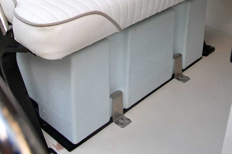

ScooterCO |
![]() ![]() ![]() I just installed my new tank this past weekend. here are some links. My original Pate was rigged with the fule line in front of the tank, so it was easy to install the new Moeller. We aslo installed a new Yamaha 10 micron fuel filter as well. http://s134.photobucket.com/albums/q115/swr540/?action=view& current=Montaukfueltank2.jpg&newest=1 http://s134.photobucket.com/albums/q115/swr540/?action=view& current=Montaukfueltank3.jpg&newest=1 http://s134.photobucket.com/albums/q115/swr540/?action=view& current=Montaukfueltank.jpg&newest=1 Filter http://s134.photobucket.com/albums/q115/swr540/?action=view& current=Montaukfuelfilter.jpg&newest=1 Not sure if I got the links posted correctly or not? Here goes! |
ScooterCO |
![]() ![]() ![]() Looks like the links worked but I should have used spell check........... Sorry for the typos. |
tbudde |
![]() ![]() ![]() Thanks for posting the pics. That is very helpful. I wonder if my existing tank is a Tempo and not a Moeller since it has the indent for the fuel line. I am going to go ahead and order one of these and see how it fits on my '84. |

kidishi |
![]() ![]() ![]() Those tanks look so much better in white! As for the mat I think it is the factory mat that came with the whalers. Orginally for the two 6gal? Tanks. My whaler has the same mats under a Pate tank I am soon to replace. The inside edges were beveled flat for one large tank . Caleb |
LabRtvr |
![]() ![]() I recently installed the new tank on my 2003 170 Montauk. The foot print is actually smaller than the 24 gallon Pate it replaced. Approx 18.75" x 28.75". I was only able to fill with 21.5 gallons of fuel however I am not sure of how level the tank is when its on trailer hooked to my tow vehicle. Unlike the red Moeller tanks, the fuel level cannot be seen through the side of the tank. |
ScooterCO |
![]() ![]() ![]() Calab is correct, those mats are the factory mats for the two 6 gal tanks supplied with the boat. The two inside edges were trimmed to make a flat area to set the Pate on to. This was the dealer solution for installing the Pate tank, and the rigging of the fuel line through the floor in front of the tank was also the preferred solution. |

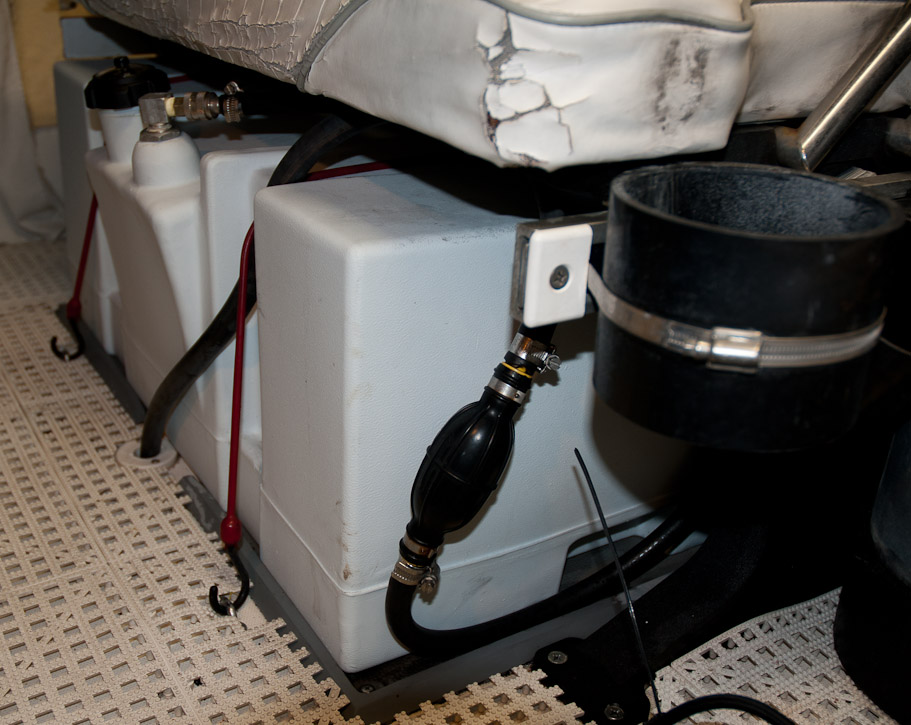

![]() ![]() ![]() I installed the Moeller on the Montauk Saturday. It was very straightforward: - Pump the existing gas into a couple of jerry cans. Done. Way way easier than the new steering cable I installed too.

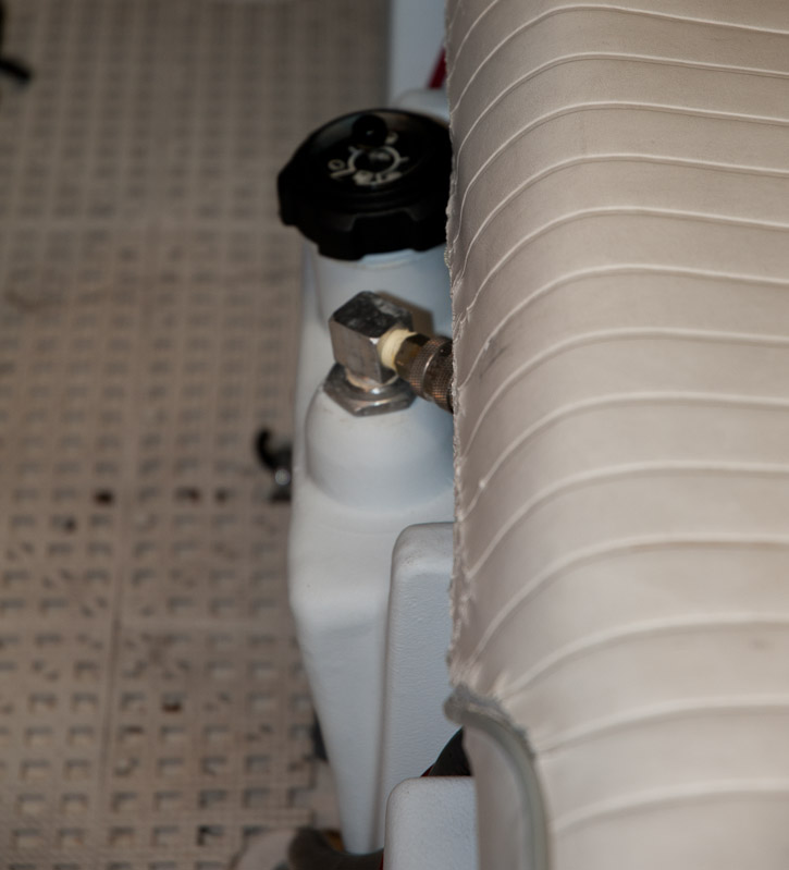

Chuck Tribolet |
![]() ![]() ![]() One thing I'm not 100% happy about is that the fuel outlet must face aft. Even with a street ell in it to run it down, it still sticks farther behind the seat than I'd like. I'd prefer that it pointed at about the 2 o'clock position, and use a straight close nipple and route the line across the top of the tank.
ScooterCO |
![]() ![]() ![]() Chuck, the fuel outlet is a swivel block allowing the straight hose barb (not included) to be located in any direction you desire. It is one of the "big" features of this tank! (according to Moeller) |
Chuck Tribolet |
![]() ![]() ![]() I put a wrench on it and it didn't want to move. I'll try again this weekend.

Chuck Tribolet |
![]() ![]() ![]() It moved. Now I gotta get a longer piece of hose so I can position the bulb with the output side up. The trick to swiveling the fuel line is to loosen the big
Chuck Tribolet |
![]() ![]() ![]() Here's a couple of pictures: http://www.garlic.com/~triblet/pictures/CT_2010-09-12-074559.jpg Note how I routed the hose across the top of the tank, down Also note how the filler is completely after of the seat. It's got a gauge, but I still like Pate's window.
Chuck Tribolet |
![]() ![]() ![]() We were out today with a full tank, and while generally pretty flat, if I got to going too fast, the Moeller had two habits of note: 1. The gauge in the cap got gas in it when it got bumpy. This 2. It leaked at the cap. Dunno if this is related to #1.

![]() ![]() ![]() Today, I ventured out into Port Royal Sound to test the manually vented cap sent by Moeller . Works like a charm -no leaks -period. I can live without a cap with a gauge for a few days until the replacement cap with a gauge arrives. |
Mumbo Jumbo |
![]() ![]() ![]() Sixer: I remember correctly, the original gauge was off a bit -but that didn't matter much since I just want an approximation. I keep a full 3 gal. spare tank with a line and bulb for use in the event the bulb goes bad or someone else runs out of fuel while using the big tank. I'll report on the new gauge after it arrive and is tested. |

dscew |
![]() ![]() I just ordered one of these tanks for my Katama with the reversible pilot seat. I was unable to find it on their website, but a phone call to 1-800-518-3808 got it. Great price, $189.00 and $2.99 shipping. They don't have one today but will order from their supplier. Nice customer service, too. |
jimh |
![]() ![]() ![]() Who did you order the tank from? |
dscew |
![]() ![]() Whoops, I'm sorry, it was www.MidwestHuntersOutlet.com, same site that bboeri ordered from. |
dscew |
![]() ![]() I received the white Moeller tank about a week ago from Midwest Hunter's Outlet. It fits perfectly under the RPS in my 1974 Katama, with plenty of room for the fuel hose to go into the tunnel opening. I have to say this tank is beautifully made. I have it sitting on a DriDek type of pad, about 1/4" thick, and there is about 1" of room between the top of the tank and the bottom of the seat, exactly enough space to build a pair of custom aluminum brackets to hold the tank from the top instead of drilling holes in the floor to mount hold-down clips. I'll post a link to pics when I have the install completed. |

![]() ![]() ![]() I just ordered one of these for my Montauk 17. Found three of them on Amazon for $229 with free shipping. Seemed to be a pretty good deal compared to other shops. [Changed topic and began to discuss the restoration of this boat. This is a great topic, but please start a new thread for it. Thank you--jimh] Thanks again for a great site! I've learned a ton here over the last couple of days. |
GAwhale |
![]() ![]() ![]() I am contemplating buying a new Moeller fuel tank for my Montauk. It is quite confusing. I have found them on E-Bay , Amazon, and Northern. It looks like the cheapest one is Northern: $219.99 plus $20.99 for shipping. It is on back order right now. The part number for Northern is 031526 for a red tank. I assume the part number 031626 is the white tank. Is my assumption correct? Is there any difference between the two other than the color? Many Thanks |
