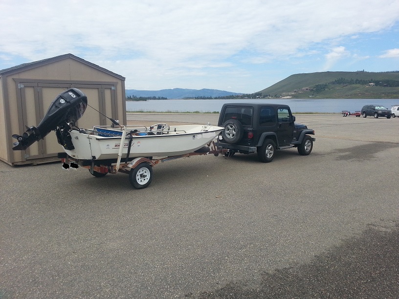

I misspoke when I referred to the battery as a "gel pad". It is a Cabela's Advanced Anglers size 22 battery with absorbed glass mats between the plates for isolation and vibration dampening. The technical description can be found at http://www.cabelas.com/custserv/custser ... MBatteries. It is significantly lighter than the original lead acid battery. They also claim a low (~3% per month) self-discharge rate. I will have a better handle on this come spring.
- Picture 2.jpg (212.05 KiB) Viewed 10019 times

Wow that engine almost looks as big as the Jeep. All a nice set-up and great you're back boating

When I picked it up, a guy at the marine dealer remarked, "When I looked at that boat for the first time, I thought that that is an awfully big motor for a little boat."
It actually weighs only about 80 lbs more than the 35 hp Johnson 2-stroke it replaced (and it is about 20 or so lbs lighter that the current Evinrude 40 hp 2-stroke). I traded weight for power, displacement, and an EFI system that would adjust to altitude.
BTW, the boat is sitting at an angle to my line of sight, and the apparent size is enhanced by the wide angle lens on my cell phone. But it still looks big (even though it is much smaller that the 4 cyl 40 and the 50).
