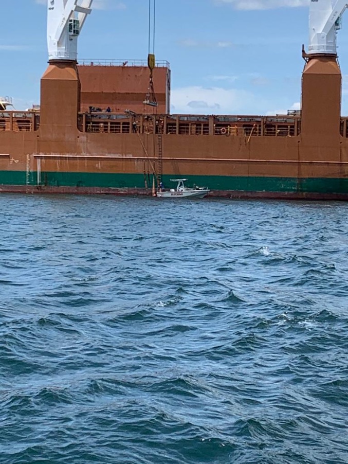

Yesterday our 40-year-old Outrage V-22 arrived in The Netherlands in the Port of IJmuiden after traveling from Newport, Rhode Island. I will upload some photos (once I have figured out how to do it- [Moderator see the INTRODUCTION FORUM for an article on how to add images to posts].

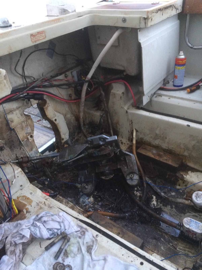

The hull, console,and T-Top are stunning, the outer shell and inner shell are great--all looks in good shape.
The engine and the sterndrive are however in terrible condition. The inboard engine was half under water and a lot had found its way into the engine, too. The sterndrive was so lose you can swing it around by hand, left to right for about 10 inches, hydraulic steering useless in this case. Just not good and I am annoyed with the seller about this
Also the sterndrive does not match the engine (different ratios 1.3 vs 1.7) so it is a botch job and basically a write off.
Of course this is the gamble you take when you buy a boat overseas without the chance to go check it out (thanks Covid-19)
Re-powering remains at the top of our list and despite all the engine headaches, the boat is lovely. I am very happy to be a Boston Whaler owner again.
The OUTRAGE V-22 is quite different with the sterndrive, and it has a beautiful wooden swimming platform on the transom.

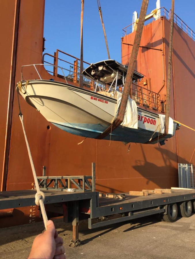

Postby Phil T » Mon Jun 07, 2021 8:52 pm

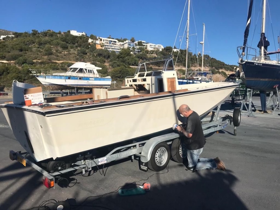

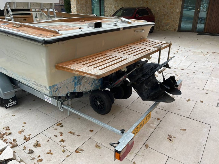

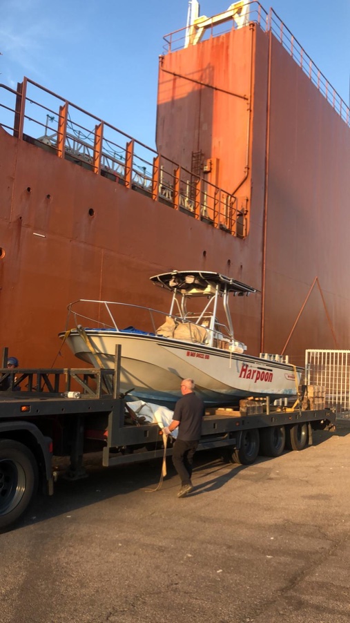

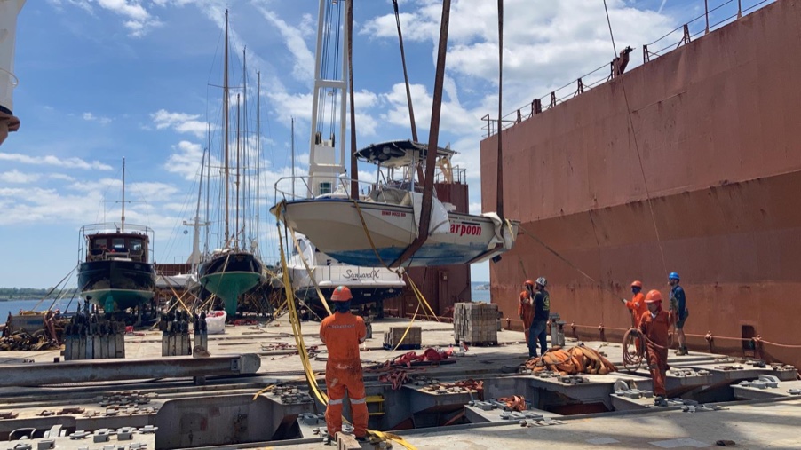

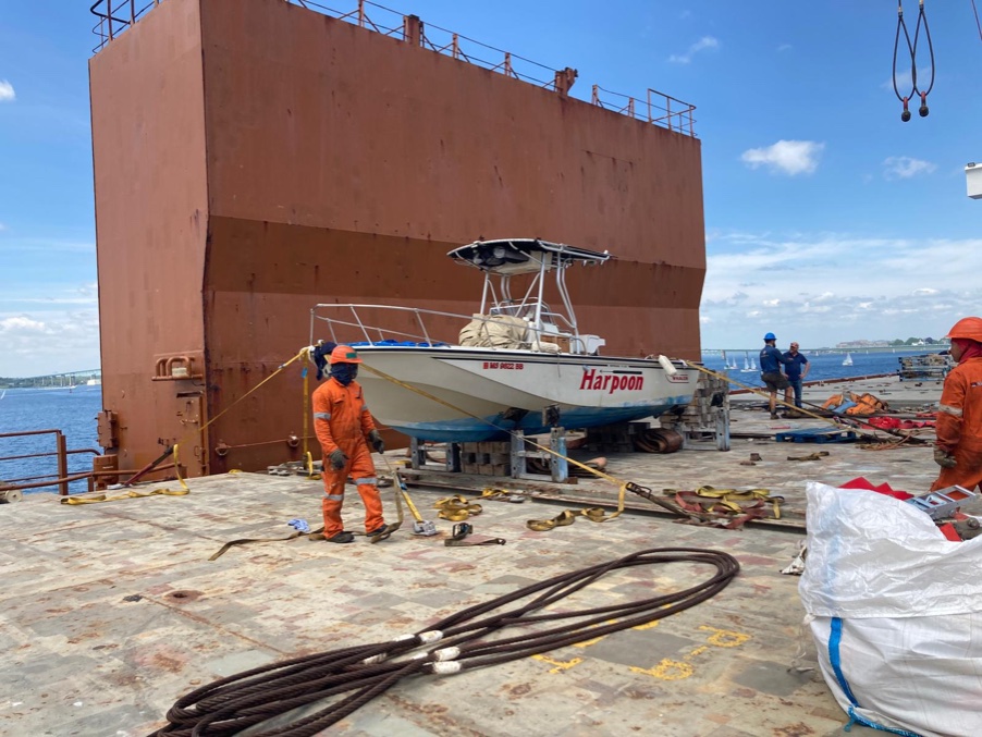

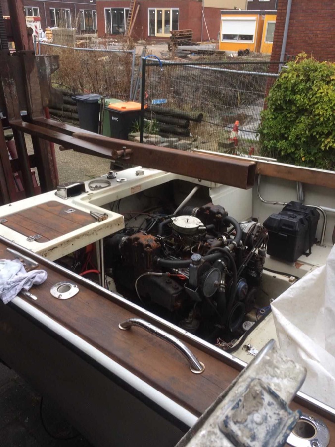

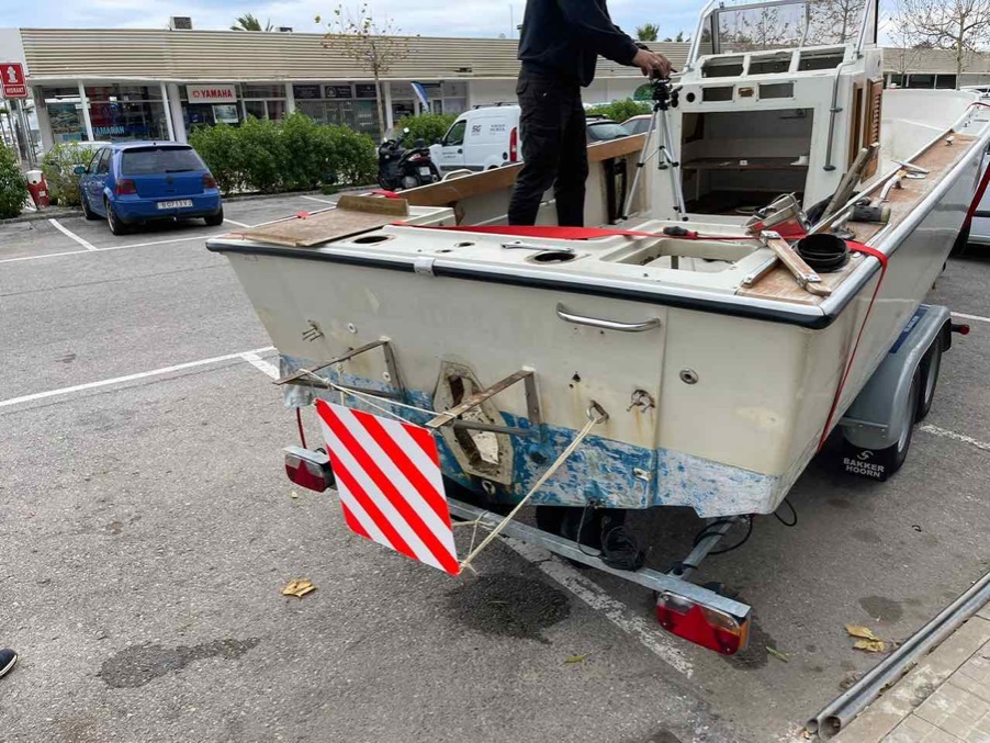

Fig. 1.
Fig. 2.
Fig. 3.
Fig. 4
Fig. 5.
Fig. 6.

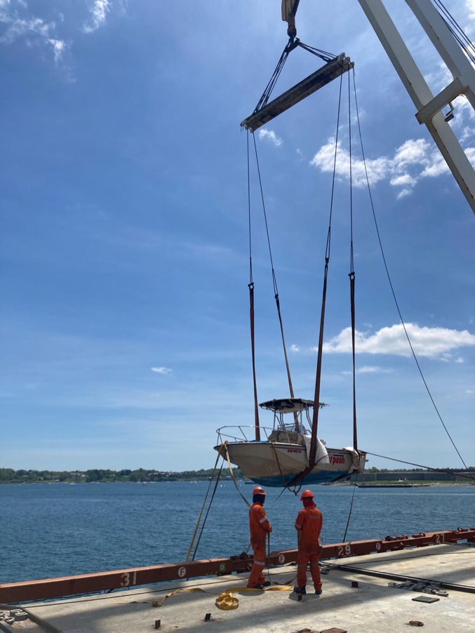

Here are some photos from Jan showing the arrival.

Amazing experience with these shipping people at Sevenstar Yacht Transport. They have arranged it all, from dropping the boat in the water in Newport, towing her to to ship (anchored out) loading her, strapping her to the deck and at the port of destination lifting her off the deck onto a flatbed trailer.
All very professional solutions and quick too. Also the administrative side was handled by Sevenstar including insurance and import duties (which by the way are OUTRAGEOUS, due to the US/Europe trading disputes we had to pay a ...tatata ..."anti dumping charge" of 25% !!!).
That however, is not the shipping line's fault, I could not be happier with their service and would recommend them to anyone shipping a boat across big splashes of salt water.
Now it is up to us, repowering and doing some catch up with the maintenance and general appearance of Harpoon. She is a nice little 1981 Whaler, certainly worth our efforts. Not sure if we can use her this season, the engine trouble may keep her ashore for some time.

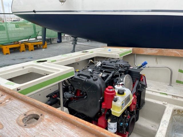

Harpoon has been in Holland for a little while now and I have decided to repower, the old Yamaha small block V-8 sterndrive is 30 years old and needs to retire. I am looking at Volvo Penta Aquamatic 240 or 280 HP with a 6 cylinder block and a sterndrive with duoprop. Does anybody have any experience with the brand in sterndrive configuration ? Maybe even in IPS configuration (forward facing props on the sterndrive)

We have started the restoration of the Outrage V-22. Taking out the old engine and picking up the center deck revealed a massive amount of dirt, old spark plugs, oil, cable ties, acorns and lots more. Wel, the job is on, and I am very happy with what I find so far. The boat is in a remarkably good state after 40-years of who knows what. A happy Whaler owner here!

It is great to work on this boat, taking her apart shows the clever simplicity of how these boats are put together and how much progress can be made by doing relatively easy jobs and without specialist knowledge. Putting it all back together may present a question or two, will see.
Now I am struggling to find a solution for the flush mounting of my 7" Raymarine chartplotter. We have the width but not really the height. Trying to avoid using the brackets and squeeze it into the "dash" next to the switches and gauges.
I am amazed by the quality of the woodwork as well, With some tlc it will be as new. Our boat (1981) has the teak gunwales and they are still in good condition, needs sanding and varnishing, that is all. great stuff !

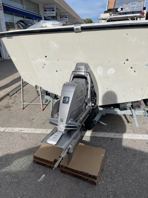

Jan was nice and sent me some photos to show recent activities.
Fig. 7.
1_Stern Drive.jpg (237.18 KiB) Viewed 578359 times

Below you find some pictures of the Boston Whaler Outrage V-22 Harpoon upgrades. We had a new tank fabricated in 5mm aluminum, the new Volvo Penta engine is in with a new drive unit, we are working hard on the wooden parts, and have installed all new instruments for engine and safety equipment including a 7-inch Raymarine plotter. There is still plenty to do, but we are going fast.
Water inside the hull seems to be very limited, and all looks good.
Fig. 13. Sanding, Sanding, Sanding
sanding sanding sanding.jpeg (66.16 KiB) Viewed 574674 times

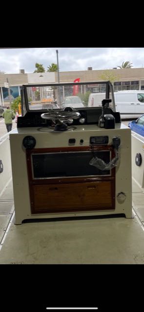

Fig. 14. New Console set-up
new console set up.jpeg (22.48 KiB) Viewed 574674 times
Fig. 15. Transom view with outdrive
new drive unit.jpeg (62.51 KiB) Viewed 574674 times

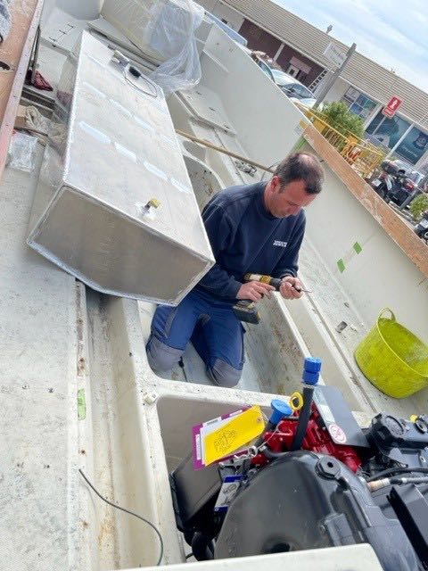

Fig. 16. Installing new aluminum tank
newly fabricated fuel tank.jpeg (62.81 KiB) Viewed 574674 times

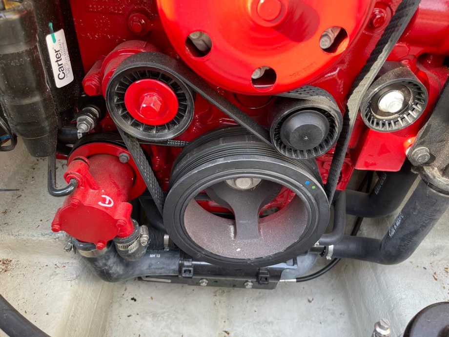

Fig. 18. Volvo Penta 250-HP
new Volvo Penta 250 HP.jpeg (50.93 KiB) Viewed 574674 times

Re: 1981 Outrage V-22 Sterndrive
Postby jimh » Thu Apr 21, 2022 10:30 am
I am really enjoying see the progress of the restoration of this 1981 OUTRAGE V22 Sterndrive boat.
I notice in Figure 18 that the engine for the stern drive sits very nicely in the compartment molded into the hull liner that would, for an outboard-powered model, have been a below-deck aft storage well [or fish well or live well or wet well or whatever one likes to call it]. I would like to see another photograph that shows how the engine mounting was accomplished, and if any lumber or boards were employed. Perhaps Jan (AKA HappyHour) can update that for us.
Also seen in Figure 18: that aft molded section connecting the gunwales looks very much like the molded component used on my REVENGE 22 W-T Whaler Drive boat that creates the aft deck with three hatch openings.

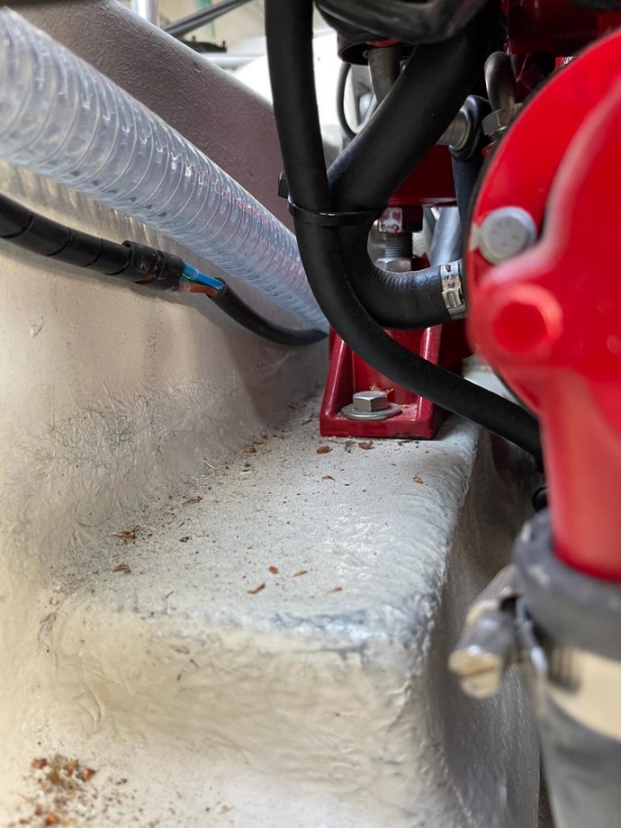

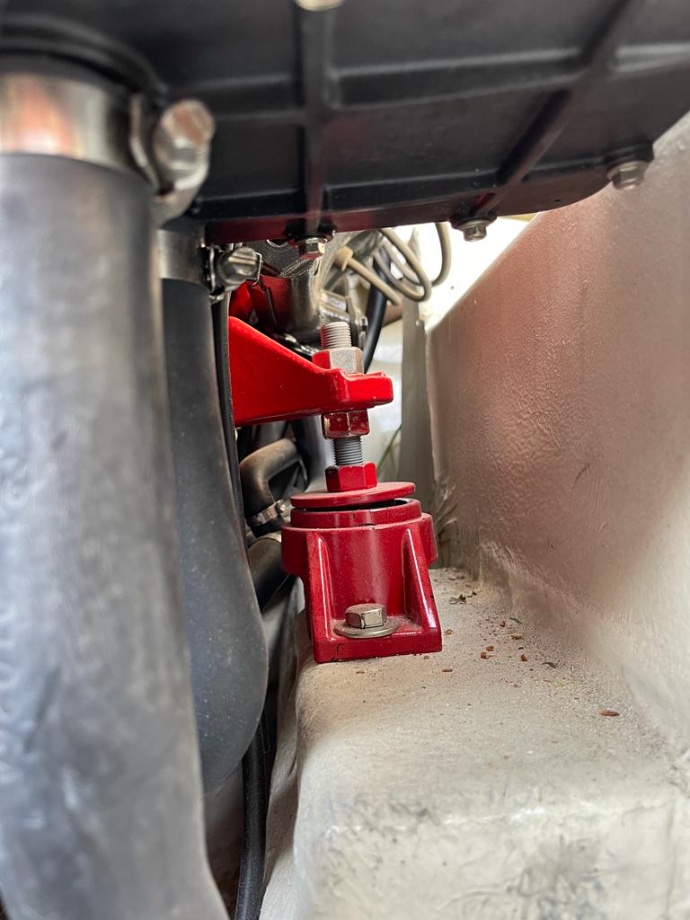

We had the engine bay re-glassed, it was in seriously bad condition. The engine rests on the higher stringers to port and starboard and sits nicely inside the engine bay. We had to make some adjustments to the cross bar in order for it to clear the engine.
Fig. 19.
Harpoon engine front.jpg (232 KiB) Viewed 574639 times
Fig. 20.
Harpoon starboard engine foot.jpg (184.02 KiB) Viewed 574639 times
Fig. 21
Harpoon engine feet.jpg (159.86 KiB) Viewed 574639 times

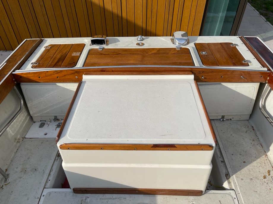

The aft deck is the three hatch version which, I believe, is also used for the WhalerDrive boats.
Engine cover box fits exactly with about an inch clearance at the top. This Volvo Penta engine is a little bigger than the previous MerCruiser block but it all fits.
We have to fabricate little aft deck floor sections, one missing and one so bad that I don't want to put it back.

Almost ready to put the swimming platform back on.

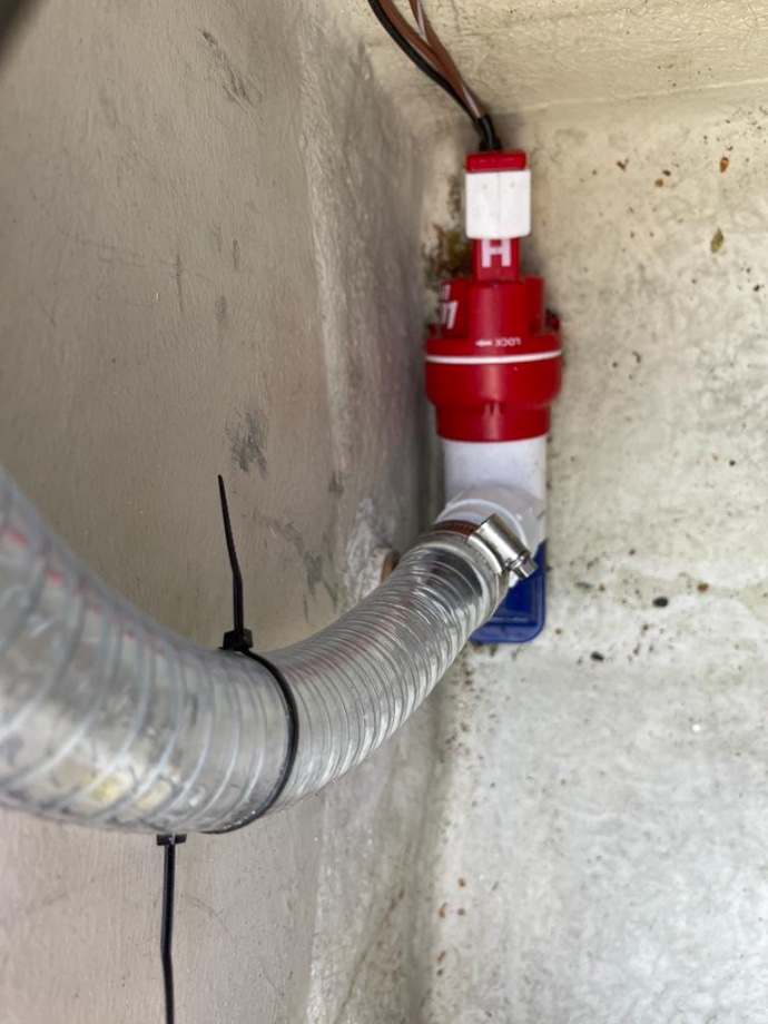

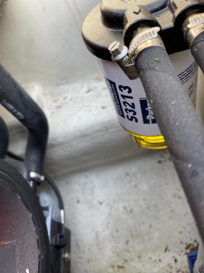

Fig. 22.
Harpoon engine bilge pump.jpg (152.77 KiB) Viewed 574638 times
Fig. 23.
Harpoon Racor filter.jpg (138.74 KiB) Viewed 574638 times
Fig. 24.
Harpoon aft hatches & engine box in progress.jpg (198.29 KiB) Viewed 574638 times
Posts: 1804
Postby Jefecinco » Fri Apr 22, 2022 9:16 am
All the work appears to be excellent. Congratulations on a successful effort.
I didn't see the engine oil filter unless it is the white filter seen in figure 18 which, I believe, is the Racor fuel filter. If the oil filter is engine mounted and inconvenient to service consider installing a remote filter in a more convenient location. When we had a Mercruiser 260 HP engine with an Alpha Stern Drive changing the engine mounted oil filter was an onerous chore.
Postby HappyHour » Fri Apr 22, 2022 2:17 pm
The oi lfilter is the white one in Figure 18, as you assumed.
Access to the fiter is easy. We have a separate Racor fuel-water separating filter in the forward side of the engine bay.
I believe Volvo Penta made a conscious effort to position the parts which need to be serviced high up on the engine and in accessible areas.
