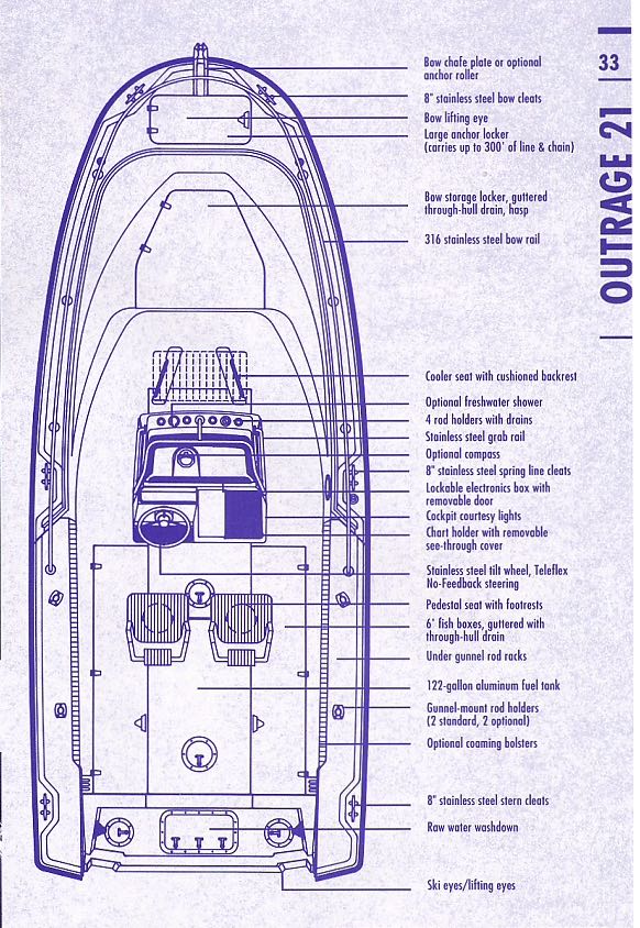

Many Outrage and Conquest models in the 1990's through today have an inspection hatch and access ports in the floor of the splashwell. Over many years of exposure to salt water and the elements, the gasket can wear and not maintain a seal.
The 1998 Outrage 21 has three hatches in the splashwell as do the Outrage 23, Outrage 24 and Outrage 26. Their Conquest cousins did as well.
I worked with several Outrage/Conquest owners from Australia recently to find a solution to their leaking hatches. After much searching and contacting vendors, it was decided to replace the large inspection hatches with locally available ones. Shipping from the US was too time consuming, and expensive.
O-rings for the round hatches can be made up using rubber O-ring material.
Replacing the entire hatch is not terribly difficult and can be done DIY at a slip.

Sorry for the poor description, but [what was trying to be described was] the hatch in the floor of the splash well, right in front of the transom. Thanks Phil T.
