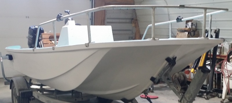

I believe I have a 1963 16-foot Boston Whaler. I purchased the boat from the Canadian Coast Guard, Prince Rupert BC. I am told the boat was used, and abused by Canadian Fisheries.
The hull has been modified over the years with a newer seat and console, home-built rail, and windshield. A Yamaha 90 HP was the last engine fitted . The work was done poorly perhaps by a butcher. Someone drilled a 4-inch-hole in the splash well, scooped out a bunch of foam to fits some motor mount bolts, then glued an aluminum plate as a cover. The foam inside was wet when I felt it, and I sucked some water from atop the foam inside.

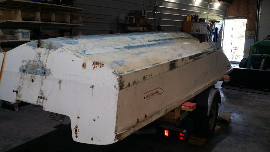

After removing the seat, console, all the screws, and so on, I flipped over the boat onto some plank stands supported by the boat trailer. I tilted the trailer up and fitted a vacuum to the 4-inch now-upside-down hole in the splash well. I got no moisture out.
Fig. 1. The c.1962 16-foot hull inverted for drying.
upside down small.jpg (74.88 KiB) Viewed 76674 times

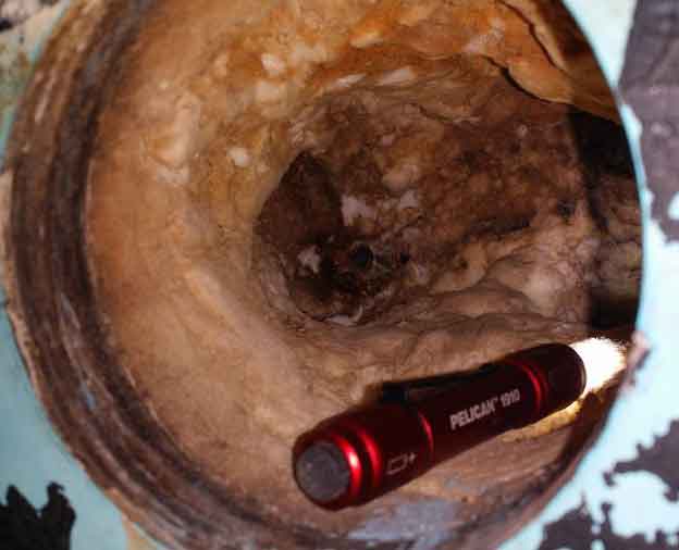

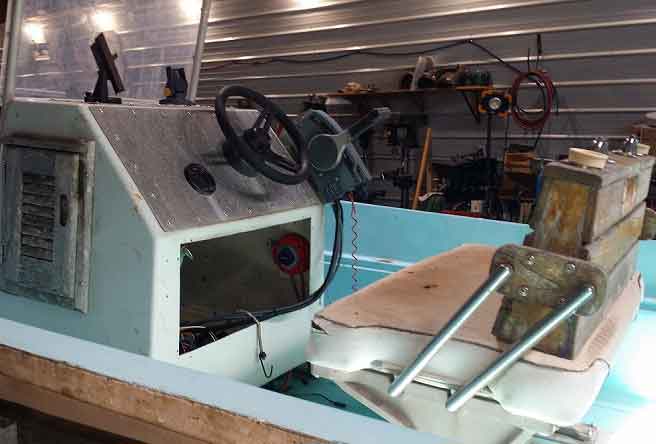

Fig. 2. The large hole drilled to access the lower engine mounting bolts.
hole in hull super small.jpg (68.51 KiB) Viewed 76674 times
Using two bathroom scales and some hydraulic jacks, I weighed one-half of the hull by lifting the two jacks so the supports were coming off the boat trailer. I did three trials with different weights front and back but the totals were all similar, about 310-lbs on average for a half-hull weight. I guestimate the hull at 580-lbs with the support planks subtracted.
The hull looks sound with lots of use but worth bringing back from the edge. My intention is to sand down and re-gel-coat the bottom. I will be seeking advice as i move forward with additional posts. I am thinking to plug the holes with large plywood cut plugs, filling the cavity with 2-lbs-density closed cell foam, and patching the cut hole in the splash well. The foam must be applied in the correct conditions but should be very similar to the original.
Q1: Is the estimate of hull weight at 580-lbs compared to 500 to 550-lbs a concern?

A1: I don't think the hull weight is a concern. In 2019 to know the exact original weight of a 1963 Boston Whaler boat at the time it was molded is impossible. If the boat has gained some weight, there is not much that can be done, short of taking extensive steps to dry out the interior foam. A weight gain of 50 to 80-lbs does not seem alarming to me.

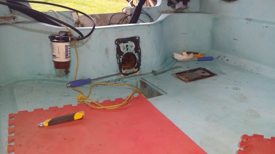

Regarding the large hole made through the engine splash well as seen in Figure 2: you should let the transom area dry thoroughly. I cannot imagine the purpose of that hole. There must have been a very odd installation of the engine. When the exposed hull material is dry, make a proper repair.

Re the boat weight and its static trim: in Figure 1 I can see the remnant anti-fouling paint, which I infer represents the boat's static waterline. I compare this boat's static waterline with the suggested waterline for this hull in the owner's manual. See
Owner's Manual 9 to 17=foot Models
http://continuouswave.com/whaler/refere ... tml#bottom
In the diagram provided by the factory, the water line at the transom is suggested to be from "chine to chine." On that basis, it appears the hull has been sitting with a down-by-the-stern trim. Or, perhaps, the bottom paint was applied generously higher than necessary. If the Yamaha 90 was a four-stroke-power-cycle model, the engine weight may have been higher than anticipated in 1963.
Fig. 3.
stearn bolt view small.jpg (77.41 KiB) Viewed 76652 times
I removed two lower bolts from inside the 4 inch hole where the foam was removed . I found a bolt hole template in an archive post regarding mounting motors but have not looked too close at that aspect.

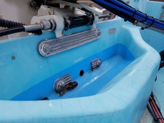

Here is a photo of the natural "chine to chine" waterline of a 1966 16' Boston Whaler.
Fig. 4. View of stern showing waterline.
1966 16 whaler waterline.jpg (63.39 KiB) Viewed 76611 times
It is not uncommon to bottom paint a waterline quite a bit higher then the water level if you keep a boat in the water for the season on the Toms River. The water is described as brackish and has quite a bit of tannins in it from leaf/organic material decay. It is naturally brown and will cause quite a bit of hull staining well above the waterline.
Install a much heavier engine and add a manual jackplate and the transom will sit a few inches lower then what my photo depicts.

Fig. 6. View of the stern showing position of engine mounting bolt holes and the unusual notch that has been cut into the transom.
The notch is 1-inch deep, and the upper engine mount bolts are 4-inches from the top of the original top and 3-inches from the top of the notch. The exterior portion for the notch has a gel coat surface so I suspect this mod was done long ago.
The modification may have been done 50-years ago or at least prior to the last outboard installation. I assume they wore out a Yamaha 90, the last engine, and the boat was removed from service at that point.

Of bigger concern to me are the two through holes below the splash well into the cavity of scooped out foam, that had bolts to attach the last outboard or perhaps a jack plate. I have probed the holes with a needle and one appears well sealed with possible resin, very hard, one hole has a spot where the needle can penetrate say 1/8-inch. I may drill this hole larger, say another 1/4-inch, to assess the inside edges of the hole.
The back side of these two holes expose wood within the cavity where the bolt heads and washers mate with the inside surface. Those surfaces appear solid but I will probe more careful to make sure there is no hidden damage.
This leads me to the [fifth and sixth] question:
Q5: Should I even consider using these engine mounting holes again since they are already there?
Q6: Should I drill them larger then reseal with resin and drill them to fit new mounting bolts?
Q7: Or should I fill the holes and drill new ones above the splash well as described in the how to mount engine to transom posts?
I originally thought to fill the foam cavity and patch the 4-inch access hole. I consider the foam an important part of the structural integrity of the boat and transom. I think patching and filling makes the most sense and to get rid of the lower holes
Q8: Or alternatively, should I repair the lower holes to ensure wood is well sealed with resin, weld tabs on the bolt heads, place the bolts inside the cavity and tie the heads together so they will not turn, pull them tight to the transom, then fill the cavity with closed-cell two-component foam, patch the 40inch hole leaving the mounting bolts as permanent fixtures, and fit a jack plate for outboard mounting?

Fig. 7. Close-up of hole and cavity.
The wood locating diagram shows the 1-1/4 plywood in the transom as 20 x 37. The inside surface where the two "cavity" bolts were mated to looks to be fiberglass.
Q9: Would [Boston Whaler] have wrapped the [embedded] plywood in fiberglass when they made the boat? (See Figure 7.)
I am worried about water ingress from these bolts into the plywood. I would like to drill out the holes and inspect before I patch them.
Q10: How big can I drill out [the engine mounting] holes [in the transom for inspection]?
Was thinking of a temporary dowel plug with a pilot hole drilled through the center. Glue in place and let set, then, using a Forstner bit, drill the hole bigger using the pilot hole in the dowel as the center. I might be able to stop at the inner fiberglass surface. That method should leave a clean hole for the plywood plug.

A10: to fill larger holes in the transom a dowel rod should not be used. Cut plugs from similar plywood stock. The transom wood will tend to be in compression, and a plug made from a dowel will have the wood grain oriented differently than the rest of the transom.
Your concern about ingress of water into the interior of the transom and the wood due to leaking at the engine mounting bolts is a proper concern.
One method to insure a water-tight mounting: drill the mounting bolt holes to be slightly larger than necessary. Use epoxy resin to coat the inside of the mounting holes. Then re-drill the holes to the proper, smaller diameter. This method should leave a water-tight epoxy surface throughout the mounting hole. Use proper sealant on the bolts, in any case.
Also, I recommend you use epoxy resin as the adhesive in making repairs. Epoxy is a much stronger adhesive than polyester resin. In making secondary bonds between already cured portions of the original laminate, epoxy resin will make a stronger bond. Polyester resin is mostly used in making the initial primary bonds, when all elements are wet and are in the process of curing.

For the large hole in the engine well interior side of the boat it looks to be about 4 inches in diameter or so. You have 1 inch of plywood behind the fiberglass skin of the interior shell of the boat.
I would cut say an additional 1 inch of fiberglass off around the hole to expose the plywood beneath. Then I would cut 1/2 inch wide by 1/2 inch deep section of the plywood around the hole. What you will be left with is a plywood hole that is 4 inches by 1/2 inch deep.
This is a method that I have used to fix sheetrock. Use a piece of half inch plywood that is longer than the hole by about 2 inches on each side of the hole but not so wide that it will not fit completely into the hole. Glue the wood to the "back" of the repair. Glue a 4 inch by 1/2 inch plug of plywood to the backing strip. Then glue a 5 inch by 1/2 inch plug of plywood on top of that.
Now you have the plywood portion of the hole filled with plywood and it is flush with the already embedded plywood. The layers of the plywood are stepped to prevent the plug from moving in the smooth 4 inch hole.
Sand the fiberglass around the plug back around two inches to taper/bevel the fiberglass around the now plywood filled hole. Now you can build layers of fiberglass mat and resin over the top of the plug as necessary. Start with a smaller diameter piece of cloth say equal to the 5 inch plywood plug and increase the size by about 1/2 inch or for each additional layer of glass. Build it up to the height needed and you have what I would consider a pretty tight repair that should not require a good deal of filling with fairing compound or the like.
I agree with the epoxy resin for laminating the wood and the fiberglass mat.
For some of the smaller holes in the transom I added some West System 406 Colloidal Silica to the mixed resin to give it some body. Just cleaned the holes a bit and filled them. When you are gluing the plywood a bit of thickened epoxy resin works well to prevent the epoxy from migrating from the repair area and then straight epoxy resin to wet out the cloth. I used the thickened epoxy mix to do as Jim recommends with bolt holes. Straight epoxy/thickened epoxy your choice they will both work. The epoxy thickened a bit stays put a bit better for me.

I hate the notch. Yes I have taken a particular disliking for the notch. It screws up the mounting options big time. even for a jack plate. mounting holes are 3 inches down from the notch and 4 inches from the original top. The temple calls for less than two inches from the original top.
I have no experience with fiberglass repair but circumstances are giving me some desire to learn.
The wood locating diagram says the transom wood is roughly 37 x 20-inches.
Q11: Can a section of [the wood reinforcement in the transom] be replaced?
Q12: Can the whole piece [of plywood that reinforces the transom be replaced]?
Q13: Can a dowel [be inserted] in a small piece and fill the gap?
Q14: Given that the mounting holes will be less than an inch from the old notch gap, should a wider piece [of wood reinforcement than the original size] be installed?
Q15: Should the old plywood reinforcement be cut out entirely and replaced?
Q16: Should a fiberglass section along the bottom be left to tie into and the old plywood chipped out?

As RTK (Rich) has already described in detail, a good method for installing new segments of plywood reinforcement into the Unibond hull of a Boston Whaler boat is to avoid butt-joints of the wood and instead to use overlapping joints. You should read the information at INSTRUCTIONS--HULL PATCH KIT (that I mentioned in my first reply); that article shows how new materials being added to a Unibond hull in repairs should be feathered and tapered into the original hull materials. The words "INSTRUCTIONS--HULL PATCH KIT" above are hypertext and will take you to the information.
If adding a new section of reinforcement wood at the top, I think making that section wider than the original may add strength to the top of the transom.
If the plywood reinforcement in the transom is in good condition, has not become soft, does not have rot, and appears to be strong, I would not replace the entire piece. I think you have not yet determined the condition of the wood.

Good point by jimh- I was thinking more about the location of the top bolt holes. It's odd that they drilled them so far down from the top of the transom. Makes me wonder a bit about the condition of the plywood between the bolt holes and the top of the transom.
Maybe it would be worthwhile to talk to a local metal fabricator to see how much it would cost to build an aluminum sleeve to cap the gap at the top of the transom. Extend the aluminum down far enough on both sides of the transom, glue it in and then drill new bolt holes in a more standard location.
The original bottom bolt hole location in the splash well can be used but I think you have to move the bolt location "in" toward the center of the transom around 3/4 inches. The distance between the bottom bolt holes in the BIA standard is 9 and 7/8ths of an inch on center according to the template I made.
Rebuilding the transom to raise the notch an inch is a major fiberglass fabrication job. A good familiarity and understanding of the repair process and working with the materials is necessary. Maintaining the structural integrity while replacing the plywood and fiberglass takes a good bit of skill and understanding of the structural build up of materials. Sometimes by taking away large areas of original fiberglass and plywood to fix and area may actually damage the overall integrity of the laminated structure.

Thanks tp Rich and Jimh. My investigation shows the transom is solid. I am back to leaving the notch and just using a jack plate as advised in the earlier post.
I might even name the boat "the notch".
I will likely just start sanding the bottom prepping to spray new gel coat. Looks like I will have some minor repairs along the way. My goal is to have the boat functional by spring: new gel coat and some minor repairs. Not a full blown restoration but a tidy up.
I will keep the console and perhaps buy a [top-mount remote engine throttle and shift control] to clean up the console look.
I will re-cover the seat, sand down and oil the teak.
I need to buy an engine sometime before spring. I have my eye on a YAMAHA 90 or a TOHATSU 70 or the new YAMAHA F70. I like the slow troll capabilities of the F70, the price of the used TOHATSU, and the power-too-weight ratio of the Yamaha 90.

I ripped a few strips of hardwood, then glued some sandpaper to the strips with contact cement and started sanding, using the strips to get at the vent ribs on the console door.
[The boat has now been identified as made in 1970] but the console and reversible pilot seat look newer than what would have been original.
There is not much left of the newer console except the side door.
Sometime I need some visible progress to cheer my spirits; WATCO teak oil brightens my day.
Fig. 8. Console door as it was.
Fig. 9. Door with WATCO Teak Oil
Fig. 10. Seat and console as they were.

I have never heard of Vance Manufacturing but it looks very similar to the CMC. The price is great! Looks like that would work very well for your purpose.
Nice work on the teak- it is good to take a break from the endless and terrible tasks of sanding and grinding the boat and do something different- especially something that you can finish in short order like that. It is good for morale to check something off the list when doing a large project.

WATCO teak oil is the product I have been using on my boat's teak. As with any oil, it needs continual refreshing.

The boat is pretty much sanded down, all the topside and bottom paint removed. Still some hand sanding along the chines and difficult to access areas. Generally looking pretty good . Dusty process for sure. Used Vaseline on the mask to seal the beard and though it was uncomfortable it sealed the mask
I have removed the old through hull drain tube. The knurl at the outside surface did not bend in but basically fall apart. I used an old broom handle as a dowel to fit in the drain tube, then drilled a 7/16 hole in the center of the dowel and pushed a bolt and washer into the hole. The washer was just the right size to meet the brass around the dowel and the bolt held the washer centered on the dowel . I pushed the draintube out into the boat , tapping the end of the bolt with a hammer and piece of the broom handle. Worked a charm
Q19: when I replace the drain tube do I use a sealant adhesive like 3M 05206 Marine Adhesive?
Q20: what sealant is recommended?
Q21: are there any tricks to sealing the end with the flaring tool?
The transom end has a bit of a slope with the bottom closest to the boat surface and the top a little further away from the vertical. That is, if you look at the boat from the side the stern is not 90-degrees but slopes out a bit further at the top.

That I got out this tube was lucky; the tube was falling apart.
Fig. 11. Drain tube, apparently attached to a rod used to remove it.
I was amazed the transom wood looked so good. The foam felt wet, but the moisture didn't seem to absorb in. The foam is very firm and dried out well.
Fig. 12. Attachment of a vacuum hose to the hull. The picture has been rotated 180-degrees. The hull was upside-down during vacuuming.
I never did get any moisture out of the back of the transom even with a vacuum attached to the hole in the splash well. Note with the boat upside down the drain tube is directly above the cavity where the vacuum was attached. I ran the vacuum on and off for several days but never felt any moisture when I checked.

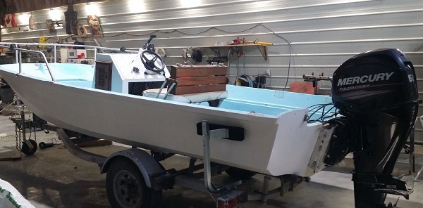

The 1970 hull has been rescued and will float again soon. There were some delays dues to the stay at home orders but it is ready am taking the boat to the lake.
  • New drain tubes,
  • did some fiberglass shim flattening for the Lance Engineering Jack plate,
  • painted the hull,
  • found a good used Mercury 60 HP FOURSTROKE,
  • painted the console
  • left the inside pretty much as it was,
  • put the old railing back on for now.
Fig. 13. Please write a caption for this image.
After small.jpg (76.29 KiB) Viewed 45734 times
Fig. 14. Please write a caption for this image.
After 2 crop.jpg (81.71 KiB) Viewed 45734 times
I did mount a binnacle control, which I will change next winter when I will do a little work on the inside
I found some red dots in the gelcoat by the logo--that makes sense [because the boat was previously] owned by the Canadian coat guard, and explains the extra weight I was concerned about. I would like to get [the hull] on a good scale and get a bit more accurate [weight].
What are the Boston Whaler specifications for "red dot" hulls?
The seat needs recovering and [there are] are many interior scars to fix, but that will happen later after some fishing is done.
Thanks to all for the great advice. I learned a great deal.
First time owner, long time admirer , 1970 (not 1963) 16 foot model being restored to a functional fishing platform

Postby biggiefl » Mon Jun 29, 2020 10:14 am
How are you going to install a rubrail with that bow rail?
Why would you remove the binnacle-mount {or top-mount] control?
Center consoles use binnacle-mount [or top-mount] controls for the most part. You can modify a side mount but that is incorrect.

I am not going to install a rub rail in 2020. I have run out of time and plans have changed. There are supply chain problems and borders closed. I tried to just get the hull in reasonable shape, mount the jack plate and engine, refill the foam, and patch the hole in the splash well.
The existing [rub] rail may be utilized, but that decision has not been made.
I did not remove the binnacle-mount or top-mount control. The previous owner made some modifications. I did not like the way he ran the cables into the front of the console, so I purchased an aftermarket binnacle-mount [or top-mount control]. I am not happy with the installation yet.
The placement of the steering wheel is also a bit of an obstacle.
The placement of the windshield is another obstacle.
Fig. 15. Another new image without any caption. When adding images please write captions for them. Images without captions lose meaning.
The boat was not a great candidate for a full restoration. I just wanted a good fishing boat and that is what [this boat] will be: a non-original workboat with plenty of scars.
I would like to know [more information] about red dot hulls.
Re: 1963 16-footer Project
Postby biggiefl » Tue Jun 30, 2020 9:21 am
Got it!
I would make a new face for the console and move the wheel and then mount the binnacle(or top mount) control next to it along with a safety lanyard.

Postby Rick W » Tue Jun 30, 2020 2:01 pm
Agreed my thoughts exactly. The existing steering wants to be over to the starboard side to make room for the cable to loop to the side and down into the tunnel. I am not too familiar with my options to change that. Ideally I would like the binnacle next to the steering wheel on the new face.
I am looking at Speciality Marine out of Oceanside,California, for windshield and console grab rail. Seems like the package size would be reasonable for shipping. The bow rail is another story, hard to ship. The mounting hardware is much easier. I might experiment with a tube bender and my mig welder to see if I could fabricate a bow rail that would not interfere with the rub rail.
