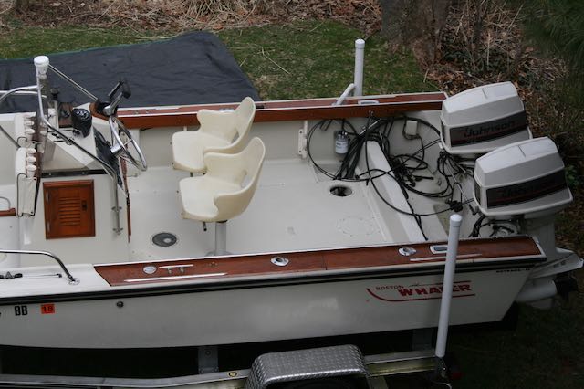

Got it thanks Phil. I'm looking to confirm the exact location of the midship cleat mounted on the 18 wood [gunwale--we use the Boston Whaler spelling--Moderator]. I want to keep the boat factory correct.
A photo would help.

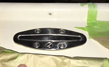

Here is a photo just sent to me by CON.
Fig. 2. A midship cleat on an OUTRAGE 18
Here is a [link to a] photo of an Outrage 18 with fiberglass gunwales and the cleat:
http://i22.photobucket.com/albums/b309/elaelap/surprisesalmon001.jpg
Note: this image cannot be made in-line without intention blurring by the host website--Moderator]

PHIL--Great. Thanks. The thread you shared was Interesting.
Yes, the OEM [Wilcox, Crittenten & Co.] Marinium cleats are impossible to find. That is why I was just planning to use some other 8-inch cleats.

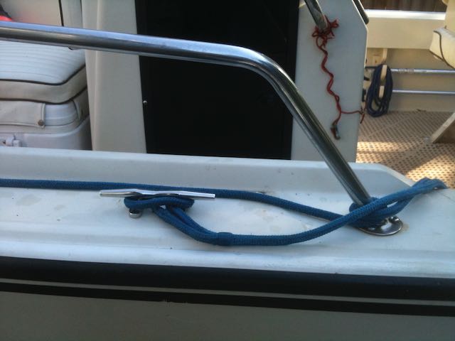

Fig. 3. Midship cleat location on an Maine boat.
I found a photo of my Maine boat that works. Seeing [the photo] now, I think [the cleats seen in the photo] are aftermarket. The strakes are longer and shaped a little differently. and the cleat doesn't look like aluminum.
I think I'm going to mount mine right behind the fuel filler.

Is the boat identified as the "Maine boat" also an OUTRAGE 18?
Are the midship cleats seen in Figures 2 and 3 supposed to be interpreted as having been installed at the factory?
I don't think these details are made clear in the narratives. And the cleats are in different positions.

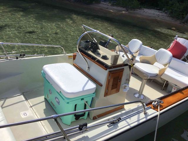

We're in the process of moving the two 4.5" popups that were mounted twenty years ago up forward on the deck of our 1973 21' Outrage to mid ship for spring and fender lines. In their place are to 6" popups and another set in the stern, replacing a pair of 8" (I think) oversized cleats.
Fig. 4. An ACCONMARINE 4.5-inch pop-up cleat as installed on 1973 21 OUTRAGE gunwale as a midship cleat.
A disadvantage of model is having to place a plastic shell underneath, and route drain tubes. The forward cleats will drain into the anchor locker, sterns into her bilge. The midships have been plumbed to drain overboard, just above the rubrail.
Fig. 5. Drain hole for 4.5-inch cleat above the very low rub rail on a 1973 21 OUTRAGE.

jimh wrote:Is the boat identified as the "Maine boat" also an OUTRAGE 18?
Yes, that's an Outrage 18.
No, I don't think [the cleats seen in Figure 3 are from the] factory. They are not Marinium and the strakes are longer.
