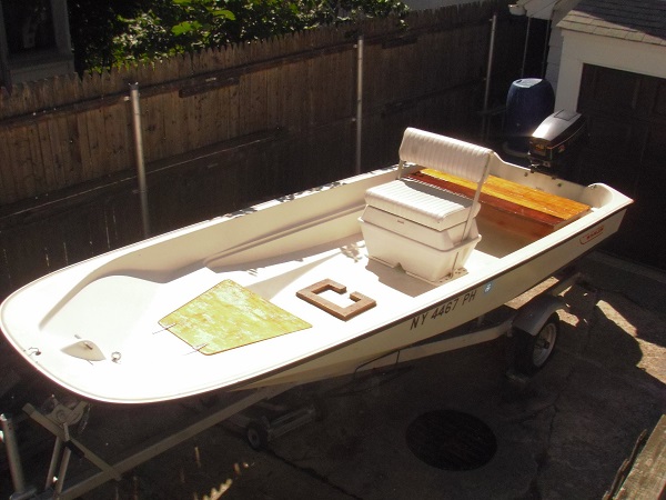

I was in a similar situation with my 15 footer. I fastened a mahogany frame to the deck with screws and adhesives, making sure to waterproof and seal the screw holes.
Then I bolted a TODD center console to the frame.
The console can be removed by just unbolting it [from the frame].
Rigging cables and wiring are concealed under a length of extruded aluminum door threshold. The wiring cover is not in the way of my feet when at the console. At first I was annoyed by it then I got accustomed and I don't even notice it now.
Also, I used a cooler seat with a tilting seat back.

The cooler seat was attached the same way. That way I can remove either without disturbing the fiberglass deck. The mahogany wood bench seen in Figure 1 can be raised to access a storage compartment. I store two 6-gallon portable gasoline fuel tanks under it. I have two swivel seats mounted on it now.
Although not seen in Figure 2, the console is attached to the frame with double-ended stainless steel screws or "studs." One end is threaded for self-tapping into wood; the other end is threaded as a machine screw. Also not seen in Figure 2 are the stainless nuts and fender washers that are used on the machine screw studs to secure the console to the wooden frame.
The aluminum door threshold is meant to be stepped on and is strong. In Figure 3 the plywood base attached to the deck for the cooler seat to bolt to is partially visible.
Last edited by Oldslowandugly on Sun Apr 24, 2022 3:42 pm, edited 2 times in total.

The 13 footer is smaller but a small console like the TODD console seen in Figure 4 should fit well.
My biggest complaint about Boston Whaler boats is that the factory seating and console waste too much space.
The folding bench stores the gasoline fuel tanks and provides for more seating at the stern.
I also added a swivel seat forward of the console.
A battery and flares are stored underneath the folding mount. I maximized the available space as much as I could.
The deck of my boat was in bad condition, so I did not want to make a tunnel. In fig 3 you can see that the area in the center of the cooler seat mount is exposed but safe under the seat. The door threshold is only used between the seat and console, and the seat and rear bench. That protects the cables and wiring from clumsy feet. The PCV pipe has my wiring inside for extra protection. I have had to make wiring changes and having it accessible under the aluminum cover made that task easy.
Last edited by Oldslowandugly on Sun Apr 24, 2022 4:00 pm, edited 1 time in total.
