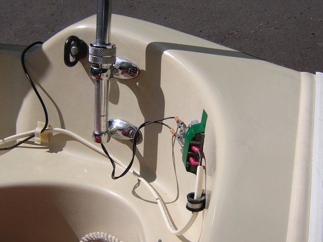

White All-round pole lamp location: Starboard side of transom inside wall, ~ 50 mm to the right transom eye. The top of the knurled nut is level with the threaded rod.
Fig. 1.

On my 1976 SPORT 15 the pole lamp for the White All-Round light was mounted on port. The required navigation lighting rules do not specify a particular side of the boat for the lamp location.
Fig. 2. The two-piece mount for a pole lamp on a 1976 SPORT 15, located on the port side of the transom.
The distance away from the transom eye can be gauged by the illustration. Note that because the transom interior face begins to curve around to meet the hull side interior wall, and because the mounting base needs a flat surface, the lamp position cannot move very far outboard because of the curve radius increasing as you go farther away from the transom. If you look very closely at Figure 1, there is a washer used to shim the lower mounting brackets so its alignment with the top mounting bracket is better.
The decision on Port or Starboard will be made based on where the hidden wiring from the combined sidelight bi-color lamp exits through the cockpit wall. If that wiring is on the Starboard side, the White All-round pole lamp should go on Starboard. If that wiring is on Port, the pole lamp usually would be on Port.
