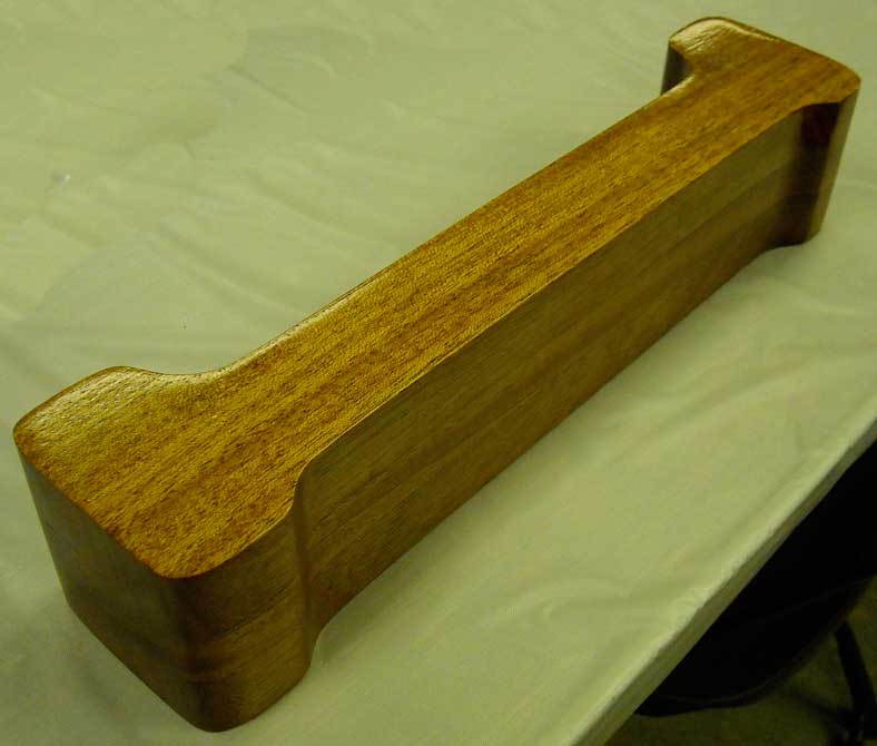

A riser for a Reversible Pilot Seat can take many forms. Here is one being made by Nautical Lumber:
Of all the RPS seat risers and console risers I have seen, the ones I like the most were made by Jerry ( aka Spouter) for his OUTRAGE 22. Jerry adds a bit of slope to the contour of the risers which is more appealing than the rather blunt ones often seen. See below:
Jerry is a professional painter and an excellent craftsman. The wood details and varnish on his boat are second to none.

Thank you Jim for the additional photos- that is a very nice job Jerry did. I'm only 5'10" tall but I am most comfortable, and my lower back is happiest, standing as straight up as possible when running the boat. All of the suggestions and photos are very helpful. --Rich
