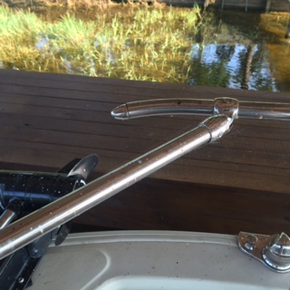

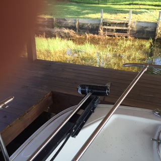

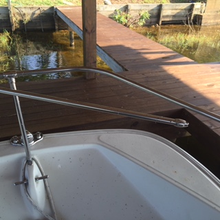

Here are some photos of a front mount trolling motor on my 1988 Montauk 17. The front rail unscrews and swings back to allow the motor to be placed in the water.
- image.jpeg (57.32 KiB) Viewed 10777 times
- image.jpeg (60.78 KiB) Viewed 10777 times
- image.jpeg (58.76 KiB) Viewed 10777 times
