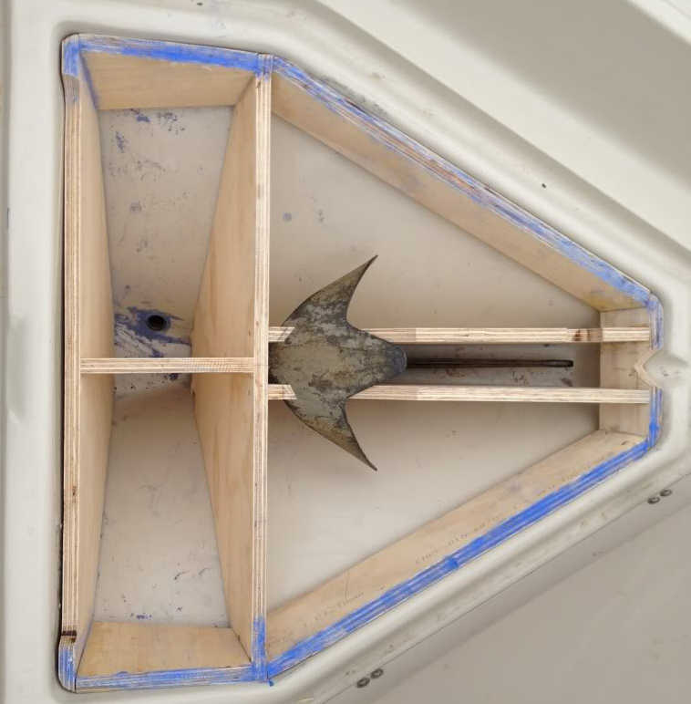

Postby jimh » Sun Jan 06, 2019 3:52 pm
Here is an overhead view from an image posted to an earlier discussion which shows the anchor locker drain inlet location:
Fig. 1. Overhead view of an anchor locker from a Boston Whaler OUTRAGE 18 showing the location of the drain inlet.
