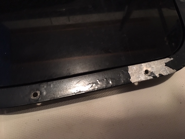

The [aluminum frames surrounding the] black console hatches have seen better days. I want to repaint them and have it last. Give me your thoughts on the correct way to do this.

The KRYLON brand of spray paint in aerosol cans would be a good choice for repainting the frames, if they are aluminum as the seem to appear in Fig. 1.

The pic you posted of the "paint" flaking looks more like powercoat and once powercoat starts flaking, it's difficult to get it to stop. My preference is to remove it and either have it powercoated again or prep for paint, which paint for aluminum take several steps.

Looks great. Don’t have access to a blaster so I am stuck with using other means. I bought some aircraft paint remover. Now i must wait until it is warm enough for me to paint. I an getting six to eight inchoes of snow right now. Ugh. C’mon spring.
