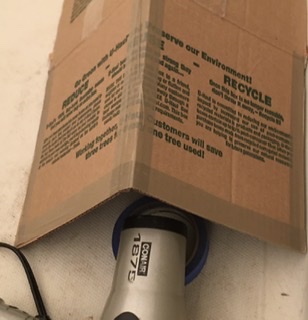

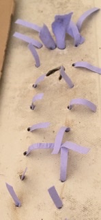

I cleaned out the holes and shoved strips of ShamWow in each.
I made a tee-pee of cardboard over the top, and placed a hairdryer on low heat at one end. Water is sucked out and evaporated via the strips. Totally nuts.

Thanks for the realization that getting all the water out of one of these hulls after some has gotten in (for what ever reason) is virtually impossible. To get [this 1981 13-footer] totally dry without ripping out the floor seems impossible.
The Sham Wow methodology did really seem to work. The amount of water soaking into the strips has been greatly reduced from wet to now damp and some holes are dry.
