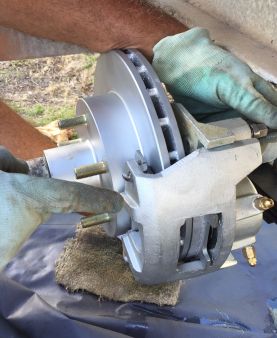

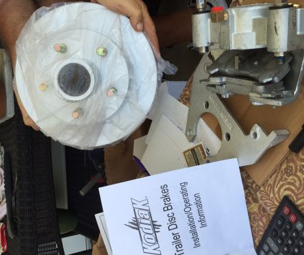

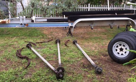

I decided to do a total rebuild of my 1994 Owen and Sons triple axle trailer. The only remaining original part is the aluminum frame. The original configuration was surge drum brakes on two axles. Rebuilding was the way to go after pricing new triple axle trailers of 10,000-lbs-capacity.
I purchased the needed parts from SturdyBuilt Trailer Parts in Florida. and Eastern Marine in Delaware. I chose Kodiak rotors, hubs, and calipers, and choose galvanized axles by Dexter. The bigger decision was the [electric-over-hydraulic] actuator. After reading what I could about them, I chose a Dexter K71-651-00. Some smaller components of the system were Deemaxx brake lines and fittings, an Esco breakaway kit w/battery, and Ancor split loom for all wires and hoses. The 2-5/16in coupler was Titan-brand and the in-cab controller from DrawTite. New 4 leaf double eye springs w/bushings and SS hardware from SturdyBuilt.
When the parts were on-hand, this was a simple and straight forward swap. I put the trailer up on four jackstands and took it apart. Only common hand tools were necessary; I did not have any rusted or frozen fasteners. The [electric-over-hydraulic] actuator from Dexter uses only four wires. I used a four-inch-square weather-proof electrical box to house my connections for trailer lights, [electric actuator], and breakaway switch to the 7-pin trailer cable and connector.
Bleeding the brakes for six calipers was the easiest part of the job. No helper is needed, you pull out the breakaway switch,which turns on the actuator and bleed from the most distant caliper toward the front. There does not seem to be any color standard for trailer wiring to [electric-over-hydraulic] and tow coupler so I jotted a few notes. Some wiring diagrams for the 7 pin connector are facing it and some from the rear.
On the road the the six disc brakes of the trailer easily stop the truck and trailer when applied from the in-cab controller.
New bunks, carpet, fenders, pipe lights are simple. I put on new tires and added a spare. In hindsight I probably should have changed to 15-inch wheels from 14-inch wheels, if I had thought of it. I will see if there are any pictures around.

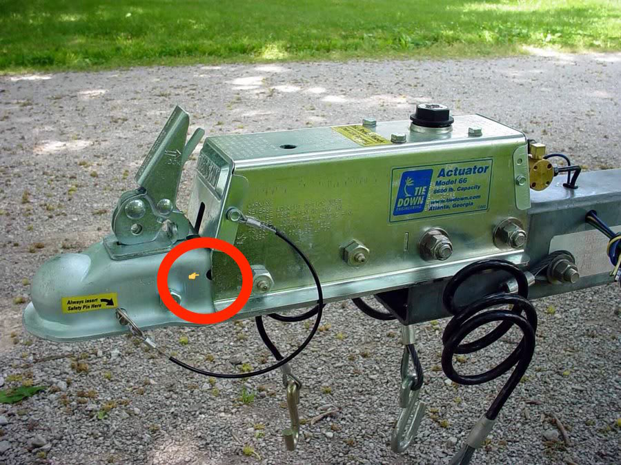

My 17 Outrage trailer has disc brakes with a surge coupler. Backing into my driveway is a chore. If I don't get out and pin the coupler, I cannot back up my steep driveway. Not all couplers come with the reverse lockout solenoid.
The picture shows where the pin would go to lock out the master cylinder. The pin just prevents the forward part from sliding in and actuating the master cylinder.
I also have a fairly steep hill on the route to my ramp. I'll sometimes get excessive braking from the trailer going down that hill.
