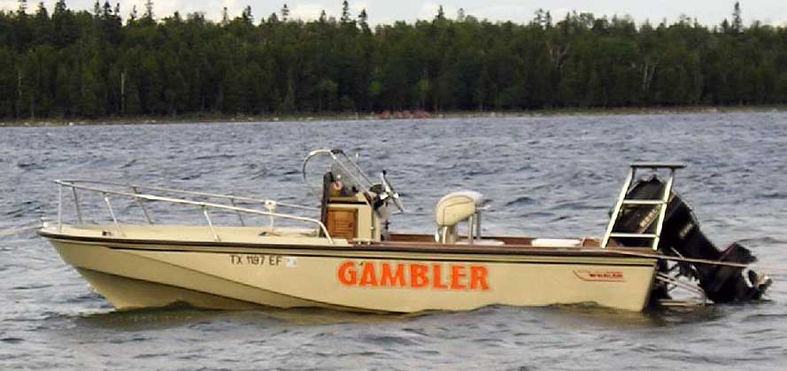

Regarding sighting of Boston Whaler boats with a poling platform over the engine, only one boat comes to mind: the somewhat famous GAMBLER of Dave Buckda. When Dave bought the boat it had been in use for some sort of sponsored and I assume competitive angling, and the boat's name reflected the sponsor, Gambler Lures. The boat also had a poling platform over the engine when it arrived in Michigan from Texas.
Fig. 1. GAMBLER an OUTRAGE 18, in an early form, still with single engine and poling platform, but now far away from Texas and in northern Lake Huron. Photo by Dave Buckda.
The orange decals on the hull sides were removed, but the name stuck: GAMBLER.
I recall that Dave once used the poling platform as a diving platform for making an athletic entry into the waters of Parry Sound on one of the many trips we took together. When the boat was re-powered with twin engines, the poling platform on the transom was removed.
