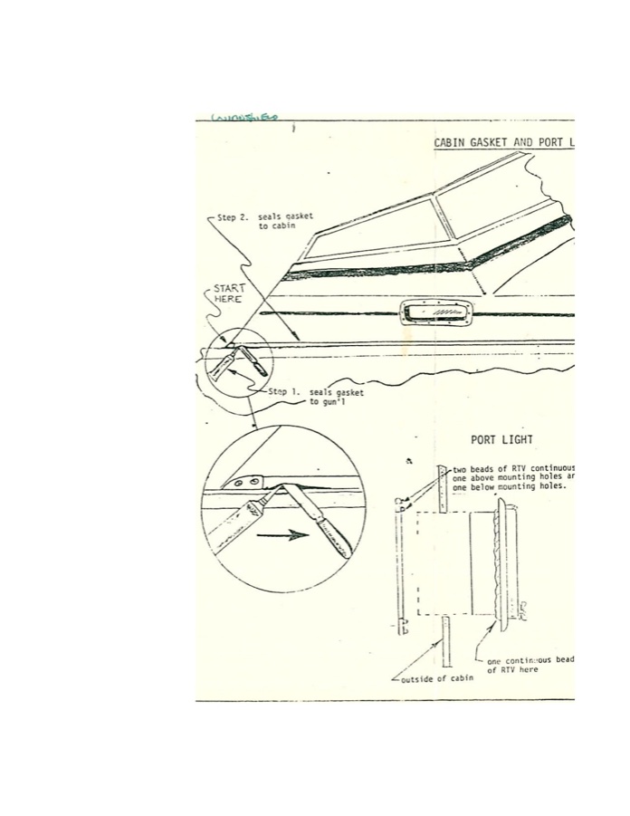

Postby Phil T » Thu Apr 08, 2021 7:40 pm
I reached out to Don offline and he provided the factory instructions.
While it is a .pdf I saved it as a jpeg so it can be uploaded here.
Cuddy leak repair.jpg (83.03 KiB) Viewed 3310 times
