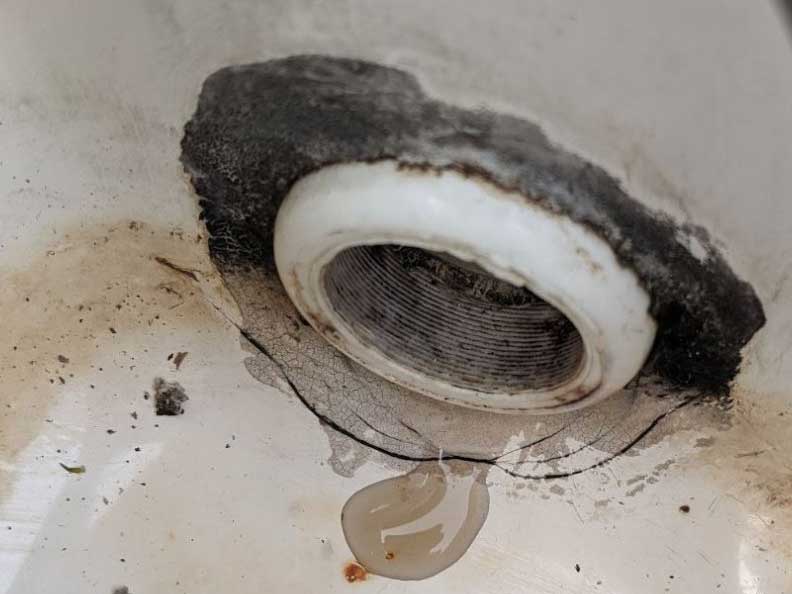

Figure 1. Water is seeping from around the lower part of the drain tube after being wiped dry.
Re: Drain tube leak, OK to use temporarily?
Postby Phil T » Sat Apr 17, 2021 7:21 pm
Sorry, don't use the boat.
Remove the drain and all the sealant.
Inspect the hole for rot.
Use paper towels to wick as much moisture as possible.
Use a hairdryer on low for a day to dry it out.
Coat the walls of the hole with marine sealant (Boat Life) not adhesive.
Install new drain with sealant. Use the threaded type, not the snap in.

As best I can tell, the leak occurs around the tube on the lower side of the drain.
The boat gets year round use. My guess is the constant in and out of the drain plug must have dislodged the gasket formed by the 5200 around the tube.
I'm handy but not a pro by a long shot. I think I should look for whatever solution has the best chance for success for someone who hasn't done this much.

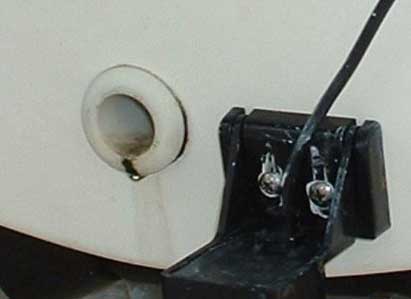

In all honesty I don't remember the condition of the original drain tube. From memory, I think there was some sort of sealant visible around the edges of the drain tube and it was deteriorating allowing the drain tube to become loose, which was why I replaced it. If I remember correctly. But I do not remember anything about what was inside the hull or how the drain tube came apart. I dug through some old pictures and this is the only one I saw with a clear view of the original drain tube, the picture is from 2003 and I cropped it to show just the drain area.

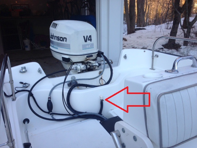

Fig. 2. Transom drain outboard end.
This does bring up another thought; the bilge pump tube that goes from inside the boat to inside the splash well; is there any way that could be leaking inside the hull? I wonder if the increased pressure from the new pump is actually pushing water into the foam area of the transom, and that water is trickling down inside the hull and running out around the lower drain tube?

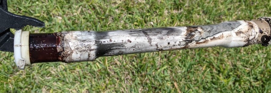

Q17: what is the outside diameter of the drain tube?
I haven't removed mine yet for fear that it won't come out in one piece, leaving me with nothing to put back and the hull open to the rain.
Also I looked at it with my son and we've come to the conclusion that inserting and removing our expansion style drain plug must have flexed the plastic and weakened the seal over the years, leading to eventual failure.
I keep a quart of the West System epoxy and the little can of hardener around, it's great for the occasional odd job. If you use their pump system, one pump of resin gets 1 pump of hardener so it's really easy to measure out and mix. The hardener turned a dark brown after a few years in the garage, but still seems to work just fine.

Thank you very much for the info. I don't think this particular drain tube has any indentations in it to fit a special tool, and it would be very difficult to access on the inside of the boat anyway. So this might be a fun one to remove. ;)
I have used Skiaflex products on my house, you can sometimes find them buried in the pro level stuff at Home Depot. They are very high end and work really well in that application, I would assume any marine products they make should be of similar quality.

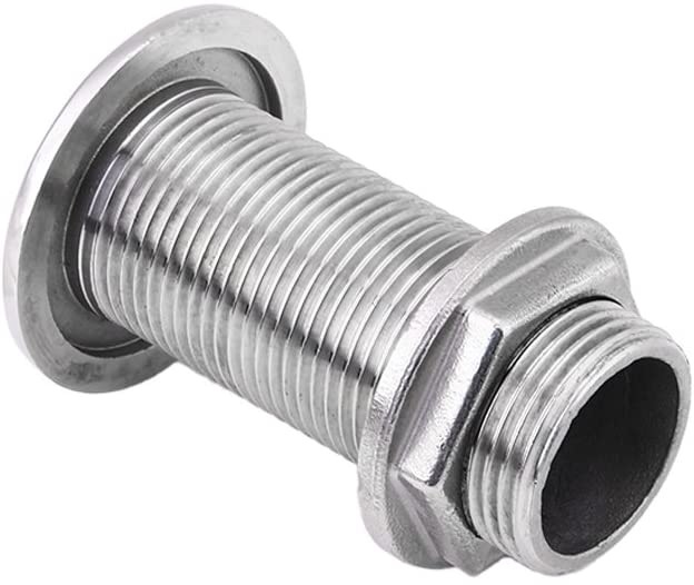

I'm trying to find a threaded metal through hull, thinking it might hold up better to the repeated insertion and removal of the drain plug. What do you guys think about this style of through hull, assuming I can find one the right size:
Fig. 3. A metal drain tube assembly, not the OEM nor the replacement part that will be used.

I think the metal through hulls are better. I could never find a size close enough to make work.
Q18: Isn’t the Montauk sump drain quite long?
Con
1969 13 / 30hp Johnson tiller

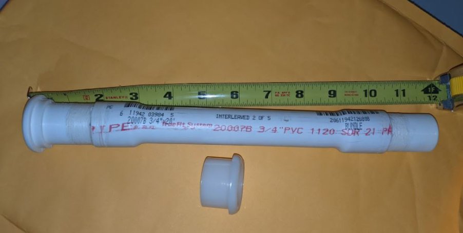

MattFL
Posts: 58
Joined: Wed May 09, 2018 2:58 pm
Re: 1996 MONTAUK 17: Leak at cockpit sump drain
Postby MattFL » Tue Apr 20, 2021 5:38 pm
Yes, I just measured it and it's right at 12" long.
Postby Phil T » Tue Apr 20, 2021 6:54 pm
Due to the slope of the transom and the sump wall, you will not get a good fit on the inside or outside.
This is why Boston Whaler used brass flared tubes. They can get a tight fit on the angles.
Postby MattFL » Wed Apr 21, 2021 8:04 am
From memory, I think the plastic tube was not strait, I vaguely recall it had a little bend on one side. I will find out when the new one gets here (not removing the old one until the new one arrives so the hull isn't completely open to any rain).
As best I can tell, the water appears to be coming from under the bottom edge of the drain tube, around the flared part. Much above what appears to be a crack in the gel coat. I will study it carefully when I finally get it apart.

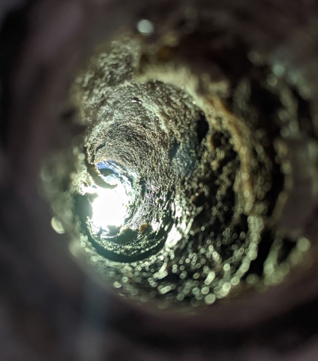

Fig. 4. View of the drain hole passage after existing drain fitting has been removed.
Fig. 5. The old drain tube after removal and still wet.
Fig. 6. The new replacement part for the drain as supplied from Boston Whaler dealer.

Fig. 7. The path of the cockpit sump drain pump exhaust has been routed through the forward bulkhead of the engine splash well, then the water is deflected downward by a partial cover over the outlet.
The boat in Figure 7 is not my boat; my boat is [rigged] exactly the same.
The sump pump is down in the well. A rubber hose connects the pump to a rigid pipe that goes through [a bulkhead at the aft end of the cockpit] and exits into the engine splash well. The fitting that exits into the splash well is covered with a stainless steel deflector that diverts the water downward. It's the same exact effect as holding your thumb on the garden hose to spray the water down.
That flap creates some pressure, and if there is a leak anywhere around the pipe I could imagine it pushing water into the hull. That flap has never been removed so I'm not sure the condition of the sealer between the pipe and the hull. If that seal is falling apart then that could the source of a leak.
I may need to take apart that fitting and look in there.

Install a brass tube with O rings and flared ends and not the abomination of PVC. Yikes.
Also - That bildge setup and fitting installed in the splashwell wall is cringeworthy. The idea is to avoid cutting through the skin into the foam.
Just run the discharge hose along with the steering cable and and add a 90 degree fitting after the drop in the transom wall pointing aft. It works.

I presume that the long assembly seen in Figure 6 is already assembled from three individual components and has been cemented together with a PVC cement. The long assembly appears to be intended to be put into place in the drain hole, then the second component, a sealing ring, will be installed onto the unfinished end once the assembly is in place in the hull.
Q23: Are you going to install the second sealing ring on the inboard end or the outboard end?
Q24: In Figure 5, is the black material seen on the old tube at the left end some sort of lubricant?

I'm thinking the PVC part with the larger flanges might actually seal better than a thin O-ring due to more surface area. The tube gets a lot of abuse with the plug going in and out on every trip, and I think that might actually be what caused the problem, more on that below.

jimh wrote:Q24: In Figure 5, is the black material seen on the old tube at the left end some sort of lubricant?
That dark brown stuff is some sort of biologic film. or mold. or something that grew from the moisture, or maybe some chemicals from the foam or glass that was washed out by the water. It smells bad. The smell reminds me of Florida swamp muck, the sweet rot kind of smell. Maybe fish gut water got into the hull through the leak and it's related to that.

Now that the old tube is out, I can definitively say that the hole in the foam is larger than the tube and is not touching the tube once the tube is installed. As I pulled the tube out it was rattling around loosely in the foam.

After careful consideration, I put in [the main portion of the new plastic drain tube] from [the transom inward toward the sump]. Then the small flange or ring was installed on the cockpit drain sump side.
The gap between the hole and the drain tube was rather large; the fit was pretty loose. This [method of installation] seemed to give the best fit.

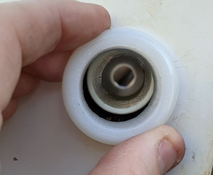

Fig. 8. Close-up view of misfit between the drain tube and the iboard flange. Alignment required bending the tube to meet the flange ID.
As seen above, the flange [on the inboard end of the drain] is centered in the [existing drain hole]. Notice the misalignment between the flange and the tube. Best fit was achieved by inserting the tube the stern towards the interior, then reaching inside the flange with a finger and putting enough force on the tube to bend it into alignment with the flange. Then the pieces pressed together easily. Also, Inserting the tube from the outside of the boat was much easier [than if the new drain tube were inserted from the inboard side].

Postby MattFL » Tue May 04, 2021 12:18 pm
I hope it's the last time, too.
The last [cockpit sump drain on this 1996 MONTAUK 17] was installed using 3M5200. To remove that drain tube was not difficult. I just grabbed the outside flange with channel-lock pliers, gave the tube a twist, and that was enough to break the bond.
There is a significant gap between the tube and the hull due to the size of the holes drilled at original manufacturing. I think that gap reduces the strength of the bond. The flange is larger than the hole, but not by much; the tube rattles around in the hole pretty loosely. It's definitely not a press-fit part.
Postby jimh » Tue May 04, 2021 2:23 pm
With regard to the apparently poor adhesive bond that existed between the plastic drain components, the fiberglass laminates, and the interior foam in your prior installation that allowed such easy removal of the drain from the long hole through the hull: I am quite surprised that the bond between the plastic, the adhesive, and the hull was so weak. The general notion of the strength of 3M5200 adhesive suggests its bond would be much stronger than you describe in your narrative of the removal of the old drain tube. My own first-hand experience in attempting to remove a through-hull fitting that had been bedded in place with a strong adhesive sealant was very different from your experience in removing the old drain. We were hitting a plastic through-hull fitting with a large mallet, and it would not budge. There was not a chance we would have pulled it from the hull with slip-joint pliers. We had to cut into pieces and chisel it out.
