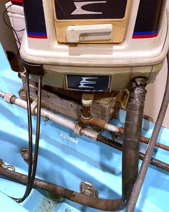

Fig. 3. Lower engine mounting bolt head on inboard face of transom. Note cracked laminate at upper right.
Fig. 4. Port upper outer engine mounting nut seen in extreme close up from overhead.
Fig. 5. Engine mounting with shim, showing engine mounted in lowest engine height position.
Fig. 6. Engine mounting cockpit view.

In FIgure 5 a shim is shown that creates a change in the angle of the engine mounting. Usually a shim is used to permit more tuck-in or trim-in of the engine. This one seem to be mounted to create more trim-out, which generally is not necessary.
Since you plan to remove the engine, you should check the engine mounting hole locations on the transom. The engine appears to have the classic OMC and BIA engine mounting hole layout, so the transom mounting holes should be in the BIA layout. For more advice see the FAQ at Q8.
The stencil number of your 13-footer is 27054. That number is in the range associated with 1968 boats.
