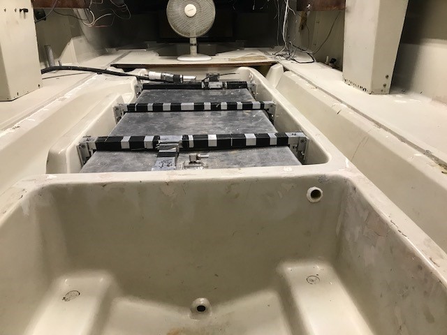

I have a Revenge 22 that I am working on getting back on the water. In Figure 1, below, I don't see the use for the small PVC tube which allows water to pass [between] the chamber in the [upper right] corner [of the photograph] and the fuel tank chamber.
Fig. 1. Deck of REVENGE 22 with fuel tank cover removed showing fuel tank and an unusual drain tube.
Q1: Why would I want water, if there is any, to go to the fuel tank chamber?
Q2: Should the tube be left in place?
Q3: Should the tube be removed and the area completely sealed?
Q4: If water enters the fuel tank area, where else does it exist beside the tunnel on the port side?
At the end of the port rigging tunnel, there is a little tube to drain water to the live well (not illustrated). Since this tunnel is high on top, if water goes into the fuel tank area, the majority of it will stay in the bottom of the fuel tank area unless I have a pump to pump water out.
Q5: Am I correct?

rnln wrote:...I don't see the use for the small PVC tube which allows water to pass [between] the chamber in the [upper right] corner [of the photograph] and the fuel tank chamber.
The area forward of that small tube is drainage from the cabin seats. I would not expect much water to occur in the cabin. Exactly what the original designer of this hull and model was thinking would be the need for the tube is unknown to me.
I have a 1990 REVENGE 22 W-T Whaler Drive, but I have never removed the fuel tank cover. I can't comment if a similar drain is in place on my boat.
rnln wrote:Q1: Why would I want water, if there is any, to go to the fuel tank chamber?
I do not see any reason to intentionally drain water into the fuel tank cavity. The original design of this hull may have assumed that the fuel tank cavity would be completely sealed, and any water entering at the top of the cavity would just sit on the top of the fuel tank and its foam surround, eventually moving aft to exit into the Starboard rigging tunnel via a hole in the bulkhead. Or to evaporate. Or to saturate the foam.
rnln wrote:Q2: Should the tube be left in place?
I don't have a reasoned answer for you.
rnln wrote:Q3: Should the tube be removed and the area completely sealed?
rnln wrote:Q4: If water enters the fuel tank area, where else does it exist beside the tunnel on the port side?
The Port rigging tunnel dead ends at the aft end of the cockpit. Water will accumulate in the Port rigging tunnel until it rises high enough to reach the cross drain tube that leads to the Starboard rigging tunnel; that's how the plumbing is on my boat.
rnln wrote:At the end of the port rigging tunnel, there is a little tube to drain water to the live well (not illustrated).
On my boat the Port rigging tunnel at its aft end is drained into the Starboard rigging tunnel by a hose that runs across the top of the aft cockpit live well.

I completely stripped my 1980 Revenge 22 during my rebuild and have been where you are now. You ask very good questions about Boston Whaler's design to drain water under the deck.
The answer is all water that runs under the deck on the port side is eventually directed to the top of the fuel tank. This turned out to be a horrible design because the foam around the tanks absorbed water causing the aluminum tanks to corrode. But the design it is what it is, now. The design was to send water that enters along the fuel fill and vent hoses down across the top of the fuel tank, through a tube level with the top of the tank into the starboard side rigging tunnel. From there drain out the sump in the starboard stern.
The tunnel you mention with the tube leads to nowhere so that PVC tube is a good thing as long as it is sealed, and water cannot get around it into the foam core. Without that PVC tube, there is no other way for water to get out of that tunnel. My boat didn't have one, so I added one and ran my vent hose through it.

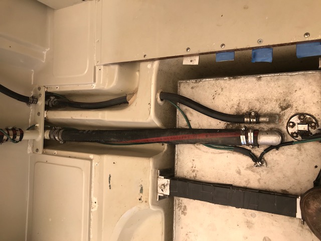

Early model Revenge 22 boats such as mine have a one piece floor section so both the port and starboard cabinets have to be removed to gain access to the fuel tank cavity. To make access easier this was changed on later models so the cabinets no longer have to be removed to gain access to the fuel tank. Figure 3 show's that I made a change and cut my 1 piece floor into two sections adding aluminum angle in sections for support.

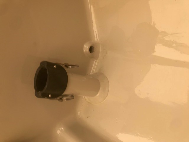

The picture in the OP's figure 1 is a later model Revenge 22 which has two piece floor covers so the forward part of the tunnel is not exposed.

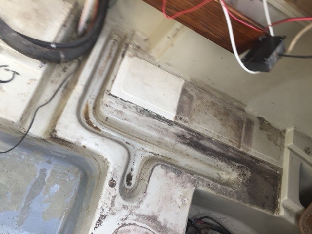

I attached what is now Figure 4 to show the factory designed tunnel in its entirety.
Being the OP is so close to the fuel tank. I highly recommend he pull the tank and inspect it for leaks or corrosion.

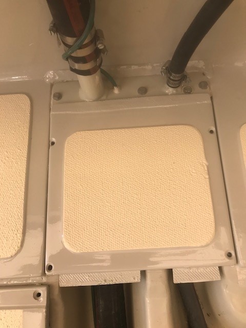

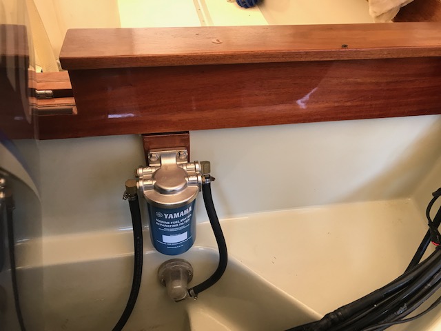

Fig. 2. [A modification has been made to create a deck section with fittings to permit the fuel filler hose and the vent hose to pass through the deck level without allowing water to enter. In the OEM configuration the hoses pass through an opening in the deck and enter the athwartship rigging tunnel. That opening also allows water on the deck to drain into the rigging tunnel and thence to the fuel tank cavity area. This is another boat, not the boat under discussion in this thread.]
Whaler pic fuel manifold with painted cover.jpg (61.86 KiB) Viewed 76087 times

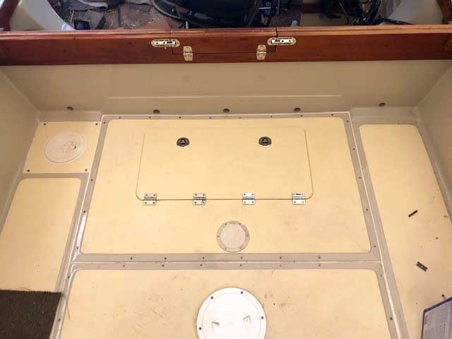

Fig. 3. [A further modification has been made to separate the fuel filler hose and the vent hose. The vent hose now is passed through a newly created hole in the Port deck liner mold, instead of following the route of the filler hose. This is another boat, not the boat under discussion in this thread.]
whaler pic fuel fill tank to top uncovered.jpg (71.8 KiB) Viewed 76087 times
Fig. 4. [What appears to be shown here is a rigging tunnel on the Port side forward of the helm area on another boat, not the boat under discussion in this thread.]
whaler pic tunnel to nowhere.jpg (72.27 KiB) Viewed 76064 times

Vance's Revenge wrote:The tunnel you mention with the tube leads to nowhere so that PVC tube is a good thing as long as it is sealed, and water cannot get around it into the foam core. Without that PVC tube, there is no other way for water to get out of that tunnel.
Here I presume you mean "sealed" as in the tube is sealed off from the foam core. If the tube itself were "sealed" it would no longer be a drain and would have no use.
Re: REVENGE 22 Hull Drains
Postby jimh » Fri Nov 05, 2021 10:12 am
I believe the purpose of the rigging tunnel that is seen in Figure 4 (and also partially seen in Figure 3) and located on the Port side and forward, may have been to route wiring to the helm in the center console versions of the 22-foot hull. In a REVENGE model, the helm is located on Starboard, not in the center, so much of the wiring is routed through the Starboard rigging tunnel or routed under the gunwales.
In the OUTRAGE models the purpose of the rigging tunnel may have also been to drain water on the foredeck into the deep locker located on centerline. This locker is the lowest sump on the boat.
When the OUTRAGE 22-foot hull was adapted to become the REVENGE 22-foot hull, they just used the same molds. This was typical of Boston Whaler at that time. Later, Boston Whaler began to create liner molds that were more specific for a particular model, even if the hull mold was the same for several models. But in the 1980's Boston Whaler relied on clever adaptations to produce different models from the same molds.
An example of this is seen in the liner mold for the REVENGE. There is a section of the original liner that is cut out and removed. This creates a step down into the cabin. Reworking the liner after molding was probably less expensive than creating an entirely new liner mold just to make a REVENGE. I suspect there were many more OUTRAGE models sold than REVENGE models.
As for water entering the fuel tank cavity from the deck, the deck would need to be awash for a significant volume of water to enter the fuel tank cavity. In my experience with operating a REVENGE 22, the only time water comes onto the cockpit deck is if there is heavy rain falling and the deck is uncovered. The cabin superstructure, the windshield, and the side bulwarks prevent all water from spray from getting on the deck. About the only place on a notched transom REVENGE 22 for seawater to get on deck is from coming over the the wide transom. Generally the trim on the boat will be down-by-the-stern, so water coming over the transom is very unlikely to flow forward and enter the fuel tank cavity by these rigging tunnels near the bow.
Rain is freshwater, so its effect on the fuel tank is not as harmful as saltwater. I recall one night we were aboard and there was a very heavy rain. The rain water drained aft into the aft cockpit livewell, and actually filled it to the brim. It was upon that occasion that I decided to add a small sump pump in the aft cockpit livewell with a float switch to automatically activate it to expel any accumulation of water.
It is possible to be critical of the design of the REVENGE, but I don't find that water in the fuel tank cavity is a big problem. The foam is generally not susceptible to becoming totally saturated with water. In the very rare instance I have seen water sitting atop the foam, it has only been in a very small volume. By removing the circular deck plates the top of the fuel tank and its foam surround will be exposed to the air, and evaporation will remove any water in short order on a warm, sunny, breezy day.
Postby jimh » Fri Nov 05, 2021 10:37 am
Re Figure 1: I see a lot of mold or mildew on the liner surface. Mildew is created by freshwater. Mildew can be insidious and spread. I recommend that the liner be thoroughly cleaned and mildew removed as much as possible.
Also re Figure I: I see there is a circular stain on the fuel tank in the area of the tank level gauge. This stain was probably created by water leaking through the clear, circular, pry-out deck access plate cover. The pry-out circular deck access plates employ a large rubber O-ring as the seal. I recommend you inspect all the deck circular pry-out access plates, and assess the integrity of the rubber O-ring. Also, you should assess the integrity of the circular deck access surround; it should be sealed to the deck with a sealant.
On my 1990 REVENGE 22, the general condition of the boat is excellent. However, I have replaced several circular deck pry-out access plates due to the removable section being cracked. For information on how to obtain replacement circular deck pry-out access plates, see:

The molded part you added with the adapters to take the fuel and vent hoses is great. I was thinking if water gets in that area, it will flow to the fuel tank cavity. I was thinking of rigging something to seal that when I am done with myREVENGE 22, but "how to" was the question.
Q6: Do you have any idea to do the same as your current setup but both fuel and vent hoses are still running in the same tunnel?

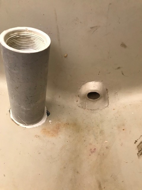

Another through hull tube I wonder if I need it is the brass tube between the live well and the transom well. The end of this tube on the transom well has a ball inside a housing. I think the ball is allowing water to go from live well to the transom well but not from transom well to live well.
Q9: why would I want water from live well goes to transom well?
Q10: If it is there for me to drain water from live well after I pulled the boat onto the trailer after a ride, then isn't 1 drain on the live well enough? I do see another drain tube on the live well goes directly through the bottom of the hull.
If a through hull is not really needed, I rather pull it out, fiberglass the hole for less chance or risk of water into foam. I already bought some tubes and flaring tools but it seem like there is no way for me to flare that odd angle tube in that narrow transom well
Thanks again.
This picture I found on one of Vance's posts, hope Vance don't mind I am using it here as an example. On this pic, the bottom drain hole on the right of the pic is what I am talking about. It is connecting the live well to the transom well. Does anyone know in which case I would need it?
Fig. 5. View of another boat, not the boat under discussion in this thread. Note the drain hole in the right.

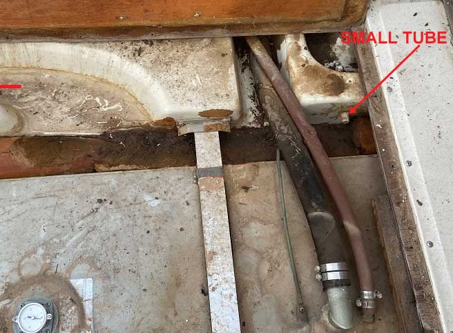

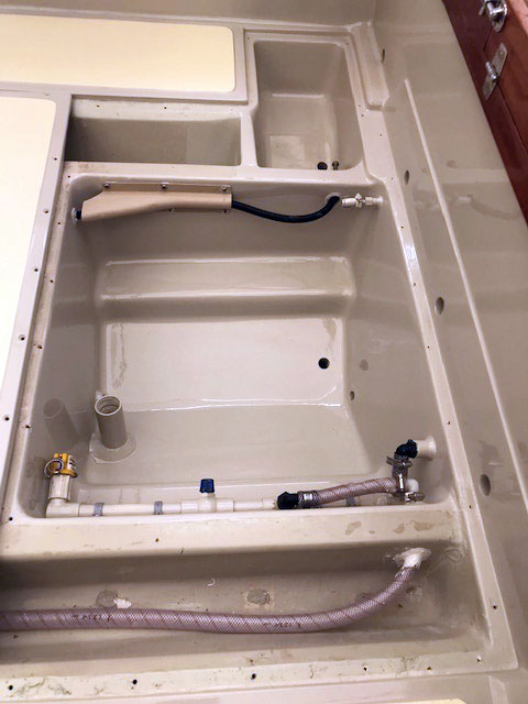

This doesn't make sense. Is it possible you meant the starboard rigging tunnel for Pipe 2 and 3?
The port side tunnel doesn't run the full length of the gas tank cavity on a 22 Revenge. The tube from the tank to drain in the middle of the boat is in the starboard side.
Please see Figure 6 below,; you will see the port tunnel empties into the fuel tank cavity in two sections.
Fig. 6. Liner mold with deck cover removed. The 1-inch diameter drain hole between the fuel tank cavity and the aft cockpit live well is an owner-added modification that permits the fuel tank cavity to be drained into the live well. This drain is normally kept plugged. The plug is removed when water has accumulated in the fuel tank cavity. Also note the fuel tank is not foam-in-place. This is another boat, not the boat under discussion in this thread.
Whaler Pic Livewell and tank exposed.jpg (62.31 KiB) Viewed 75868 times
rnln wrote:Q5: I should get a long hose to connect the through hull pipe-1 to pipe-3 so water from fuel-fill and cabin area can exit to starboard-side tunnel and to the bilge area instead of dumping into the gas tank area?
I don't think this is a good idea, pipe-3 in your description needs to be clear to let water escape from the tank area to the starboard side rigging tunnel.
rnln wrote:Vance--the molded part you added with the adapters to take the fuel and vent hoses is great. I was thinking if water gets in that area, it will flow to the fuel tank cavity. I was thinking of rigging something to seal that when I am done with my REVENGE 22, but "how to" was the question.
There is no room to put both aluminum tubes on one side. That is why I separated them utilizing the forward port tunnel for the vent hose.

rnln wrote:Another through hull tube I wonder if I need it is the brass tube between the live well and the transom well. The end of this tube on the transom well has a ball inside a housing. I think the ball is allowing water to go from live well to the transom well but not from transom well to live well.
Thanks again.

Q11: in Figure 6 is that drain between the fuel tank cavity and the [aft cockpit live well] at the bottom of each something you added?
Vance's Revenge
Posts: 116
Location: Northern California
Postby Vance's Revenge » Tue Nov 09, 2021 4:10 pm
jimh wrote:VANCE--in Figure 6 is that drain between the fuel tank cavity and the [aft cockpit live well] at the bottom of each something you added?
When I replaced the fuel tank I didn't foam-in-place the tank. That is why you see the extreme bracing along the top and on each end of the fuel tank.
Without the foam the tank cavity can and will fill with water up to the top of the tank where the drain hole drains into the starboard rigging tunnel with no way to drain the cavity.
To combat this I added the 1-inch-ID fiberglass drain tube at the bottom to plug off and inspect the tank cavity for water. It accepts a normal 1-inch rubber drain plug similar to what is normally used in the transom.
The wall between the fuel tank cavity and the rear live well is not very thick so it is a very easy addition.
Vance

In my opinion, Vance's modification is useful. I presume that the lowest point in the fuel tank cavity must be slighter higher than the lowest point in the aft cockpit live well, and that facilitates the water draining out of the fuel tank cavity and into the live well.
Q12: Once the water gets into the live well, how do you remove it?
Q13: On your modified REVENGE 22, I think I see a drain in Figure 5 that drains the aft cockpit live well into the deep engine splash well. Did you add that drain, too?
Q14: Have you added a pump to remove the water from the aft cockpit live well?
On my REVENGE 22 I have added a centrifugal pump to lift water out of the aft end aft cockpit live well and then exhaust it overboard. Because my boat has a Whaler Drive, the exhaust hose from the pump is routed to the aft cockpit scuppers (which are 3-inch diameter open scuppers through the transom). The added buoyancy of the Whaler Drive keeps the scuppers above the water line. These same scuppers will also drain water on the cockpit deck to the sea.
Vance's Revenge
Posts: 116
Postby Vance's Revenge » Wed Nov 10, 2021 12:09 pm
jimh wrote:In my opinion, your modification is useful. I presume that the lowest point in the fuel tank cavity must be slighter higher than the lowest point in the aft cockpit live well, and that facilitates the water draining out of the fuel tank cavity and into the live well.
Due to the modifications I made to the hull liner and deck to prevent water from getting into the fuel tank cavity. So far I have not had much water, if any water come out of the fuel tank cavity yet. Maybe a cup or so once or twice when inspected and I think that is getting past the deck plate seals when blasting/washing the deck.
jimh wrote:Q12: Once the water gets into the live well, how do you remove it?
I trailer my boat and take it out every day I fish so I pull the two drain plugs in the live well and rinse any water out with clean water. There is always a little water that sits below plug level that I wipe out with a towel or sponge. Or I let it sit and it evaporates over time.
jimh wrote:Q13: On your modified REVENGE 22, I think I see a drain in Figure 5 that drains the aft cockpit live well into the deep engine splash well. Did you add that drain, too?
My 1980 Revenge already had a brass tube there from the factory with a ball scupper on the stern end in the deep engine splash well. I replaced the corroded brass tube with a 1" ID fiberglass tube. I couldn't find a replacement ball scupper that would fit so I use a rubber plug in the live well to control how much water (if any) I want in there. I'm not real sure why the original design had a ball scupper.
jimh wrote:Q14: Have you added a pump to remove the water from the aft cockpit live well?
In my situation, I have not seen the need to add a pump to the aft live well. I made a water proof door (Picture below) to the top to prevent unwanted deck water to enter so a pump is not necessary. This door is made out of 3/16" aluminum so it sits pretty flush with the floor and is not a trip hazard. I have drained the live well of unwanted water while the boat was on plane though.
jimh wrote:On my REVENGE 22 I have added a centrifugal pump to lift water out of the aft end aft cockpit live well and then exhaust it overboard.
It sounds like you did a nice job with the pump and must work very nice. Especially handy when the boat is at rest or off plane on the water.
REPLACING AFT COCKPIT STARBOARD SUMP COVER
Also, I ran the rigging and wiring [under] the boat gunwales so I didn't have to utilize the starboard rigging tunnel. This meant I [modify the deck and replace the original wooden hatch with a circular] deck plate. With the deck sealed, no water can get to the aft starboard cockpit sump and enter the live well through the fuel line access to the live well unless I pull a plug to fill it. This is shown below in Figure 7.
Fig. 7. The OEM hatch over the aft cockpit starboard sump is now replaced with a sealed circular deck plate. This is a different boat, not the boat under discussion.
REROUTE FUEL LINE
Another change to prevent unwanted water from accessing the aft starboard cockpit sump and live well: the fuel line no longer travels the original route and comes out on top of the deck at the drain sump. I sealed a 3/8-inch stainless steel nipple through the top left rear bulkhead of the factory live well into the rear deep engine splash well and attached my fuel line to it. See Figure 8.
Fig. 8. New fuel line path to transom engine lower splash well through the aft bulkhead.

I installed a tank cavity drain tube from the tank cavity to the rear livewell. I glassed in a one inch fiberglassed drain tube with epoxy resin. You can see the pic here
https://garys22revenge.shutterfly.com/pictures/132#127
I highly recommend this as it allows for quick and easy removal of water from the tank cavity. If you scroll the pics on my shutterfly page you can see all the steps I used when refurbishing my existing plastic below deck tank and associated cavity. There are multiple ways for water to enter this tank cavity, and no ways for water to be removed.

Anybody that has replaced their fuel tank without adding foam back similar to the factory install has created what could be a big problem; if the drain tube between the fuel tank and rigging tunnel was not removed and sealed your fuel tank area will most likely be full of water submersing your tank up to the level of the drain tube at the top of the fuel tank. Even if you don't run the floor drain sump open water can still get to the tank area by entering along the fuel fill and vent hoses.
This is why I added a drain tube (shown in figure 6 above) between the fuel tank area and the stern fish well.
The only way I can think of to utilize the original drain system designed by Boston Whaler and prevent water from accessing the foam and fuel tank (which can cause the aluminum fuel tank to corrode) is to install a thin non-structural fiberglass barrier across the top of the tank as I described above in an earlier post.
It would be very interesting to hear of other thought's/idea's as well.

Figure 10 below illustrates how the fuel hoses are run on my boat.
Fig. 10. Sketch of existing fuel hose routing. The red lines represent copper tubing fuel lines; the brown lines represent rubber fuel hoses.
I planned to put two 1.00-inch fiberglass tubes side-by-side there with Marine-Tex. Each [rubber fuel] hose goes through each tube. The plastic cover won't fit because two fiberglass tubes take too much space; Therefore, I plan on having one fiberglass tube there and plan to extend the two brass tubes to go through it.
Is there a problem I have missed?
