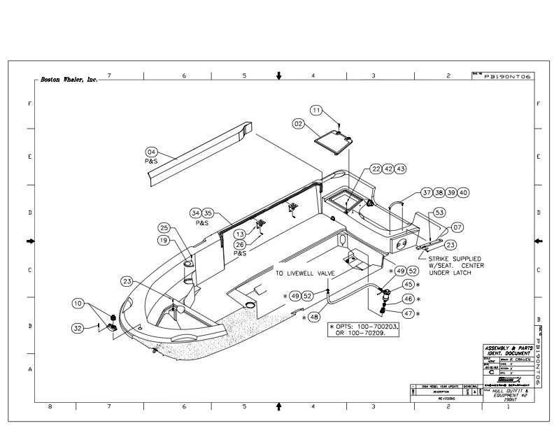

The gunwale cap is attached with an industrial type adhesive.
Fig. 1. An assembly drawing showing general arrangement of the hull and gunwale (at CALLOUT 4).
To reattach the gunwale cap the old adhesive must be removed. Use heat and fishing line to break the bond.
Use of 3M5200 is not applicable; it does not bond well to aluminum. I recall at one point Boston Whaler used IPS adhesive.
