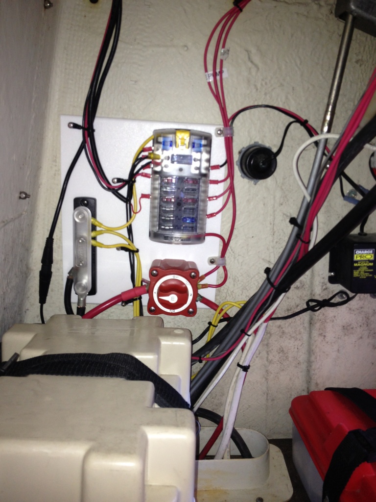

Attached is an image of the interior of one of my classic consoles, granted the picture was targeting the fuses and battery selector. The battery is forward, starboard corner, in a Boston Whaler battery box, strapped down to the floor of the console. No build up of the sub floor was needed. (Battery is an Optima BLUETOP, which probably doesn't need a battery box anyways.) -- What you can not see in the image is the main DC fuse, and the short cables going to/from the battery.
In this install, all hardware was pre-mounted and wired to the board, then with 3M 5200 bonded it to the console interior. (I really don't plan on removing in my lifetime.)
My only comment to the battery being on the floor within the console, is that it's a chore to clean under it when you want to. When it's back aft, to get underneath is a one handed job. -- Water ingress is not into the battery box, but into the console as you wash down underneath.
- Final wiring.JPG (241.52 KiB) Viewed 10848 times
Re: 1988 Montauk 17 Moving Battery to Console
Kwik_wurk that's an excellent picture of a beautiful wiring job.

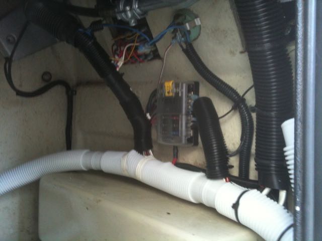

Rewire - After the spaghetti:
I enclosed all the wires in bilge tubing and wireloom to protect it from objects getting thrown in the door (by others). Battery is in a floor cutout out of view.
