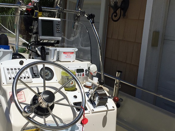

Hi all! I recently went to a dual lever morse control for my single outboard (1984 Johnson 75 HP) 17 whaler. I have it set up as JIMH mentions above, Black is shift, red is throttle.
I have used this set up for over a year and love it. I feel I have more control with this set up, and yes I pay more attention when docking!
I have 2 young boys and I had the same concerns on accidentally bumping the controls while running. It has been bumped and the worst that has happened is a slight surge in throttle, very rare occurrence. Once in gear and above 1000 rpm the shift does not seem to move freely, you have to decrease the rpm to shift. I'm not sure if this is unique to my set up though.
Picture of my current set up.

That is a great installation. Thanks for showing us your nice work.

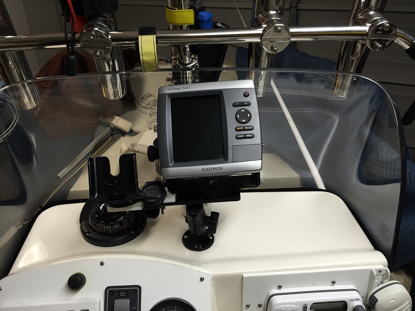

Is that Garmin mounted via a rail mount? Can you provide details of the install and review? Maybe a separate thread.

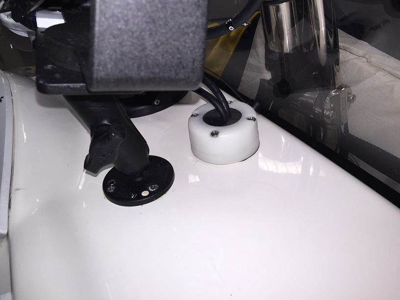

Hi Phil - not a rail mount. I used a RAM mount on the console. I just mounted the Garmin on the RAM mount. Standard install on the Garmin and transducer. I used a clamshell to snake the wires through into the console top. I also added a piece of starboard and mounted a stand alone Garmin GPS next to the Garmin 541s.

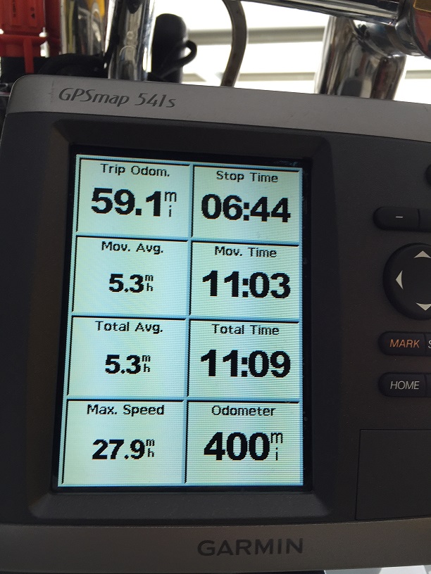

Overall, I'm happy with the Garmin 541s, with the Airmar P66 transducer I can easily spot baitfish and predator fish marks. All functionality has worked as designed and has been dependable (about 4 or 5 years now). The GPS, speed and track/route functions are useful when trolling and going back over a productive area.
I also like to know how many miles and time I spent on the water, it helps me track gas consumption etc.
I will say that next time I will go for a bigger screen, maybe 7 inches as I think I have enough room for it. The RAM mount helps keep the console top area available for sunglasses and other stuff.
Let me know if you need further info and I'll be happy to help. Thanks
