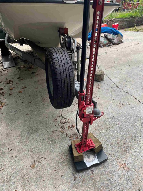

Before putting the boat in the water, I had to reinstall the fuel system. Fortunately, the fuel connector for my Mercury outboard fits the Yamaha, but the Yamaha owner’s manual recommends installing an external 10-micron fuel filter despite there being a 10-micron filter under the engine cowling. When I purchased the boat, it came with an external fuel filter installed in the splash well just above the hull stencil. Although I have read that this isn’t a good place for such a filter, it served me well there. For most of the last 30 years, I’ve used a RACOR S3213 fuel-water separating filter with a clear plastic drain bowl, and during that time there have been only two problems: One was when I left the filter on for two years before changing it, there was enough corrosion on the filter threads to require a wrench to remove it. The other was that the drain bowl wouldn’t securely thread on to the filter after a few years of use. This is a well-known defect that was corrected by the manufacturer ten years ago (read about it here).
I’ve never had a problem with water contamination, so two years ago I replaced the Racor with an inexpensive in-line filter (Baldwin BF7736) which the manufacturer says is designed to “protect sensitive fuel system components, such as injection pumps and injectors, from damaging contaminants”, but makes no claims to be water-separating, and the manufacturer doesn’t provide a filtration size, so I took this opportunity to reinstall the RACOR filter. Despite having spent more than 30 years above the splashwell, there was very little corrosion of the Quicksilver mounting head, perhaps because the motor had dripped a little oil on it every time the lower unit was raised. The spot where the filter had been installed was now covered by a 3/8-inch-thick transom support plate, so I carefully drilled and tapped the plate for two ¼-inch x 20 stainless steel screws for the reinstall. I generally use something to prevent corrosion and galling when dealing with stainless steel fasteners, especially when fastening dissimilar metals, and in this case I applied anti-seize lubricant that I had left over from another project.
One concern regarding fuel systems that boat owners have argued about for decades is where to locate the primer bulb in relation to the fuel filter. Proponents of putting the bulb downstream of the filter claim this will prevent damage to the filter from high pressures generated by the bulb and protect the check valves in the bulb from being clogged by debris, while advocates of locating it upstream of the filter argue that this will make priming an empty filter easier and avoid damage to the engine from debris released by the bulb should the rubber of which it is made deteriorates. Neither the Yamaha owner’s manual, rigging guide, nor the service manual that I reviewed comment on this, but this recent post suggests that the argument has been settled, at least for Racor filters:
(You can find this post here.)
I was intrigued by this comment since I have been a Racor customer for more than 30 years and had never encountered this instruction. I searched the manufacturer’s website and reviewed their extensive (888 pages!) online catalog , which contains detailed information about all their filters, including installation instructions and diagrams. The term “primer bulb” does not appear in this document; however, Racor markets filters that incorporate built-in priming pumps, like this one. These priming pumps are on the upstream side of the filter, meaning they pump fuel from the tank into the filter.
Note the following Racor installation diagram:
Perhaps this controversy about primer bulb placement exists because Racor recommends that fuel transfer pumps be downstream of the filter to avoid emulsification of water with fuel. Given that fuel transfer pumps aren’t the same as primer bulbs and Racor markets priming pumps that are upstream of its filters, I think one can safely install a primer bulb either upstream or downstream of the fuel filter. Here is what my fuel system looks like now:
I’ve kept the in-line fuel filter for now, but at some point I might replace it with a 100-micron pre-filter to minimize resistance in the fuel system, or perhaps I'll just remove it.
Regarding damage to a fuel filter from over-pressurization by an upstream primer bulb, Racor cautions against pressures above what is rated for the filter, which in my case is 7 psi. Can a primer bulb exceed this pressure? Having some pressure gauges and fittings previously used on other projects, I decided to find out. I hooked up a primer bulb to about one foot of fuel line with a pressure gauge and a ball valve on the other end. When I pumped up the system with air, I couldn’t get more than about 0.5 psi, but when I filled the system with water, the pressure immediately rose on pumping, with the bulb becoming firm at 3 to 4 psi. If I were preparing the engine to run, I would have stopped pumping at this point. I could get the pressure up to 18 psi, but only with a very vigorous effort that I would not have been able to achieve on a boat. Keep in mind that this was a worst-case scenario, with a short run of tubing and pumping against a closed valve. I’m comfortable that I won’t be damaging my filter by using an upstream primer bulb. (By the way, even if you have a primer bulb downstream of your external fuel filter, you are still upstream of the filter under the cowling.)

Figure 5 shows the fuel hoses being used have a gray external covering. However, the hoses do not appear to have the "metallic" gray appearance that was a birthmark of hoses that had a notorious history of becoming blocked when a liner to the inner portion became detached from the outer hose material when the hose was used with gasoline-ethanol blended fuels. The legacy of these bad fuel hoses has tended to associate the color gray in fuel hoses to be somewhat suspect. Perhaps you can give details about those hoses.
Also, on the topic of fuel hoses, I was very surprised at the recent cost of properly rated fuel hose that complies with the latest federal regulations about permeability of the hose, and with ratings for tolerance of gasoline-alcohol blended fuels. While WEST Marine might not be the cheapest source, selling fuel hose at $10 per foot seems rather crazy-expensive. Compare at
https://www.westmarine.com/shields-rubber-3-8inch-i.d.-series-368-low-permeation-marine-fuel-hose-10378032.html
As for where the primer bulb ought to be located relative to a RACOR fuel-water separating filter, I cannot recall exactly from years ago where I found some literature from Parker that recommended the primer bulb be placed downstream of their filters. However, there are many instances in Boston Whaler boats that are pre-rigged at the factory where the primer bulb is placed downstream of a fuel-water separating filter. Also, putting the primer bulb near the engine seems like a more practical placement.
With today's engines the need for a primer bulb is much reduced, as their fuel systems are not openly-vented to the atmosphere as they were in the heyday of carburetor engines, so once the fuel system has been primed, it remains primed for months and months of non-use as there is no fuel evaporation in the carburetors. I still have a primer bulb on my boat, but at Spring engine start only perhaps one squeeze of the primer bulb will remove any softness in the primer bulb.
Your notes on experiments with creating pressure with a primer bulb are most interesting. Actual testing is the best method to obtain data like that, and to know you could create 18-PSI is very interesting.
Also thanks for the link to the RACOR literature about suspect clear fuel bowls. That topic has come up before, but the literature you found from RACOR makes the situation more clearly presented.
ASIDE
Installing a pressure gauge across the filter element is a recommended method to show the loss of pressure through the filter element which is then used to deduce that the filter media is becoming clogged and needs to be changed. But adding that on a small boat installation would seem a bit extravagant.
CONFESSION
I have an older RACOR with a clear, removable lower bowl, and I have not changed it in years. It is one of those projects I keep thinking about, and I have new filter media, but I just never quite get to.

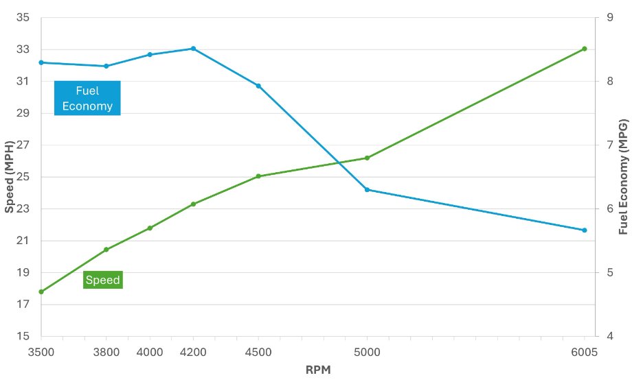

PART FIVE: SEA TRIAL
Before beginning the formal trial, I ran the boat at 4,500-RPM and moved the jack plate through its entire range. I only gained about 1-MPH boat speed by jacking up the engine all the way, and this was accompanied by substantial propeller and exhaust noise. This was similar to what I had encountered with my previous engine (see here).
Trial 1 – One person, two batteries in stern, two Mirax aluminum 12-gallon fuel tanks, 7 gallons fuel, two empty ice chests. Estimated total cargo weight 358-lbs.
Trial 2 – Equipment as in Trial 1 plus 10-gallons more fuel and 220 quarts of lake water, (100 quarts in forward ice chest, 120 quarts in chest behind pilot seat). Estimated total cargo weight 874-lbs.
Additional observations:
- I achieved a WOT RPM close to 6,000-RPM, but I lost 5.5-MPH at WOT going from a two-stroke Mercury 90-HP to the Yamaha F70.
- There was a striking improvement in initial acceleration. I had to firmly grasp the steering wheel when accelerating from idle to keep from falling over. Perhaps this is due to having a lighter, ventilated propeller.
- I typically cruise at 25-MPH, and I’ll be able to do that by running this engine at about 4,500-RPM.
- These speeds are a bit slower than what I have seen previously posted for this boat/engine/propeller combination.
Your comments would be welcomed.
M
- June 6, 2025; Lewis Smith Lake, Alabama; elevation 510 feet; air temperature 79-degrees-F;
- boat speeds measured by GPS (Humminbird Helix 5); engine speed measured by Quicksilver analog tachometer (not calibrated); aAll values listed are the mean of two runs in opposite directions;
- jack plate raised 1.5-inches (A/V plate 2.5-inches above keel);
- engine trim set to be neutral at 4,500-RPM.
.................................Trial 1 Trial 2
Time to plane (sec) 7.0 8.9
Speed (mph) @
3,000 RPM 11.5 9.0
4,000 RPM 22 20
5,000 RPM 28 27.5
WOT RPM/speed 6,000/33.5 5,850/31.5

When I hooked up the trailer to take the boat out for a spin in the lake before heading for my annual Louisiana fishing trip, I noticed that the tongue weight was much heavier than before the repower. I have an EZ Loader adjustable trailer, and a few years ago I had adjusted it so that the transom is directly over the rear rollers while maintaining the tongue weight at about 175 pounds. Since the recent repower, the tongue weight is 260 pounds.
I believe the definitive treatise for calculating the trailer setup to achieve a specified tongue weight is an article on ContinuousWave (see here), but I just did it empirically by suspending the trailer on concrete blocks, loosening the bolts that secured the axle, moving the axle by tapping the supports with a hammer and block of wood, re-tightening the bolts, removing the blocks, checking the tongue weight, and repeating the process until I achieved the desired tongue weight. This may sound tedious, but it was actually easy to do. With both 11-gallon fuel tanks full and two batteries, I estimated that my gross weight is about 2,000 pounds. I wanted a tongue weight between 5 to 10% of the gross weight, or 100 to 200-lbs.
I added a 42-lbs bucket of kitty litter at the transom to approximate the weight of the second battery with which I usually cruise. Moving the axle assembly forward 5-inches yielded a tongue weight of 185-lbs--close enough.
--M
--M

Re: Re-powering the Montauk 17 in 2025: an Illustrated Narrative
If your estimated total weight of 2,000-lbs is correct, and your measured trailer tongue weight is accurate, then the amount of tongue weight as a percentage of total towed weigh is then 180/2000 = 0.90 or 9-percent.
The previous tongue weight of 260-lbs was 260/2000 = 0.13 or 13-percent.
When part of the towed trailer weight is transferred to the hitch of the towing vehicle as tongue weight, most of that weight is transferred onto the rear axle of the towing vehicle. There may also simultaneously be a reduction of weight on the front wheels of the towing vehicle. By reducing tongue weight, you most likely also reduced the weight on the rear axle of the towing vehicle while perhaps also increasing somewhat the weight on the front axle, compared to those weights with the higher tongue weight.
If the towing vehicle is a front-wheel drive, losing weight on that axle can reduce traction and affect steering. So decreasing tongue weight can help avoid those problems.
ASIDE: on my rear-wheel drive 1995 GMC Suburban the recommend tire pressure for the front wheels is lower than for the rear wheels, which I believe is done to maintain better contact with the road surface for the front tires and improve steering.

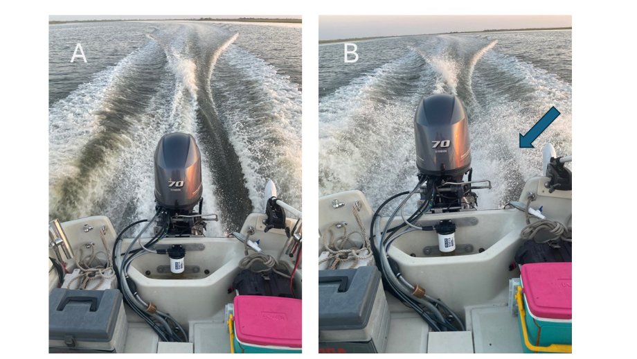

The Yamaha F70 owner’s manual recommends that if the engine cannot be trailered in the normal running position, an additional support device should be used to secure it in the tilt position. I didn’t have any support device, so last month I just tilted the engine up and headed out on the highway. During the 400-mile trip from Birmingham to Cocodrie, Louisiana, I noticed that the lower unit moved down a few inches, but not enough to put the skeg in danger of hitting the pavement.
My fishing partners seemed relieved to see the new engine, and once launched they were impressed with how quickly it started: no priming, no throttle pumping, no smoking,and no roaring. We had no engine-related problems during this five-day trip, but one of my partners commented that this motor had a little less “punch” while getting up on plane.
With four people, 20-gallons of gasoline, two batteries, a trolling motor, fishing tackle, and a full 100-quart ice chest, performance at wide-open throttle was a boat speed of 31 MPH with engine speed of 5,800 RPM, closely matching the previous performance with the boat heavily loaded.
I don’t have any way to monitor fuel flow yet, but gasoline economy seemed about 15-percent better than with my previous engine. I suspect that fuel use would have been less if I had run the engine slower than the 4,500 to5,000 RPM engine speed I used for most of the trip.
The only thing I miss about my old engine was the ability to crank the speed up to 35 MPH once we enter Bayou Terrebonne headed back to the fishing camp. My fishing partners were happy with this trip. (See Figure 9).
One interesting phenomenon observed during this trip was how the boat wake changed as the engine was raised while underway. In Figure 10, the photo on the left (marked A) shows the engine trimed with the anti-ventilation plate just below the water surface. In the photo on the right (marked B) the engine is trimmed is one inch higher, with the anti-ventilation plate now about a half-inch above the water surface. Note that raising the anti-ventilation plate above the surface of the water results in water spraying out laterally from the lower unit. This would seem to be a convenient way to confirm the height of the anti-ventilation plate from the helm. I didn’t notice any change in performance when doing this, but the exhaust noise got a bit louder.
Overall, I am happy with this new engine, so I’m keeping it.
My next project will be to set up an NMEA 2000 network so that I can more closely monitor the operation of the engine.
M

A few months ago I installed a Garmin ECHOMAP UHD2 93sv connected to the engine via an NMEA 2000 network (you can read the details of how I accomplished this here: https://continuouswave.com/forum/viewto ... =9&t=10083). This allowed me to assess fuel efficiency, as shown in this graph:
These performance curves closely match those published by Yamaha for a boat of similar weight and hull design, the Avid 18 XB, outfitted with a Yamaha F70 and a Talon SS 13-1/8 x 14 propeller (see here: https://yamahaoutboards.com/outboards/1 ... -27-20_alm). A recent fishing trip gave me another chance to evaluate boat performance. I found that in calm water, I could obtain an additional 0.5 MPG by raising the engine so that the ventilation plate was about 2 inches above the water surface.
M
M

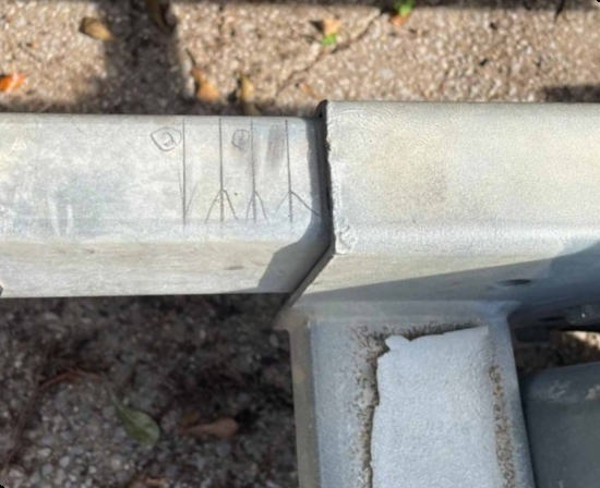

And thank you for documenting the trailer [tongue weight change process].
