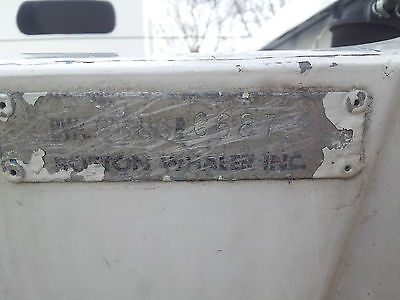

1987 GUARDIAN 18 Re-power
I recently purchased a 1987 GUARDIAN 18. I am told that this model became the OUTRAGE 19. Any clarification on that point would be great.

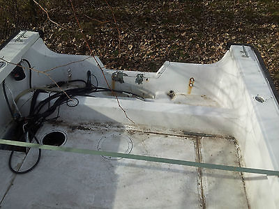

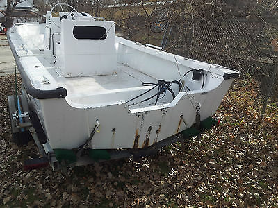

I [want to] purchase [new] power for the [1987 GUARDIAN 18] boat. I have never owned an outboard before--only inboard engine boats. I have been told a very wide range of opinions on what to power the boat with, from 90 to 200-HP.
[Give me] suggestions for power. I want to avoid the complications of twins. I operate a marine towing business on the lower Colorado River in Parker Arizona, so power is important--speed not so much. Fuel consumption is my enemy. I would like to be able to take the boat offshore fishing a couple times of year.
- image.jpeg (69.29 KiB) Viewed 29237 times
- image.jpeg (74.72 KiB) Viewed 29237 times

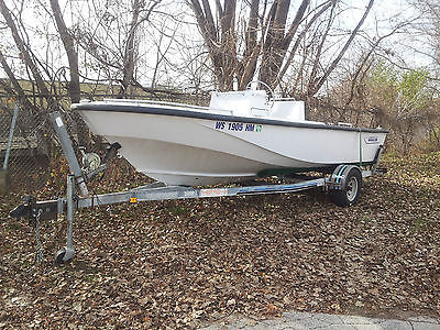

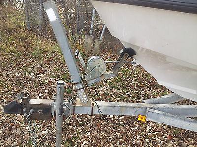

A few more pictures
- image.jpeg (45.45 KiB) Viewed 29236 times
- image.jpeg (36.99 KiB) Viewed 29236 times
- image.jpeg (27.79 KiB) Viewed 29236 times

Is this a normal transom? I understand they are normally 25 inch. Is this a 20?
Re: 1987 GUARDIAN 18 Re-power
Someone hacked up that boat's transom.
The boat had only one owner before me the Wisconsin department of natural resources
Do you think that was for a repower? I had read that there was a few that had 20" transoms
I sure hope it's not hacked is scheduled for delivery tomorrow

Looks like one of their specialist had a 25" hull and a 20" outboard was on the rack - and the boss said make it work.
Are those rust stains or just gunk stains?

Hydraulic fluid and oil so gunk

I have a cmc 5" set back plate I could bolt on. What would the concerns be also if I mounted it up do you guys think it would be wise to undo the specialist work
Mine has a 25" transom.
No cutout...mine is straight across. I couldn't attach pics here so I emailed to you.
We have gotten multiple boats over the years through the GSA. All Whaler's, Navy, DNR, ICE, NP's etc. all were rough except one (see below). The Navy boats were usually in the best shape as they were "one owner", and Navy spec'd hulls are very robust
For the most part everything can be fixed, especially if you are not trying for showroom quality.
I would be concerned about the wood in the transom. Especially if you are planning to tow with it. Lot of pressure on the transom when your trying to pull someone off a bar.

Thanks for all the input looks like the first stop will be at the glass shop for transom repair possible replacement wish me luck.

[The 1987 GUARDIAN 18] is going to need the transom repaired. The second notch was a poorly done modification to a 20-inch transom that utilized a stainless drop-on cap. Once I get the boat disassembled, [transom repair] will be first on the list for repairs I will post some pictures once it's apart, but this [refit] is going to be a lot of work.

In some instances in which a standard Boston Whaler hull has been adapted into commercial or government service, it has been seen that the transom height has been RAISED five inches (at the factory) to 30-inches as an factory option, but I have never heard of any instance in which Boston Whaler offered a factory option to cut-down the standard transom height to LOWER it five inches for 20-inch single engine fitting.
