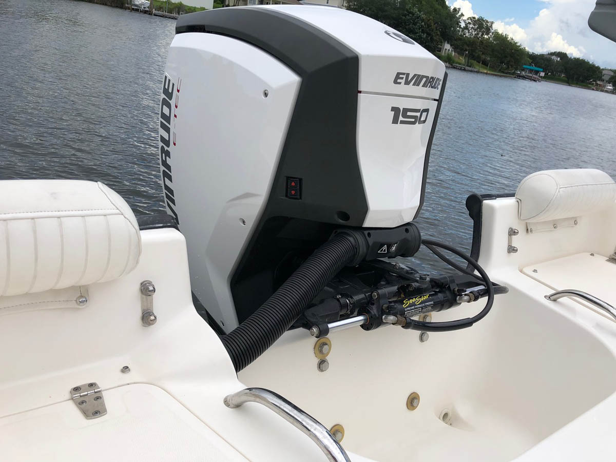

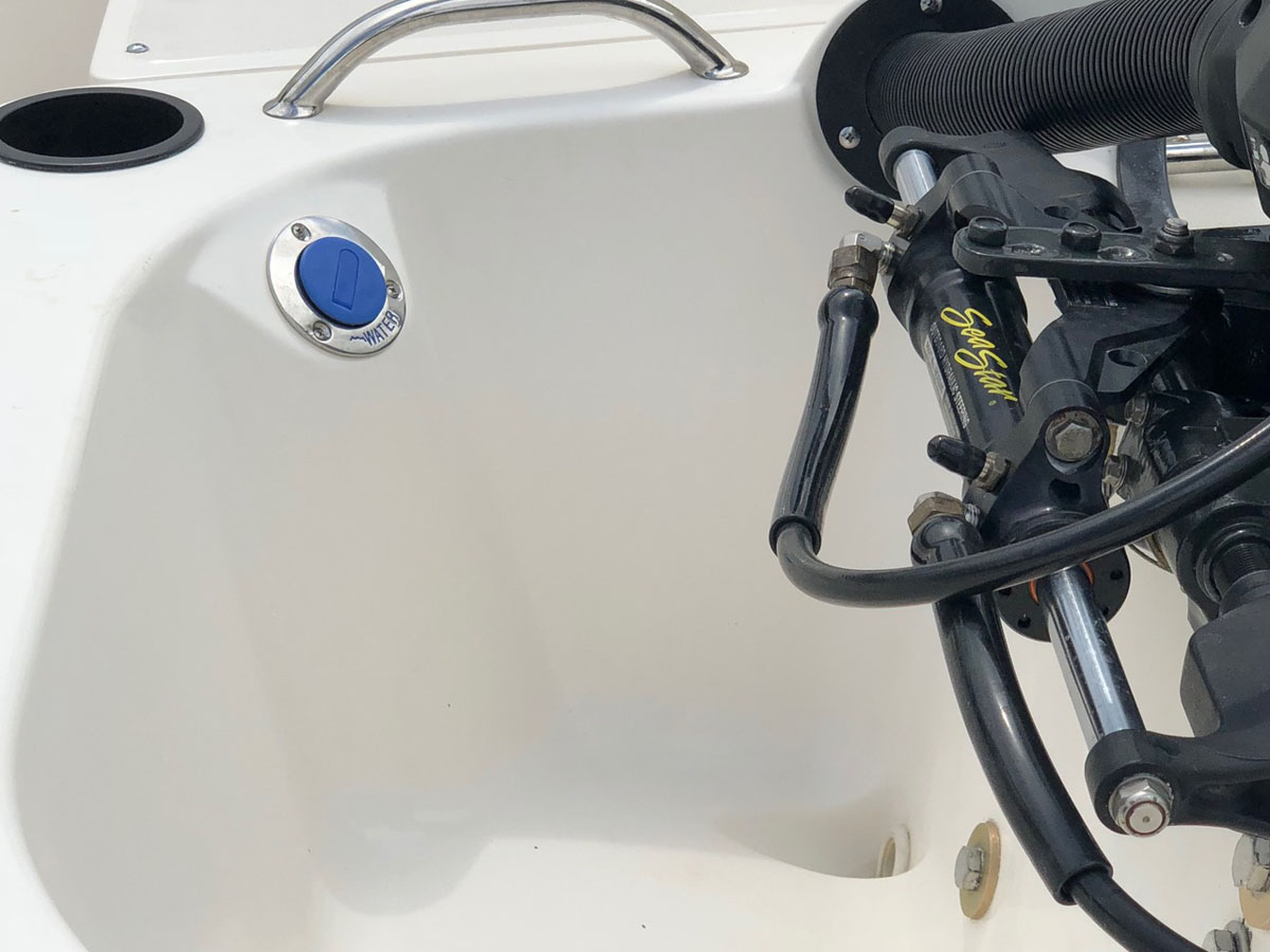

Back to the re-power. The E-TEC G2 150-HP they quoted uses my SeaStar Hydraulic Steering. I was reading that one of the options is to get the built-in steering" called iSteer. Has anyone ever used it? Impressions?

Posts: 13398
Re: 2004 190 Nantucket Re-power
Postby jimh » Thu Jun 07, 2018 11:55 am
Generally the E-TEC G2 engines have internal steering actuators built into their engine mounting, and they do not use an external actuator at all. The steering is hydraulic, and the lines from the hydraulic helm pump are connected to the internal steering actuator. This is called INTEGRATED steering.
There is also an option for variable rate power-assisted steering--actually I think it is mostly standard on the higher-horsepower engines; the power steering is an upgrade that costs about $1,000. The boost pump is also internal, so there is nothing different about the rigging; the helm pump just connects to the hydraulic steering lines on the engine mount. The boost pump is electric and the amount of boost is dynamic, depending on various parameters. This dynamic power-boost steering was initially called DPS and is now called iSTEER or iSteer.
Some of E-TEC G2 2.7-liter engines use a new mid-section and engine mount, called the TRAC+ (pronounced "track plus"). For more information see my earlier article about the TRAC+.
Certain 150-HP and 150 H.O.models are available without the INTEGRATED steering, and use what Evinrude calls REMOTE steering, which is just the normal old-fashioned external hydraulic steering people have been using for decades. Getting an engine with REMOTE steering saves weight (about 23-lbs) and money (I don't know the exact figure). These engines have the TRAC+ mount and midsection.
In summary: three steering options, but not all options on all models:

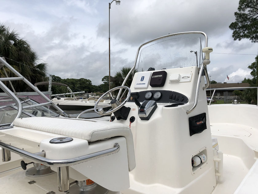

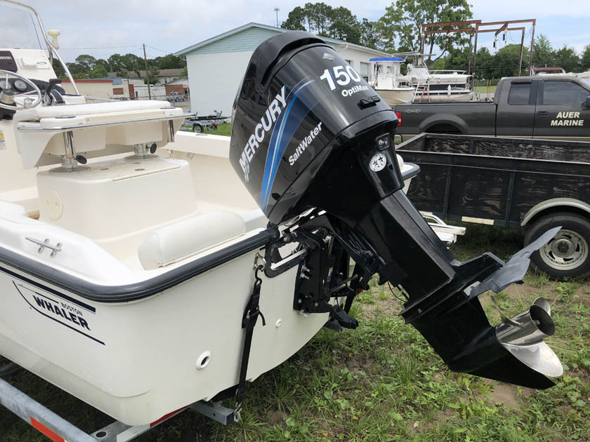

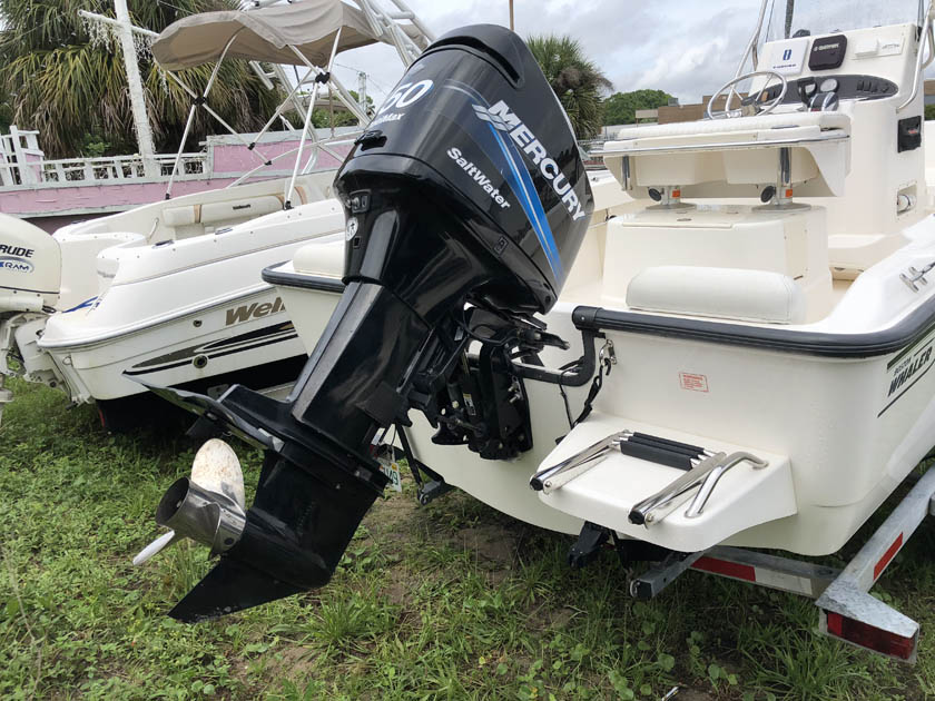

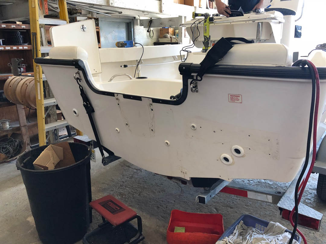

I plan on documenting the re-power in this thread. Here is what we started with.
M
Boat Photos
InVision
Posts: 200

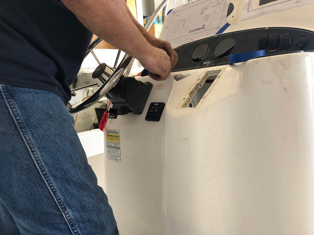

Postby InVision » Tue Jun 19, 2018 5:19 pm

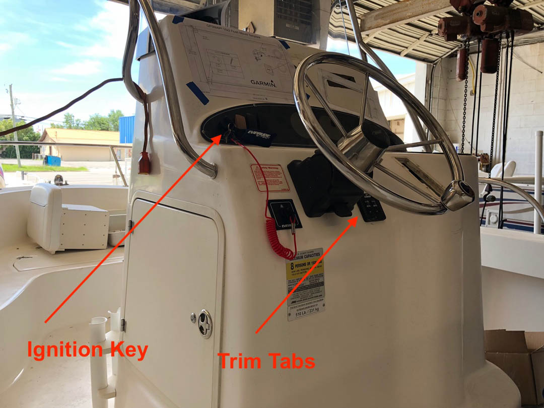

Starting removing console and preparing for new layout.
M
Boat Photos

Postby InVision » Thu Jun 21, 2018 3:55 pm
Boat was completely striped of Optimax. Engine sold for $3700 which helps a bunch on re-power cost. Technician relocated key to Optimax buzzer hole. Mounted trim tab LED control in lanyard hole. Fiberglass guy is up next to fix console and transom. Making room for fresh water tank where oil tank was. I won't be able go down anymore for a week or so... Looking to when I see it in a week or so.
M

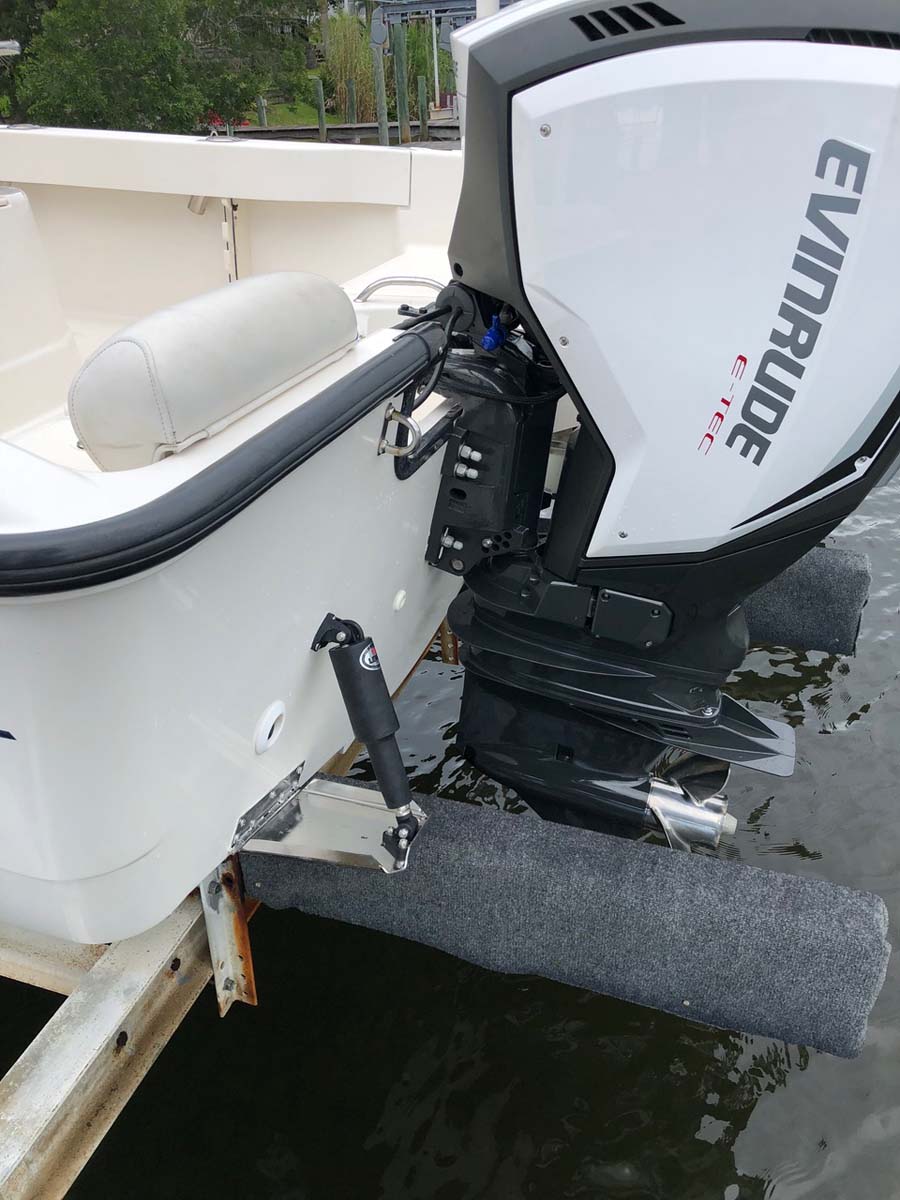

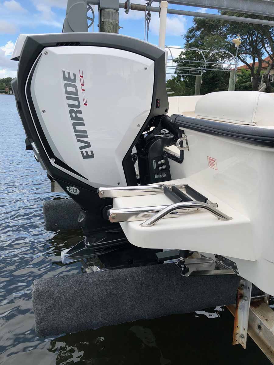

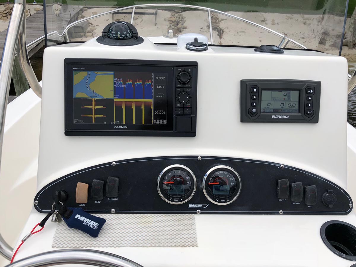

Postby InVision » Tue Jul 03, 2018 5:44 pm

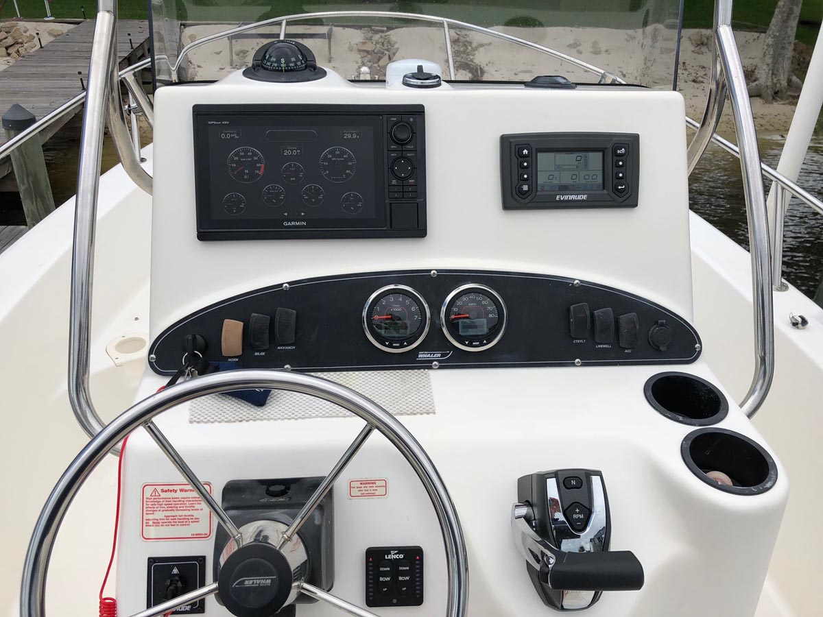

Got boat back today. What a difference a ETEC G2 makes. Quieter all around and shift is like silk. We have 15 mph winds today, 2-3ft whitecaps in bay but I went back in the bayous and she was cruising at 37 mph GPS and getting 5.8 mpg. The trim tabs that Boston Whaler recommends for this boat 9"x9" are really not big enough. Makes some difference but IMHO 12" would have been just right.
Funny thing already happened. A neighbor was cruising by and commented that the new Boston Whalers looking sweet. When I told him it was a 2004 with a new motor he just stared at me with a blank look and said OH...
Power seemed some better and top end was 46-47mph the first wide open test.
I will post some photos. Be glad to hear member thoughts on the re-power.
M
Boat Photos
InVision
Posts: 200

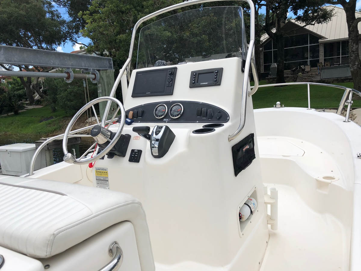

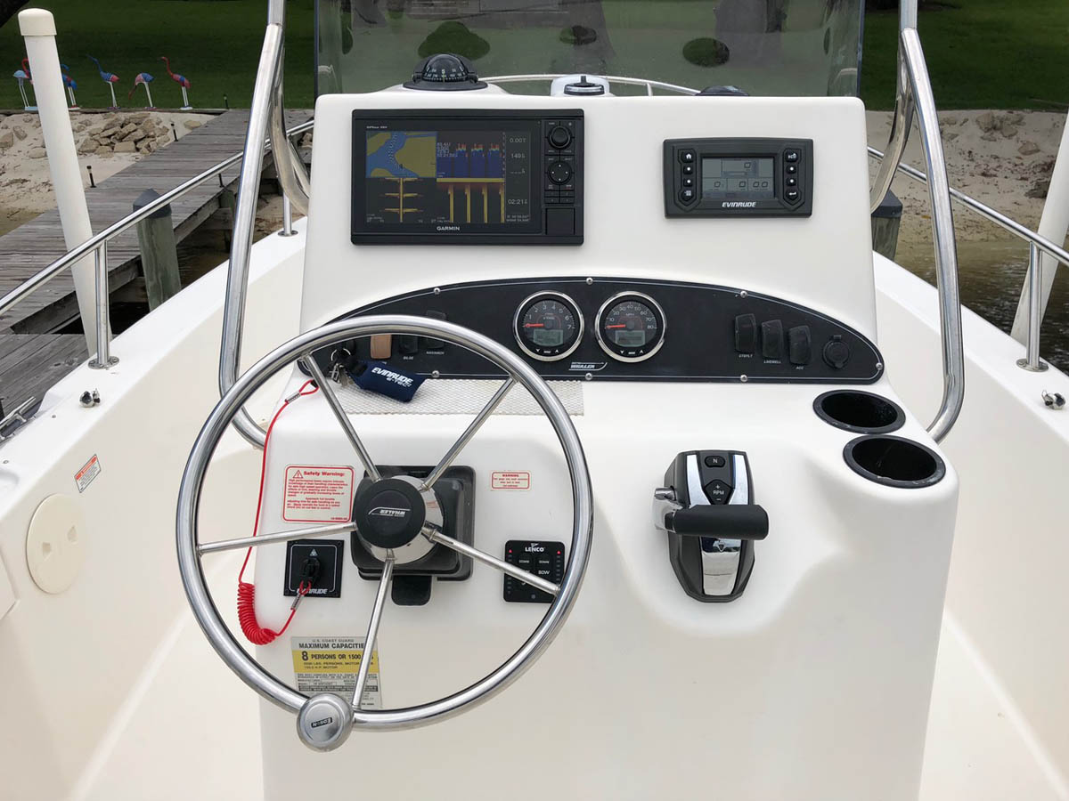

Postby InVision » Tue Jul 03, 2018 5:47 pm
More of console
M
Boat Photos
InVision

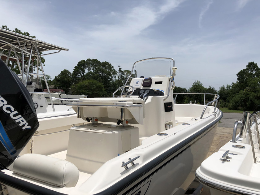

Posts: 200
Postby InVision » Tue Jul 03, 2018 5:48 pm
a couple misc ones...
M
Boat Photos
Postby Phil T » Tue Jul 03, 2018 6:09 pm
InVision -
She looks great.
The gauges and display are nicely done.
When you have time:
What is the mounting height? The set of 3 bolts is a bit deceiving. How many holes up is the second set?
What is the prop? RX4? In what size?
The WOT speed reads a little low. Once you get comfortable do some runs and report back.
Thanks for the photos and following through on the start to finish.
Enjoy!

Posts: 200
Postby InVision » Tue Jul 03, 2018 6:20 pm
The mechanic said [the engine would be mounted], "in the second hole." The three bolts are because the previous owner had a [TurboSwing, a brand of towing bar, mounted]. Mechanic said he would just keep the six bolts.
The prop is a VIPER 14 3/4 x 17-pitch
WOT is exactly 6,000-RPM. Before [the propeller] change [boat speed] was 44-MPH SOG by GNSS. Now [top boat speed is] 46-MPH SOG by GNSS. I have 30 days if I would like to exchange the propeller.
The next [ptich] step is 19-pitch, which would bring engine speed to 5,500-RPM-or-so, which the mechanic said was too low.
I must study propellers.
I am used to Yamaha [engines].
[The boat has] 60-gallons of fuel at the moment.
M

Divin'Ivan
Posts: 61
Joined: Tue May 03, 2016 12:00 pm
Postby Divin'Ivan » Tue Jul 03, 2018 8:36 pm
Very nice man, that engine color looks like it belonged on that Whaler all along. When you get a chance, can you take some pictures of the fresh water tank setup? How big of a tank were you able to fit?

InVision
Posts: 200
Postby InVision » Wed Jul 04, 2018 4:14 am
I have only prepared for fresh water bladder. Installed water filler where oil tank fill was and ran wire from the accessory switch. Kind of an odd space so taking my time.
M

Posts: 13398
Postby jimh » Wed Jul 04, 2018 9:40 am
InVision wrote:The mechanic said [the engine would be mounted], "in the second hole."
Clearly that mechanic has not read our policy on how engine mounting height is to be described. Based on the images provided, the engine has been mounted one-hole-up. :-)
I like the color choice you made for the E-TEC G2 cowling panels. The engine colors are very good with the boat colors, and the style of the G2 looks at home on that transom.

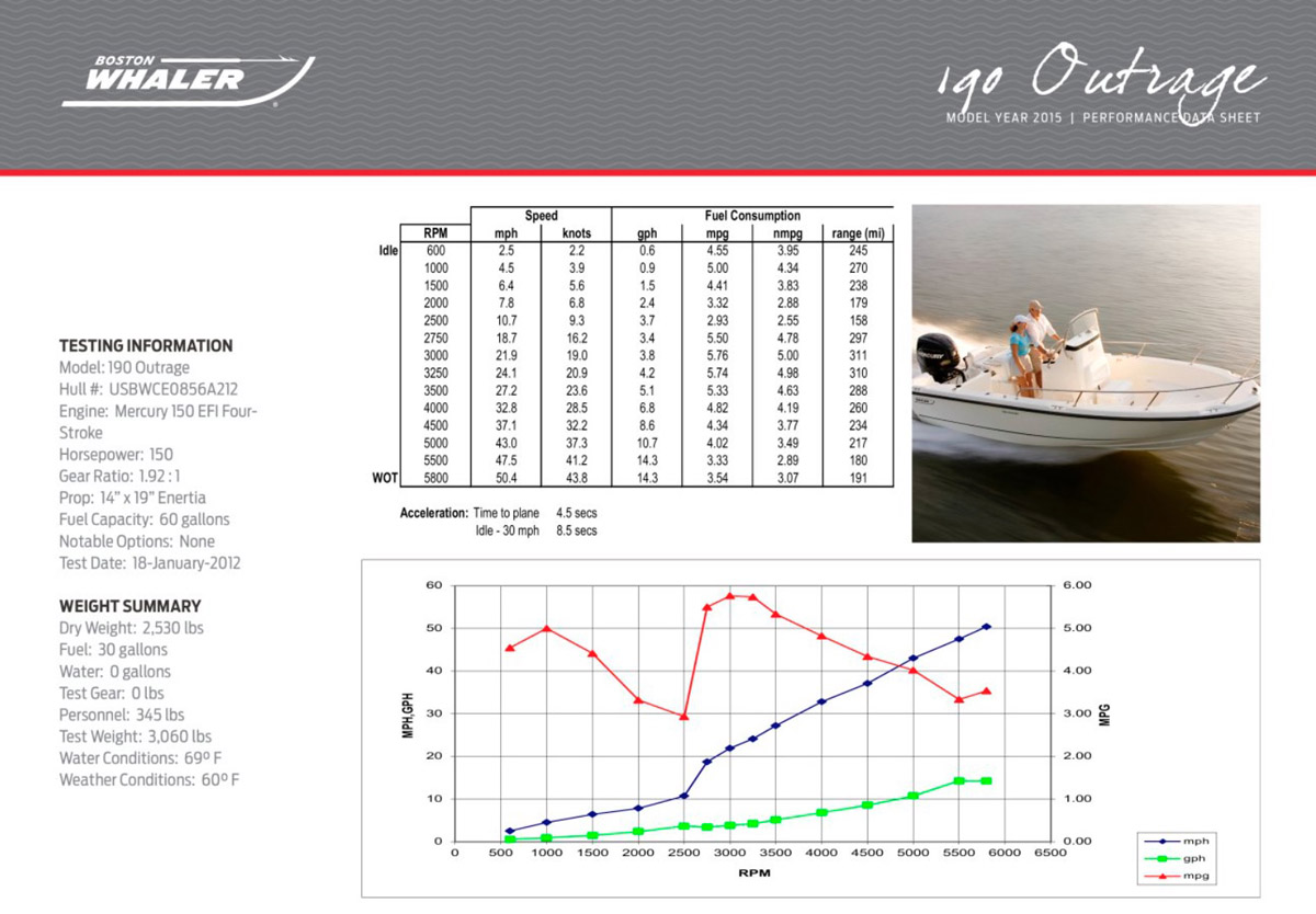

Thanks Phil. So would not a 4 blade drop my WOT speed? A four blade in 19P is quite a difference. Experience says when going with 4 blade you should drop pitch one from a 3 blade pitch. RX4 write-ups say that it is made for ETEC G2. All in all props are a black science to me.
What is the WOT in MPH of a 150 HP on a Outrage 190?
M
Boat Photos
Postby Phil T » Thu Jul 05, 2018 11:59 am
M--as many members have learned, propeller testing takes a fair amount of effort, back and forth running, swapping out, and so on. Outcomes tend to be dependent on what propellers dealers have and their lending policies.
I was looking at that same performance report when I said I thought you should be able to hit 50-MPH at WOT.
The RX4 prop recommendation came from Lockman's, a BPR dealer and the one's that did Pat's (aka Homeside) re-power. They are highly respected.
I do agree with dropping pitch when going to to a four-blade propeller. If the dealer has the RX4 in stock, start with 17-pitch.
