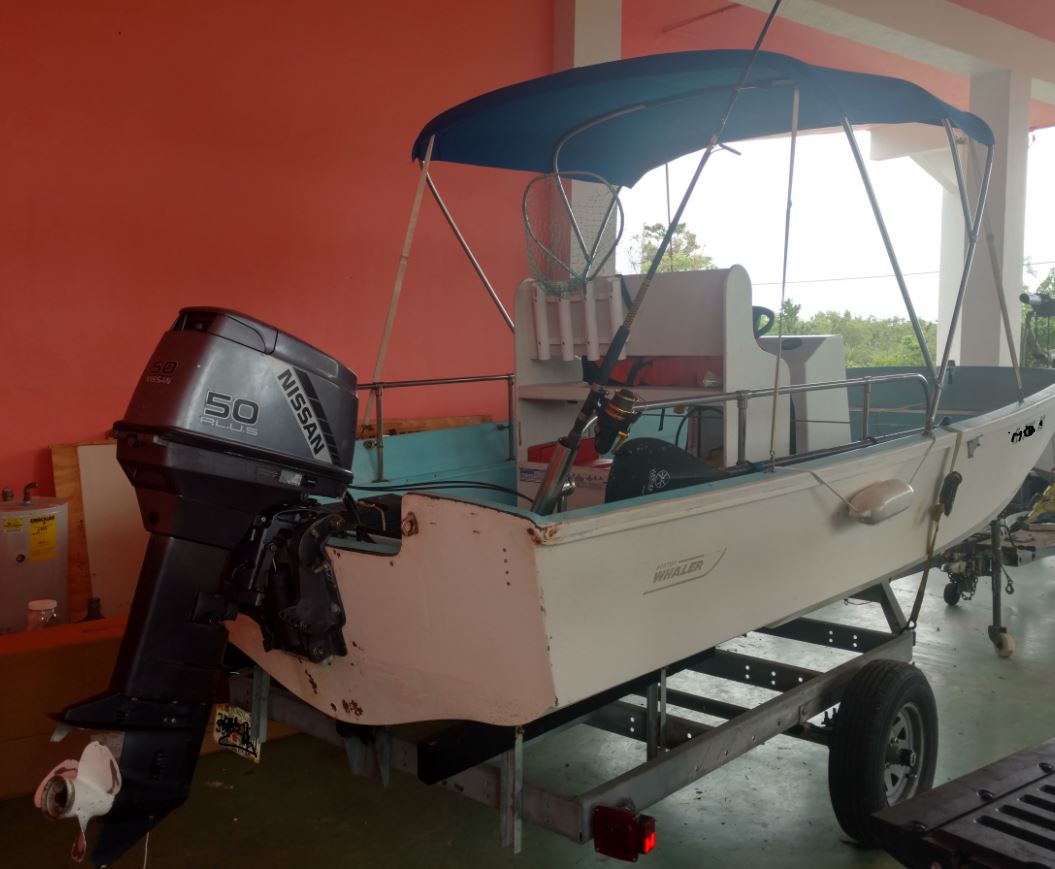

I have a 1965 Classic 16 with a 2000 NISSAN 50-HP Model NS50D2 two-stroke-power-cycle engine using a stock propeller. The engine weighs about 180-lbs. I just had it out on the water the other day and [the boat] ran perfectly - but I think there is some room for improvement in speed and economy. This is a great little set up and I'd like to get the most out of it.
[The boat speed] topped out at about 30-31 MPH, engine speed was 5200-5300 RPM trimmed out. Maximum RPM per the manual is 5150 to 5850 RPM. I'd like to get to about 5500.
The engine seems to be mounted a little low. I'm thinking I could raise it about an inch or two up using current mounting holes. On top of that, I want to upgrade to a stainless steel propeller or a better propeller that would provide more performance.

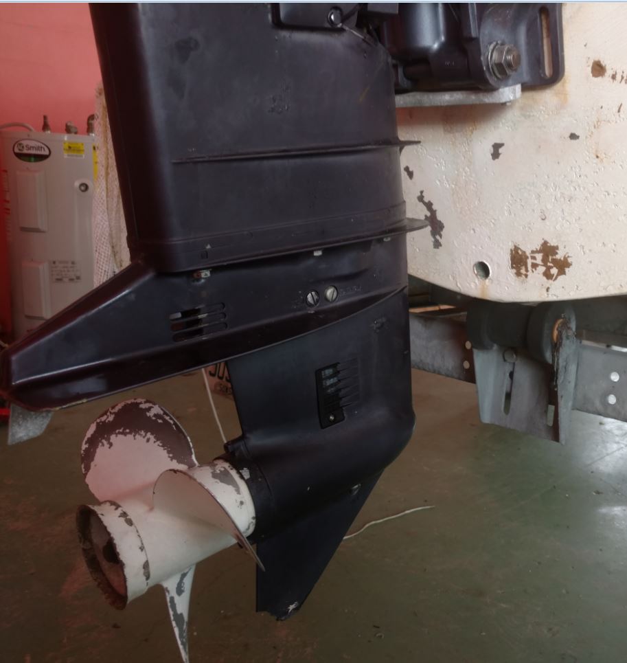

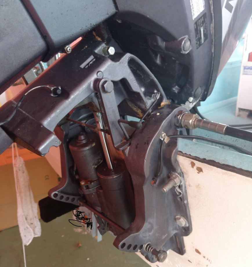

I understand I have half the rated horsepower on the boat, but I think the benefits of having a light engine on this non-smirked hull are severely overlooked. This boat handles great and feels well balanced. I can cruise at 25-MPH all day, which honestly, unless the sea is flat calm, is plenty fast. At this point I'm looking to maximize handling and efficiency while reducing draft.
I can only raise the motor one hole up using existing mounting bolts; see the picture. I will do that this weekend. Do you need a engine lift? Or do you use the trailer jack to raise and lower the engine mounting height?

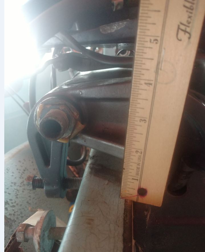

I was able to raise the motor this weekend. Take a look at the pictures and let me know if this seems right. It was raised just about 1.5 inches. I was not able to use the top mounting holes, so I will either have to fill them up and drill new ones, or test using the outboard clamps. The bottom of the bracket is through bolted.

Make sure you have those holes sealed of preventing water from entering your transom.
