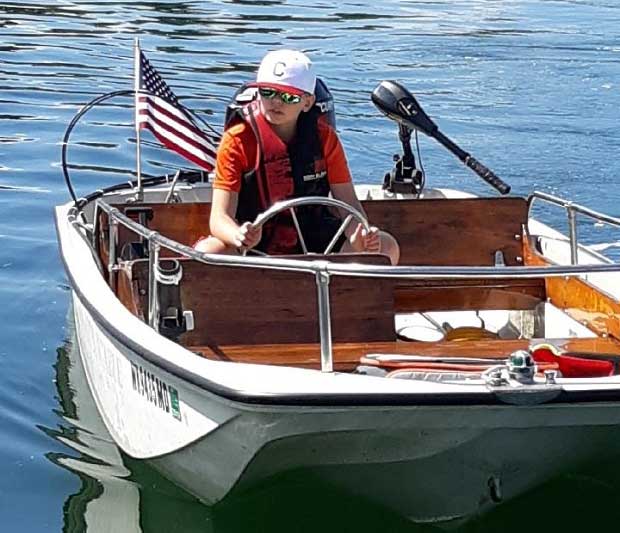

The restoration of a 1988 [SUPER SPORT 13] is finished, and the boat now has a 2004 9.9-HP BIGFOOT engine with electric start, a battery, remote steering, and a 6-gallon fuel tank. The original four-cylinder 40-HP two-stroke-power-cycle engine has been removed; it was too much power for an 11-year-old to operate.
The 9.9-HP BIGFOOT propeller is 10-3/8 x 9.5-pitch. The maximum engine speed is now too low, only 2,400-RPM, and boat speed is only 9.4-MPH. That was with with myself (220-lbs) and my son (104-lbs). With just my son the boat accelerated to 13.2-MPH, which almost calculates to a propeller SLIP = 0.
The current propeller looks like a big, flat, pusher. I believe a lot of [engine speed] is being lost.
The engine propeller shaft has 10 splines, which limits propeller choices.. I plan to get a propeller with smaller diameter.
[Discussion about carburetor changes to increase power are now in their own thread.--jimh]
Readers: give me any thoughts you have [about the proposed change in propeller diameter]?
I am out of my comfort zone in choosing a propeller for this small engine.
