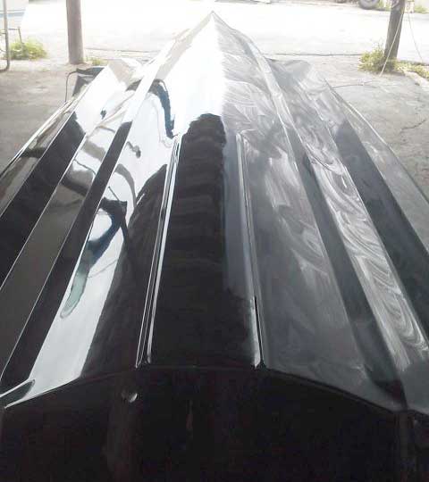

a user ("Bowser") described the addition of new strakes on the hull bottom and the extension of the runners on his classic 15-foot hull. He provided this image:
Fig. 1. Bottom of Boston Whaler classic 15-foot hull modified to extend runners and add strakes.
The original comments stated:
I think this picture shows best what we did to stabilize the hull. We stretched the lower strakes to the back and instead of building a pad we put [two] runners in the center that work as a virtual pad without effecting the ride depth. ...[W]e have confidence...that the design will work without a hitch...had it out this weekend and...it felt very stable....
It is also noted in the thread that the user "Bowser" is the owner of IMAGE MARINE. On a social media website the telephone number is listed as (727) 612-1805. You may be able to communicate with him via telephone about the outcome of the modification. He also comments later in another discussion that the boat was "Stable as a surgeon's hand."
The entire thread should be read as it has many interesting comments about the 15-foot hull, its design, and modifications to improve stability at high speeds.
