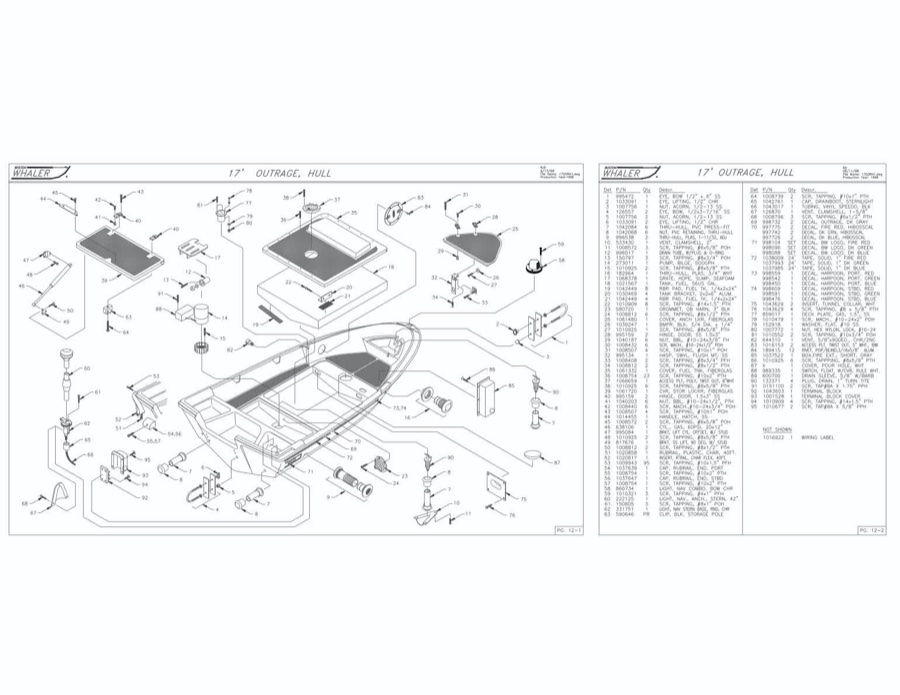

Postby Phil T » Mon Sep 28, 2020 12:12 pm
There is a drain tube or through hull drain, labeled #7 and #8 under both rear quarter seats as shown in the diagram attached below.
