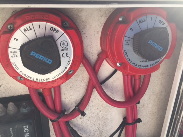

It occurs to me, after owning my [2001 Boston Whaler OUTRAGE 26] boat [with twin Mercury OptiMax 225-HP engines] for five years, that I don’t understand the battery system operation at all (I guess I just had my head in the sand since nothing had gone wrong so far). After we had a dead battery, I looked at the warning on the battery switch door; it says never operate in parallel--which I’ve done maybe 100 times since we’ve owned the boat.
I’ve always just set both [battery switches] to “All” [and this] has never caused a [problem]. This advice came from a guy we hired to go out with us when we first got the boat, so the warning is bad or we’ve been super lucky. I always assumed--I know--that the Port [battery] powered the Port [engine] and the Starboard [battery powered] the Starboard [engine], and the alternator would charge both [batteries] when the engines were running.
We ran the batteries to the point to where they were dead by listening to music and accidentally leaving a water pump on the other day. We needed a jump which made me think about how the system should work. We’ve never had a [problem]--despite the bilge pump being run all winter in this El-Niño year--with just adding a solar panel hooked to each [battery].
I will now set the switches to the correct position going forward but I still don’t understand it:
--accessories seem to work only off of the starboard battery
--should I always set to "ALL" when starting? And then [change the battery switches to] the 1 and 2 positions when running?
--should I then turn off the port battery to make sure I can start if anchored for a while?
--charging just the first battery will allow [engine starting], and I assume that’s because they are hooked up in-line?
I guess I’m lucky not to have gotten into more trouble so far. In any case I think I need two new batteries, but that will be a good starting point to do this better.
Thanks

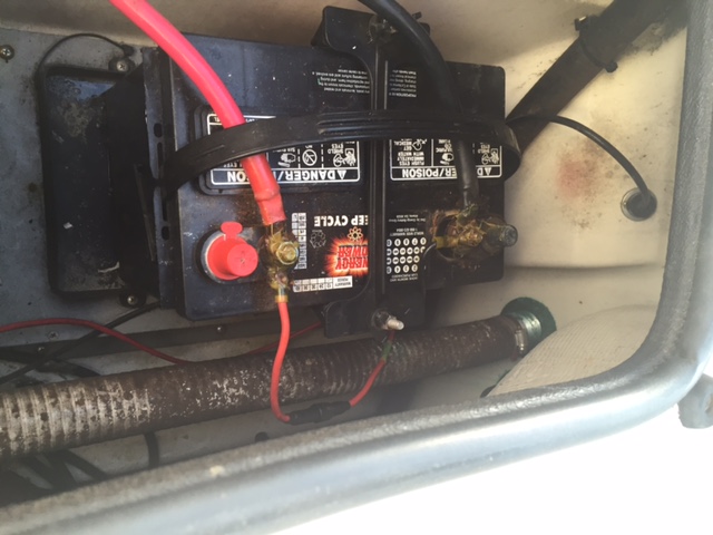

The battery shown in your image looks like the connections are in sad condition.

Re the wiring shown around the two battery switches in your image (above):
My inference is that someone has been fiddling around with the wiring. Boston Whaler would NEVER have left all those nylon wire wraps with cut-offs that make little knife-edges waiting to rip off your skin. Boston Whaler would NOT have have wire with BLACK insulation connected to the POSITIVE circuitry of those switches.
This is somewhat typical for boats. Once they leave the factory the electrical wiring becomes a mess of haywire and owner-added or dealer-added circuits.

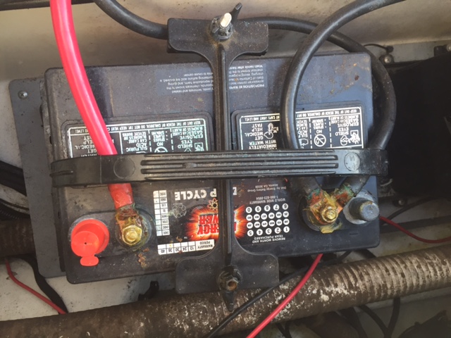

Jim, thanks very much. That helps. Here is the other battery if that helps any. Yes the connections have a lot of grease around them. I've not had any electrical work done to it since we bought it and have only replaced a couple of water pumps and the VHF but hooked that up to the wiring that was already there. The batteries were replaced while back by the local merc dealer but we've kept it on the water in SF Bay so kind of a nasty environment...

If the pictures show grease on the terminals, then that's good. To me it looked like corrosion. But grease is better than corrosion. In a saltwater environment it will be hard to keep corrosion at bay. Check with a local boat yard to see what they recommend--maybe grease is the best method.
I recommend checking each engine separately to see if the engine is properly charging the battery. When you run them all connected in common, one of the charging circuits can be damaged by the other. A quick check:
--measure the battery terminal voltage when the engine is not running; it should be around 12.7-Volts if the battery is in a full charge state or close to it;
--start the engine associated with that battery; run the engine at a fast idle speed;
--measure the battery terminal voltage with the engine running at fast idle; it should be above 13.0-Volts, perhaps as much as 14.0-Volts; this indicates the engine is delivering charging current to the battery.
As long as you see the battery terminal voltage rise when the engine is running from the non-running voltage, you can assume there is charging taking place. If the voltages are not exactly what I mentioned, don't worry, unless they are very much higher or lower.

I notice that the two batteries are both labeled "DEEP CYCLE." A battery of that type is not really designed for engine cranking. To use a deep cycle battery for engine cranking one usually has to get a larger battery--both larger physically and one with more capacity--than would be needed if you used a engine-starting battery.
Check the Mercury owner's manual for the OptiMax engines to see what size battery is recommended; look for the specification of Marine Cranking Amperes or MCA. Usually a big V6 outboard will specify a battery with an MCA rating of over 800-Amperes, and as high as 1,000-Amperes.
To get an MCA rating of 1,000-Amperes in a deep-cycle battery usually requires a really large battery.
Also, OptiMax engines are fussy about their battery power. They do not like to run on a weak battery.
When a battery is discharged completely, particularly an older battery, there is always a loss of capacity that will never be restored completely by recharging. Avoid running down the batteries to low state of charge. It is better to only discharge the batteries to, say, 80-percent charge, then re-charge them.
