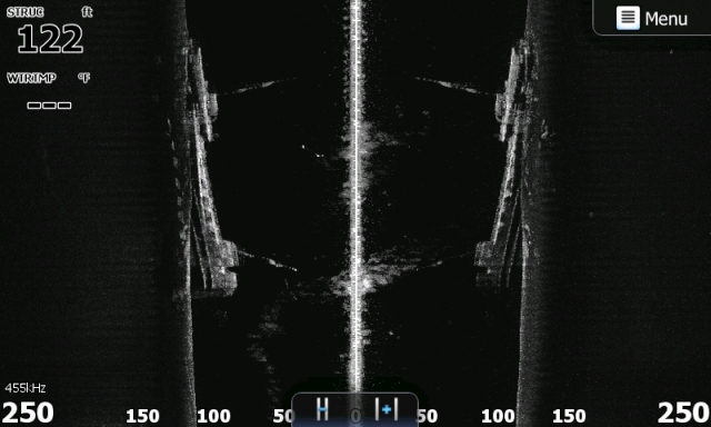

Don't give up on side scan just yet. Here's what I got recently:
shot 008.png (215.14 KiB) Viewed 58711 times

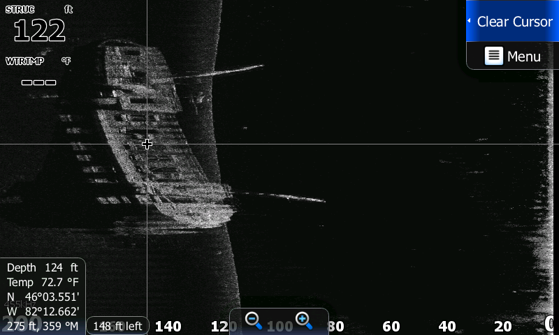

That's pretty good Don, and better then what I have gotten so far. I have another screen shot to add later, almost looks like a boat.
So, the secret location is out :-)
Estimating size at 200 x 40, is that the Northwind?

Duane--I've found that practice helped. Also slowing down to bare idle will paint the target in side scan mode longer.
Regards - Don

The SONAR image posted by Don are from the NORTHWIND which wrecked on ROBERTSON ROCK in 1926. Compare the images with an old picture of the ship at
http://dansdiveshop.ca/trips-events/div ... northwind/
I find that side scan SONAR image to be just amazing. I have sailed past Robertson Rock dozens of times. I had no idea what was down there. It looks to be in amazing condition.
