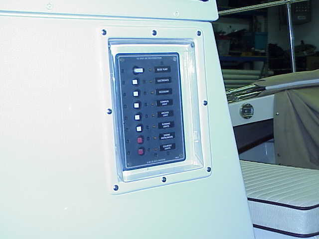

I want to install a VHF Marine Band radio, a chart plotter, and a SONAR, as well as an audio system. What parts will I need to do this re-wire?
Should I stick with one dual purpose battery and have that run all of my electronics as well, or should I install a starter battery and a deep cycle battery?
Beyond the runs of wire and connectors, what other equipment do I need?
A battery switch?
A new fuse box?
A new power bus negative or positive?
I'm not overly sure what the difference is between a fuse box and a bus. I'm sure the inclusion of fuses is a main differentiating factor, but I am not sure why one would use a bus over a fuse box.
Anything else?
Thanks again for your insight and suggestions.
The backstory: I wish to price a re-wire of my 1989 Montauk 17. I have had electrical problems with the [combined sidelight lamp] on the boat since I bought the boat. I have concluded that the most likely [cause of the problem] is the corrosion of the wiring to the lamp. I called up a buddy of mine who is an electrician and asked him to re-run those wires. I also just purchased a used [white all-round lamp]. I figured I would ask him to hook-up and check the wiring for the [white all-round lamp] while he was there. Then I started thinking: If the electrician is coming out to re-run the [wiring to the bow] and to hook up the [white all-round land], why don't I just ask him to rewire the entire boat? Costs might be the reason to not do the re-wire, and that is where I need your advice.
The battery is currently under the reversible pilot seat (RPS). I don't like it there. I have plans to put a new fuel tank under the RPS, so I would like to move the battery. My first thought was to move the battery back to the stern. I would get a new battery box and strap it down at the stern. Then, I started reading more about putting the battery in the console. I know the owners' manual said not to do this. I did a search of this forum for "move battery from console to stern", and I didn't get any hits. However, I did get a ton of hits for moving the battery from the stern to the console.
If I am going to move the battery to the console, I will and should run new wires from the battery to the engine.

I think that your making an excellent decision in considering a total rewire of a 25-year-old boat, especially if it's spend considerable time in saltwater or if it's gone through multiple owners. Some owners (or installers) think nothing of using low-grade speaker wire and cheap automotive connectors or worse yet, AC wiring parts and connectors.
You've already alluded to one of three main questions; one battery vs two, and inside the console or not. The third is re-wiring with fuses vs a circuit breaker panel (and if going with a breaker panel, how many circuits, back lighted or not, waterproof or under a cover, etc...). Do you want to maintain the classic look with the standard cylindrical fuses?
I can only speak from experience; almost all my Whalers either came with two, or I installed two, in the console. There was some concern regarding the off-gassing of the console mounted battery that could collect within the console. I don't think a standard Montauk console is that airtight to make this a concern.
Number of points:
--If you go the console route, best to cut open the console floor to allow the battery box to sit directly on the deck You'll have to reinforce the floor, as the console floor brackets are not strong enough to hold a battery. BTDT.... Added benefit is additional cubic inches gained with the batteries almost flush with the console floor.
--Seriously consider installing a battery switch.
--Stick with marine grade wiring and connectors. Blue Sea is a product line that a number of forum members have used and recommended.
--Don't tape a connection, either crimp or for a really secure connect, solder and crimp. Some of the best Blue Sea crimp connectors allow for heat shrinking of the splice connector.

My breaker panel has eight circuits: running lights, anchor light, compass, electronics, bilge pump, courtesy lights, instruments, spare.

Circuit breaker panel inside the console is hard to get to, I'd recommend a waterproof outside, either on dash or side mount.
You could probably combine the VHF, sounder, GPS, and audio system on one circuit, labelled "Electronics", to save space.
Don't need a deep cycle, just a second battery, with primary battery switch like Jim's.

For small boat electrical power, using circuit breakers adds a lot of expense. Circuit breakers are typically not designed to work as circuit power control devices. If you want to use a circuit breaker as a power control device, like a switch, you have to buy specialty circuit breakers. If you want them to be exposed to weather, you have to buy specialty circuit breakers.
A much simpler, much less expensive approach for distribution of power on a small boat and control of the power is to use fuses and switches. The fuses are located on a central power distribution panel and kept protected from weather. The switches are on your helm dashboard and are designed to be operated thousands of times and to be exposed to weather.
I do not recommend trying to fit a big-yacht approach to electrical system design onto a 17-foot open boat.
