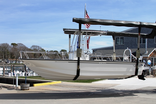

That's my 2013 210 Montauk when delivered! I see my wife and a dog in the pictire.
The front deck is pretty big. Four people can hang out easily. I sometime get out Moriches Inlet in Long Island for Seabass fishing, but it's quite stable. I installed a pair of Bennett Bolt 12 x 9 trim tabs, and they make a big difference in choppy water.

Postby jimh » Sun Aug 06, 2017 10:42 pm
RINOUE--I see you posted several images of your 210 MONTAUK to THT in 2014. I like this one better to show the hull form:

Re: 210 MONTAUK v. Classic OUTRAGE 22
Postby jimh » Tue Aug 08, 2017 6:15 pm
I'd like to see a view of the transom of the 210 MONTAUK (out of the water) from directly astern, so the hull bottom shape can be better seen. From the images shown so far, I am beginning to think there is more of a V-hull on that boat than I suspect.
