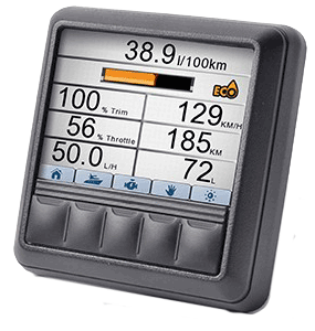

OTHER DISPLAYS
In addition to the ICON Touch 7.0 CTS touch display, there are also the ICON Touch 4.3-inch color touch display and a ICON 3.5C color display.
ICON TOUCH 4.3 CTS
Evinrude ICON Touch 4.3 CTS
The ICON Touch 4.3 CTS display is a smaller version of the 7.0 model. It works with one or two E-TEC engines, up to four fuel tanks, and with one additional water or fluid tank. The user guide is available on-line:
ICON Touch 4.3 CTS Display User Guide 2015
https://www.operatorsguides.brp.com/pub ... Guide=8717
ICON Touch 4.3 CTS Display User Guide 2018
https://www.operatorsguides.brp.com/pub ... Guide=8718
ICON 3.5 CS
Evinrude ICON 3.5 CS
The ICON 3.5C color display can mount in the standard tachometer gauge hole, and can only be used with single engine installations. It supports two fuel tanks and one additional water or other fluid tank. The display is not a touch-screen. The user interface is provided by five physical buttons below the display. The user guide is available on-line:
ICON 3.5C Display User Guide
http://www.operatorsguides.brp.com/Oper ... 762_EN.pdf
