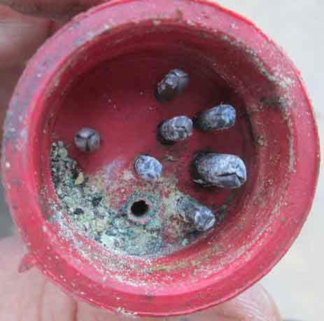

Pictures of that red connector at the back of the powerhead indicate an open circuit due to excessive corrosion.
https://scontent-iad3-1.xx.fbcdn.net/v/ ... e=5A6A281D
https://scontent-iad3-1.xx.fbcdn.net/v/ ... e=5A7A1D42
Can these connections be "pushed out," cleaned and/or replaced individually or do I have to replace the entire thing?
What are these type of male connectors called?
Not so proficient in electrical stuff even though I took (2) semester of physics in college.
P.S. I think it's time for a complete look at all the similar "connections" in the engine loom so I can be confident that I don't have to turn into a "mechanic on the water." I don't understand why these connectors are not protected by dielectric grease?
Bob

IMHO I would replace the connector. Then I would apply corrosion-X to both sides before connecting.
M

Red plug culprit. This should be an annual maint item to disconnect, inspect and put corrosion block on the pins.
That plug is part of the harness and if it were my motor, I would clean up what is left and continue using that plug. I would also tap into the missing pin where the wires go into the plug and install a male/female jumper around it (simply bypass for that circuit). That's the simplest repair short of replacement.
Or buy a used one. https://www.ebay.com/itm/1992-1996-Johnson-Evinrude-Motor-Cable-Wiring-Harness-584401-50-60-65-70-HP-/362050194268?epid=1022082438&hash=item544bdf8b5c:g:NJQAAOSwiX5Zd6Y5&vxp=mtr
You can clean the plug with CocaCola (it contains phosphoric acid) and a toothbrush.

I cleaned-up the connector plug, installed a NEW male connector and cleaned-up the existing female. Still sounding alarm/horn continuously. WTF?!!!

dtmackey wrote:Red plug culprit. I would also tap into the missing pin where the wires go into the plug and install a male/female jumper around it (simply bypass for that circuit). That's the simplest repair short of replacement.
I removed/pushed-out the individual wire from the male-side of the plug, as all the wires are in plain view. However, the female part is configured like a regular "house" wire; no wires showing but just a black sheath. I would have to slice that with a razor knife in order to get the other wire out. Is that what should do? Rig the workaround wire, tape the rest up and leave it alone before reconnecting everything to test the horn problem?
Bob

I would hardwire that circuit around the plug.
Once you start hacking the red plug with a razor blade you might as well abandon the whole plug.

I know but I have to cut the one side in order to see where the female wire end is. There's no other option in order to get the wire out.

OK, you didn't cut the connector like I was thinking and it's still good. You could also do the same to the other side and then take an ohm meter and testing each leg of the connector.

DISCUS' should be very concerned about the red [Amphenol multi-pole] plug. If a wire in the plug is not making contact you might not get a warning signal that might alert you to a serious situation on your motor.

Regarding how to improve the connections in an electrical connector like the large, circular, red, rubber-body Amphenol multi-pole connector used by Evinrude on their engine electrical harnesses to connect to the remote controls until the introduction of the MWS system in c.1996:
The mating of these large rubber body connectors will be made much easier if you apply some alcohol to the rubber bodies of the two connectors. Wetting the rubber slightly with alcohol will allow the connectors to be mated with much less difficulty than if both are dry, and the alcohol evaporates away a few moments later. Do not use alcohol that is diluted in water; looking for isopropyl (rubbing) alcohol that is at least 70-percent alcohol.
Also, I would NEVER use a carbonated soda beverage as a contact cleaner for electrical contacts, except as a last resort in an emergency. The electrical contacts in the Evinrude Amphenol connector are silver-plated. You should be able to restore good conductivity to them by using a spray application of WD40, wetting the contacts, then shaking off the excess WD40. The engine shut-off circuit for the safety lanyard switch is one of the conductors in this contact; this circuit carries several hundred volts, so do not energize the circuit when the contacts are still wet with WD40. You just want a film of WD40 on the actual contact surfaces, not puddles of it in the connector housing. In a case of extreme corrosion of the electrical contacts, I would attempt to burnish the surfaces of the male contacts (pins) by careful wet-sanding with WD40 and extremely fine emery cloth.
Do not apply gobs of grease sold as dielectric grease to the contacts or the connector body. The connector body will make its own tight seal, rubber on rubber, and does not need grease. Use alcohol as I described above to help mate the connector. Please note that dielectric grease is an excellent insulator; it has no conductivity. It cannot improve electrical current flow. It should never be applied to any electrical contact. Dielectric grease is only used with some connectors as a lubricant and sealant for the connector body surfaces that have to contact other connector body surfaces. A very thin coating of grease is sometimes recommended for certain connectors. It should not be applied directly to any electrical contacts.
In the case of the connector shown in linked images (above), that connector shows a greenish-blue corrosion that is typical for oxidized copper. The connector is in bad condition. It appears that there is a male contact missing.
The individual contacts in the connector body can be removed. They load into the connector body from the rear. Generally a specialized small tool is used to aid in removal of such contacts. The tool can take the form of a circular tube that is pushed over the male contact, into the body of the connector, where it pushed down on the latching spring of the contact, allowing the contact to be pulled out from the rear. Check with an older OMC dealer for advice on how to service the connector.
It is also possible to eliminate the connector completely, and just fashion your own interconnection for the circuits involved. You could use something as simple as single-conductor connectors to connect the several circuits individually to their appropriate other circuit. For example, you could use something like the ones seen at this resource:
http://www.cycleterminal.com/bullet-connectors.html
Or, you could buy all new terminals for the Amphenol connector, and recreate the original connector. I don't know of an aftermarket source for those connector parts. Check with your OMC dealer to see if the parts are still available from Evinrude. Or you might find an old engine that has been scrapped for parts and harvest its electrical harness.
I illustrate the large circular red rubber-body Amphenol connector in an article in REFERENCE that discusses ignition switch wiring. Here is the illustration from that article:

I cleaned the big, red plug up with PB Blaster (which pretty much dissolved the corrosion) along with a wire brush, followed by "rinsing" with Brake Cleaner to dry things up. I only had one circuit which was determined to be defective post-cleaning: the male contact had corroded to the point where it had broken off inside the female receptor, but I was able to remove it. That was the red wire with violet stripe. I pushed the lead back out of the plug, reinstalled a new male end, and persuaded it back into the plug in its original position. I added some dielectric grease inside of the plug (i.e., on the female side, as well as along the point where they join together to prevent saltwater intrusion).

Re: 1996 Evinrude 70 hp: Alarm Horn
Postby jimh » Sat Oct 21, 2017 10:18 am
Here are the BEFORE pictures:
DId you take any AFTER pictures?
