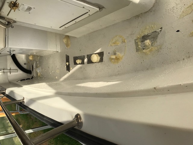

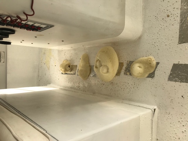

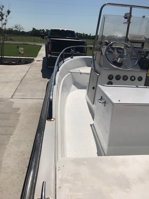

So having just finished six weeks of cleanup, gelcoat, repainting the motor, and refinishing the tub floor, and then running it on the water to make sure everything was fine. then taking it to Canada (which started us on the path of the inner hull). Here's some PIX of what she looked like four weeks ago,
- IMG_0292.JPG (70.58 KiB) Viewed 19317 times
- IMG_0295.JPG (79.45 KiB) Viewed 19317 times
- Screen Shot 2018-06-30 at 2.58.13 PM.png (146.33 KiB) Viewed 19317 times

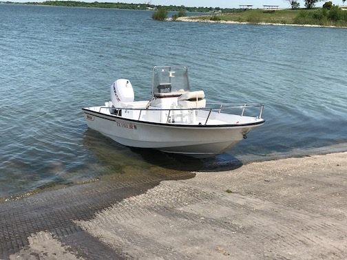

Re: Inner Hull Foam Repair
And Here's the state she's in right now.
- IMG_0410.jpg (80.45 KiB) Viewed 19316 times
- IMG_0411.jpg (72.56 KiB) Viewed 19316 times
- IMG_0412.jpg (70.06 KiB) Viewed 19316 times

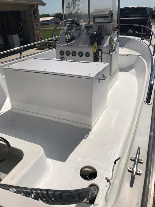

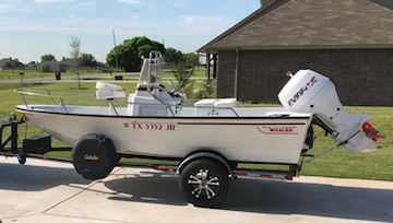

And the goal is to get her back to looking like this!
- IMG_0284.JPG (91.73 KiB) Viewed 19316 times
- IMG_0285.JPG (81.91 KiB) Viewed 19316 times
- IMG_0286.JPG (54 KiB) Viewed 19316 times

I count 47 drill holes on average 8-inches apart. I used four tubes of the INJECTADECK which is supposed to fill a 30-foot-square area 1-inch-deep per tube.By the calculations I used 10-cubic-feet of foam, with maybe 0.5-cubic-feet of waste that came out.
If I guess that the hull below the deck is 10-feet x 5-feet x 0.5-feet deep as an average--it changes withe the length of the hull--that would mean 25-cubic feet. I replaced roughly 40-percent (or more) of the inner hull foam in 30 minutes, after prep time.
WOW.
If you are going to do this, get the "Franchise Kit" which has six tubes. More updates tomorrow.
WOW.

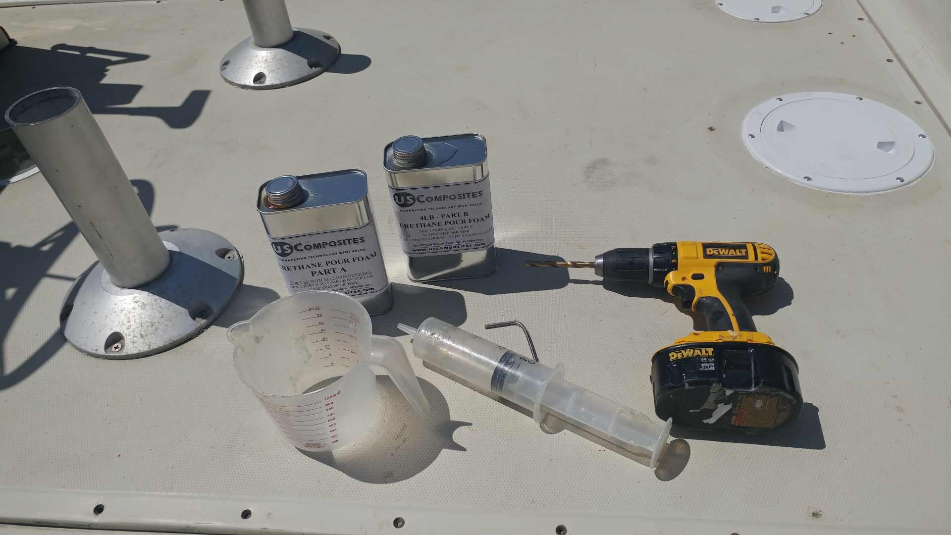

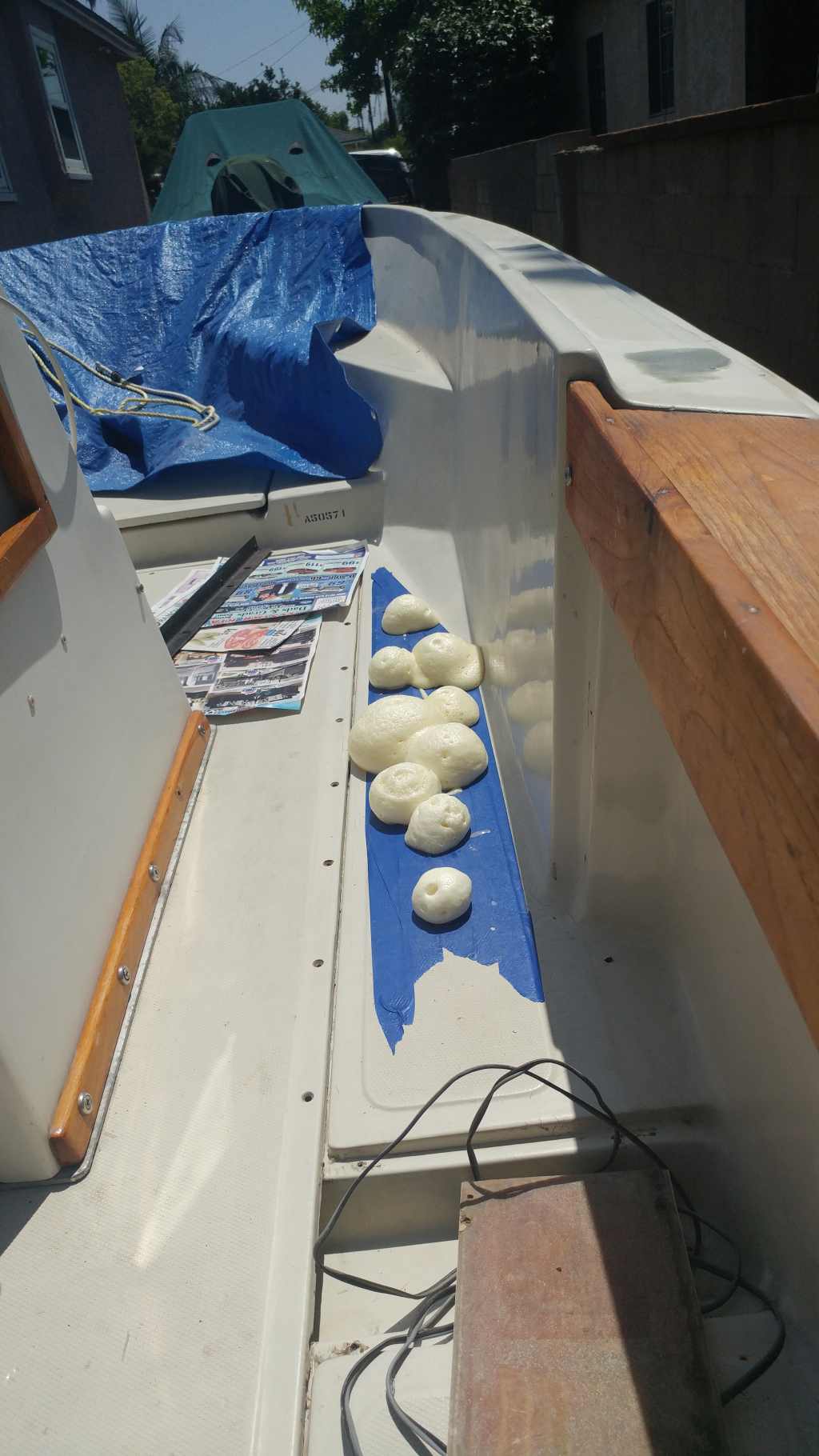

I have recently done a similar repair on my Qutrage. My OUTRAGE boat was in poor shape when I got it, and [its soft deck] was a major concern. I had not read of anyone doing this repair [other] than with epoxy. Here is how [my repair was] done:
At this point, [a elapsed time of about two minutes] the foam is expanding [and will be curing in seconds]:
The next day:
ASIDE: I'm a member of the hole-in-the floor-gang. There is a section [on my OUTRAGE on] port side near the helm [where] the [deck] had been flexed so much it had cracked. I cut out a 7-inch x 4-inch section. You could see the foam had been compacted about 1/8-inch. That section was my first repair. I let it dry for a few months while I did [other repairs]. The plan was to attach a 1/4-inch-tube and reach very deep under the floor to inject the foam. [This method] failed. I could not get the foam to inject through the 10-inch-log tube. Remember--[the curing time of the foam is] seconds. I discarded the tube and shoved the syringe under floor instead.
- --purchase two part polyurethane kit (4lb foam).
--purchase one or two large syringe
--locate all of the soft spots
--cover the whole area with blue painters tape; avoid having the foam touching anything
--drill holes large enough for the syringe in the soft locations about 6 or 8-inches apart.
- --have some acetone handy to clean up
--have a disposable measuring cup
--have and some stirring device for the drill
--add a few [ounces] of part A and part B [into]the measuring cup
--stir for about 30 seconds
--pour into the syringe; use a finger to prevent it from leaking out
--rapidly add the mix to the holes, attempting to split it evenly
--refill the syringe with the rest of the mix
--repeat.
- --clean the measuring device with paper towel
--add a few ounces of acetone to syringe for cleaning.
- --remove the tape
--remove the foam domes.
The next day:
- --counter sink the holes
--use blue tape around the repair spots
--fill with thickened epoxy
--carefully clean up the area with acetone after adding the epoxy.
