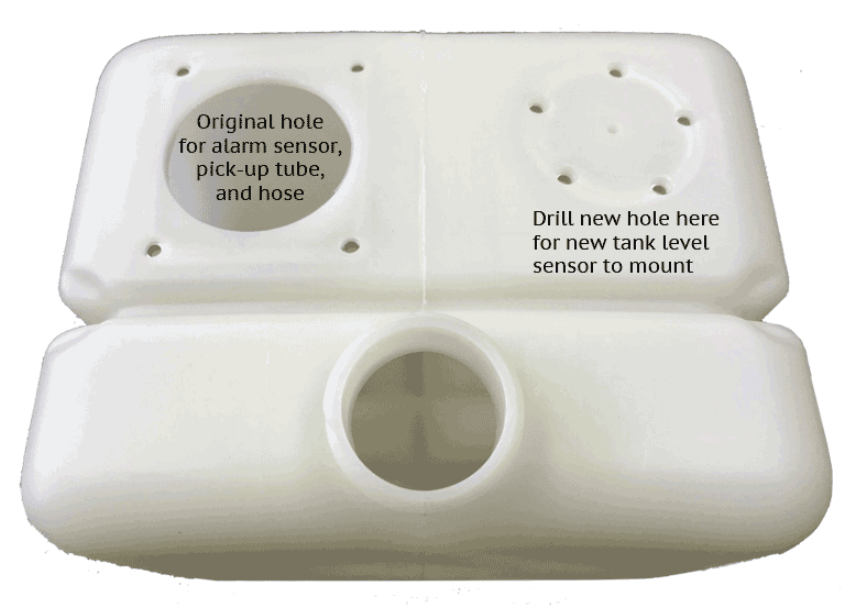

In order to show oil tank level, a sensor must be added to the standard oil tank to read the tank level. The sensor will typically be a resistive type tank sensor. These sensors must be added to the existing oil tank. The plastic body of the oil tank will already have a bolt circle embossed into the tank, and the tank level sensor is typically installed there. To install a sensor, a 1.375-inch diameter hole will need to be cut into the tank within the bolt circle. There may already be an embossed relief molded into the tank in the inner portion of the bolt circle. Also note that the fastener holes in the bolt circle are not symmetrical, so be certain to carefully align the sender and its gasket with the fastener holes, and verify the location of the new hole before drilling.
Fig. 1. A typical 3-gallon Evinrude oil tank. This tank has been modified by drilling a 1.5-inch diameter hole centered on the five-bolt bolt circle. The sensor (shown not mounted) will be installed in this new hole. A cork gasket will be used to insure good sealing. Photo credit: GOTSEA
Fig. 2. A typical 1.8-gallon Evinrude oil tank. Check the location of the embossed hole where the new sensor will be installed to be sure it is aligns properly with the sensor and gasket hole layout.
Drilling into the tank top will create debris in the tank. The tank must be carefully cleaned of all debris before being return to service and filled with oil.

A further consideration with the oil tank sensor is the size of the tank. Evinrude has two oil tank sizes, 1.8-gallon and 3-gallon. An oil tank level sensor that matches the tank capacity (height) must be used. The 1.8-gallon tank uses a sensor with 6.5-inch height. The 3-gallon tank uses a sensor with 8.5-inch height.
