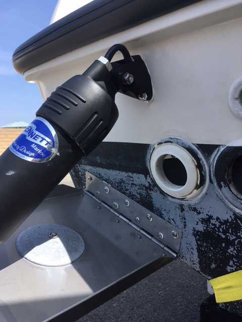

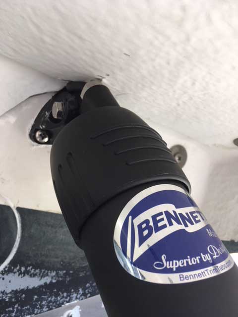

FOLLOW UP: I installed Bennett Bolts Model 9 x 12 Edge-mount trim tabs. I didn't want to deal with hydraulic lines. I installed the simple rocker-style helm control (not shown).
Fig. 1
Fig. 2
Fig. 3
As you can see from the starboard swim step pictures, I used a small rotary tool and created more recess to accommodate the tabs. All said and done, I achieved a 3/8-inch negative articulation, not the 5/8-inch recommended by Bennett.

Thank you for the follow up report and the illustrations.
I re-oriented your images so they would appear correctly as in-line elements, added them to your initial reply, and gave them identifying captions.
I believe Fig.1 and Fig 2. show the starboard side installation of the actuator mounting under the swim platform.

Steve, in your photos I cannot tell if you used edge mount tabs versus conventional tabs. Can you enlighten us before I proceed further?

He used the edge mount tabs. If you go back you'll see where he identifies them and can also tell by the pictures.
Looks like a tight fit on the side with the boarding platform and slight modifications (dremel work) to get it tucked in under the platform.
