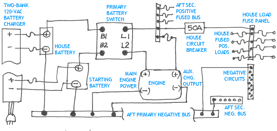

Here is a sketch showing wiring for primary power distribution for a boat with two 12-Volt batteries and one outboard engine:
Fig. 1. Primary power distribution with two batteries, one engine with auxiliary charging output.
As shown above, the outboard engine has an auxiliary charging output. This is a common option on modern outboard engines, and it permits the engine to independently charge two batteries without having to put their loads in common.
A general goal of the layout of the wiring has been to keep the number of terminals fastened under a terminal post to one whenever possible. The only instance in this design where more than one terminal is under a fastening post is at the battery terminals themselves. However, some batteries have two sets of terminals, SAE and threaded-post, so if batteries of that type are used there will only be one terminal under each fastener.

PRIMARY BATTERY SWITCH
The switch is a modeled after the BLUE SEA SYSTEM "Dual Circuit Plus" Model 5511e switch. There are four terminals on the switch: two for batteries, and two for loads. The switch has three positions. In the OFF position no batteries are connected to any loads. In the ON position, B1 connects to L1 and B2 connects to L2. In the EMERGENCY position, B1 and B2 are both connected to L1 and L2. The normal operating position is ON. The two batteries are isolated, as are their loads. If the starting battery does not have enough charge to crank over the engine, the switch is moved to EMERGENCY, paralleling the batteries temporarily for engine starting.

TWO-BANK 120-VAC CHARGER
Having a means to charge the boat batteries from 120-VAC that is permanently installed is very useful. There are many choices for a 120-Volt AC powered two-bank battery charger. For many boaters, a high-current charger is not necessary. A two-bank charger with a modest charging current of 5-Amperes will often be sufficient to replenish any lost charge in the boat batteries if left on for a few hours.
A charger with fused outputs is recommended. For long-term storage, as in winter, the charger can be completely disconnected from the boat batteries in order to reduce any stray load currents by removing the fuses in the charger leads.
My own boat has a ProMariner two-bank charger that has worked well for many years. It has 5-Ampere charging. The typical use is to operate the charger from 120-VAC with an extension cord. If the boat has not been used in several weeks, I typically top-off the battery charge for a few hours before heading to the launch ramp. If the boat is in use and we are staying overnight at a dock or marina with 120-VAC power available, I use the charger to provide power to the batteries while we use cabin lighting in the evening.

AFT POSITIVE and AFT NEGATIVE SECONDARY BUSES
For a HOUSE battery located in the stern of the boat, having local secondary distribution buses will be convenient for connecting secondary loads which are located nearby. These fused loads will usually be sump pumps which are controlled by automatic switches. The aft negative bus can also be useful for house loads that are controlled at the helm but are located near the stern, such a navigation lighting. The negative circuit for those loads can be connected to the aft negative secondary bus instead of running back to the helm.
The Auxiliary Charging Output of the engine is also connected to the HOUSE battery by a fused connection to the aft secondary positive bus.
For many iinstallations, a Blue Sea System model 5025 6-circuit fuse panel with negative bus can fulfil the role of the aft secondary positive and negative buses.
For aft loads with higher current demands such as electric propulsion motors ("trolling" motors) or large pumps, a Blue Sea Systems model 8690 Battery Management Panel may be useful. This panel will combine the primary battery switch, the house circuit breaker, and several fused secondary loads into one panel.

HOUSE DISTRIBUTION PANEL
Even on a small boat, a house distribution panel with 12 fused circuits is not excessive. The loads typically will be electronic devices, such as a VHF Marine Band radio, a SONAR, a chart plotter, and lighting loads, such as navigation lighting, cockpit lighting, and cabin lighting. Sump pumps are also typical house loads. The Blue Sea System model 5026 12-circuit blade fuse with negative bus and cover is a good choice.
