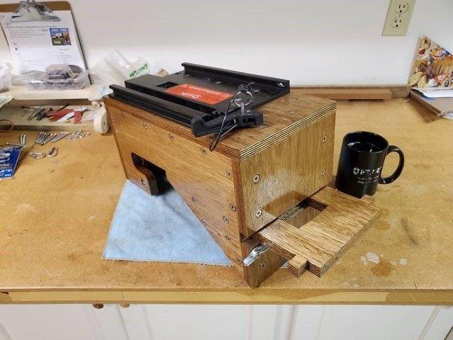

The project of installing a bow mounted trolling motor and pedestal fishing seat within my 1987 Boston Whaler Super Sport 13 was completed in the late spring of this year. I used the boat throughout this past summer and the modifications which I have made for fishing have exceeded my expectations.
Part #1: Trolling Motor Mount: The most challenging and time consuming task was to fabricate the removable marine plywood trolling motor mount. As described within my initial post, the mount secures to the lip of the bow, over the bow light, and is held in place by a piece of plywood which slides beneath the boat's norman pin. While I included a provision to remove any lash via a turnbuckle to be attached to the bow eye, the accommodation was found to be unnecessary as the mount had virtually no lash following installation. As part of a modular design approach, a Minn Kota quick release trolling motor mount was installed atop my fabricated mount. As the trolling motor is fairly heavy, this modular approach permits the trolling motor to be mounted after my fabricated mount has been installed. As no fasteners are used to secure the fabricated mount to the hull, this solution leaves no traces when the trolling motor and fabricated mount removed to permit the boat for other applications. Photos of the mount may be found below:
Ready for Installation
Installed

Build your own copy of my trolling motor mount:
I have been contacted by some viewers of this thread who have voiced interest producing a copy of my trolling motor mount for their late 50s through early 90s Standard 13, Sport 13, Super Sport 13, Sport 15, or Super Sport 15. To support this end, I have produced tracings of my mount and have applied some measurements to the tracings. While the mount fits well on my ’87 Super Sport 13 with original rub rail, those producing a copy for their '83-94 Standard / Sport / Super Sport 13 may need to make slight adjustments to permit the trolling motor mount to snugly fit their own boat. Those having earlier models of Standard 13, Sport 13, Super Sport 13 as well as those having a '79-95 Sport 15, or Super Sport 15 may find that the side profile and position of the sliding key lock opening will need to be modified to fit their hulls and permit the locking key to slide snugly beneath the boat's norman pin.
I have taken several photos of the mount from various angles to aid those interested producing a mount for their own boat as well as to understand how the mount is assembled and functions (ex. note the cutouts in the locking key runners permitting the mount to be positioned over the norman pin). I have additionally produced three tracings of the fore, aft, and side profiles of the mount and saved these as PDF files. I have then added the photos and PDF files to my Dropbox. When printing the PDF files, be certain to print them at 100% of the original size. Because of the size of the Side Profile Tracing PDF file, those lacking a printer capable of printing a full size copy of Side Profile Tracing would be advised to take the PDF file to Kinkos, the FedEx Store, etc. to have a full size print produced.
Anyone interested in viewing / downloading these photos and/or PDF files may reach out to me and I in turn will provide them with access to my Dropbox. Any questions concerning the mount should be asked as posts within this thread to permit other who may have similar questions to also have access to the related information.

Mount Construction Hints
General:
• Consider using marine grade ¾” plywood rather than standard grade. While more expensive than standard grade plywood, marine grade plywood has the advantage of durability, additional layers, no voids, uniform strength, and quality finishing.
• Consider creating a mockup with scrap / lower cost material before committing to final materials.
• Consider creating a template for the sides from a piece of material which may be easily filed or sanded (ex. Masonite, etc.). Using the template which I have provided as a starting point and then make the necessary modifications to fit your boat.
• Dry fit mount before committing to drilling for final fastening of cleats and runners. To facilitate this end, I used a brad nailer to temporarily fasten the cleats and runners to the plywood. Should they later need to be removed, then they may simply be pried from the plywood and the brads may be clipped off. When final positioning of these items has been determined, then holes and countersinks may be drilled to permit fasteners to be installed.
• For fastening, I recommend use of wood glue followed by stainless steel machine screws, washers, and nylox nuts. Stainless steel fasteners may be economically purchased in bulk from online sources such as the Bolt Depot.
• Protect the mount with quality sealer / finish. I used several coats of Petit 1015 Captains Varnish.
Installation of the locking key’s runners:
1. Create four locking key runners having dimensions ¾” x ¾” x 5-1/2” from hardwood.
2. With the aft plywood pieces of the mount not yet attached, position the mount in place over the bow norman pin.
3. Insert a loosened adjustable square beneath the norman pin on and against the rear edge of one of the mount’s sides.
4. Draw out the square’s ruler until it just clears the norman pin and note this measurement. This measurement will mark the rearmost edge of materiel which must be removed from that side’s runners to permit the mount to pass over the norman pin.
5. Repeat steps 3-4 for the opposite side.
6. Insert an adjustable square beneath the norman pin on and against the rear edge of one of the mount’s sides.
7. Raise the adjustable square until it makes contact with the norman pin.
8. Mark the inside of the mount’s side to denote where the lower edge of that side’s upper runner will be installed.
9. Repeat steps 6-8 for the mount’s opposite side.
10. Remove the mount from the boat.
11. Reposition the square at one of the marks made and extend the line fully forward.
12. Repeat step 11 for the opposite side.
13. Unbolt the sides from the mount.
14. Position the bottom edge of a upper runner on one of the lines.
15. Use a brad nailer to tack the upper runner onto the mount’s side (this will be a temporary fasten).
16. Repeat steps 14-15 for the opposite side.
17. Place the locking key against the bottom edge of the upper runner on one of the mount’s sides.
18. While holding the locking key in place, position a lower runner onto the mount’s side and pressed against the locking key (remember that the key must be able to slide, recommend using a piece of thin cardboard (ex. Posterboard, notepad backer, etc.) between the key and the lower runner to create consistent clearance).
19. Use a brad nailer to tack the lower runner onto the mount’s side (this will be a temporary fasten).

In the Spring of 2021 I purchased my third classic Boston Whaler. This time, I purchased an 1988 Super Sport 15. I have restored the boat and have incorporated all of the modifications which I have listed within this thread. The details of the removable bow electric trolling motor mount which I have produced for this new boat may be found at: https://continuouswave.com/forum/viewtopic.php?f=6&t=6600.
The new mount.

After receiving some feedback, I have altered the design of my mount to include an additional means of securing its aft end to the hull. This has been easily accomplished by installing a 3/8" stainless steel eye within the mount's upper aft panel. A 3/8" stainless steel turnbuckle will then be used to connect the eye nut of the bow eye to the aforementioned 3/8" eye bolt. The additional security measure should greatly reduce the risk of shearing the norman pin when operating in rough conditions. Should the mount's locking key have interfered with the turnbuckle, then the aft edge of the locking key would have been notched to provide the necessary clearance for the turnbuckle to be tightened or loosened. The turnbuckle also provides additional protection against the mount's locking key inadvertently backing out.
Is the turnbuckle excessive? Perhaps, but this addition is cheap insurance against loosing the almost $1900 trolling motor, Minn Kota mount, and the fabricated mount over the bow.
I have forwarded this information to the current owner of my '87 Super Sport 13 in order that he may make this same modification to the wooden mount which has been detailed within this thread. The photograph below shows the turnbuckle addition to the mount which I have made for my '88 Super Sport 15.
