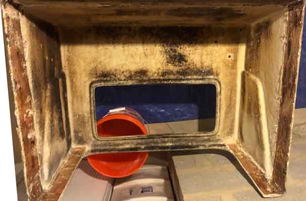

I have a 1974 MONTAUK 17. While I wait for the weather to get warm I have started [refurbishing] the center console and seat.
In regard to the wood that was used to frame out the interior of the seat and console. When removing the wood it was clear that it took on a lot of moisture and was essentially flaking off when I was removing it. I have heard that marine grade plywood is not necessary as the wood will be applied with a heavy amount of fiber glass and resin, and then drill holes will use Loctite. My plan is to apply the new wood with a liquid nails product and then wrap the wood with the glass and resin.
Q: Do readers have suggestions?
Thanks

You mention that you removed the wood backing, but the illustrations you added appear to show the wood backing in place. I don’t know what inference to draw from the illustrations. Please give them captions to explain what is to be illustrated by the images.

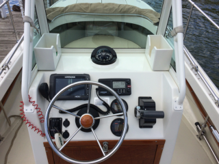

Postby Don McIntyre - MI » Thu Feb 13, 2020 3:50 pm
Here's my dash. One other suggestion. Install at least one USB charger connection. That's one of the two black circles...
