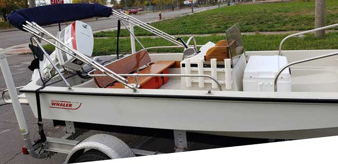

I have a 1983 Center Console 15 that is in very good original condition. The original wood seating is in place and has been well maintained.
Fig. 1. A 1983 Center Console 15
I thought of ordering a full set of cushions for the bench and bow area, but, after a season of use, I find the bench seat to be too low for comfort for a taller person. I have been in touch with Anderson's [about making a special cushion], but they can only replace the original cushions designed for the boat.
I contacted Martin Marine Design--I got the swim platform from them--[and asked them] about fabricating a new adjustable seat back that I could clamp-on with stainless fittings, without changing any of the original stainless railing.
I would like to have about a six-inch-cushion, if it sits on the current wood bench, and a back cushion that is situated higher to support the back.
[Seeks ideas from others who have had the same problem with uncomfortably too low seating in a 15-footer]

I can suggest, while keeping the original wood and railing, attach a short pedestal seat to the wood bench. The pedestal for boat seats come in many heights. To the pedestal you can mount the high backed seat of your choice.
I also hated the short bench seats in all the Whalers I looked at. Getting up was painful for me.
I searched for a 15' Whaler bare hull so I could make it fit my needs. Finding one, I used a flip back cooler seat for sitting at the console.
Then I fabricated a mahogany bench similar to yours to cover the twin on-deck fuel tanks.
Then I installed two swivel high-backed seats to the bench for passengers.
Up front where you have a cooler I put the battery and made a hinged wood cover to protect it. To that I installed a pedestal and another high backed swivel seat. [This seat] s very comfortable and allows a passenger to fish the front of the boat in comfort.
Make a test and see what height is comfortable for you. Then see who makes an aluminum pedestal that will give you what you want.
The Tempress-model high-backed padded swivel seats are hard to beat.

Consider installing taller risers and placing the bench seat on the top of the riser. Just as effective, less expensive.

Only problem Phil is the railing. I was going to do this on my 13' but it would require raising the entire railing the same height.

Have to agree with this comment. The Sport 13 wrap around rail is the same setup as used on the 15 center console and the mounting brackets of the wrap around rail bolt to the bottom of the thwart seat, so my raising the seat, you create and concern since it will no longer align with the rail that is a fixed height based on how in mounts to the hull. There are several modifications that run through my mind, but rather than over complicating this, let's agree this is not an option.
I raise the thwart seat in my 15' Supersport 1.5" and this easy since the rails do not tie into the seat itself.

What about something like this Tempress high backed bench seat?
https://tempress.com/store/48-Folding-Boat-Bench-Seat-p97903361
If it is not tall enough you can adjust the height by spacing it above the plank with another plank. You could even fill the space with flat tackle boxes.
I was going to use the Tempress bench on my 15 footer but instead I used two of the high backed swivel bucket seats.
