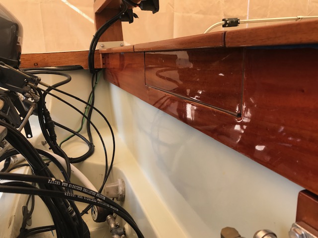

My Evinrude 225 does not have a tilt limit switch so I made a door [in the new aft cockpit bulkhead that can] open for clearance at full tilt of the engine.

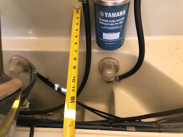

You will notice in the Figure 2 and Figure 3 the fuel line now passes through the original dam of the engine splash well. I drilled through [the original splash well dam] and epoxied in place a stainless steel nipple.
This new bulkhead creates nice place to install a water-fuel separating filter out of the way and above water level.

The stainless nipple I installed goes from the cockpit live well under the floor through the sub-floor bulkhead and into the engine splash well. Shown in the picture after paint, but the fuel line was pushed into the drain sump when this picture was taken and not attached yet. This change in the fuel line route could be done on an Outrage as well.

If you had installed a 10-inch set back bracket, could you have avoided the hinged cut out [refer to Fig. 3] in the bulkhead for tilt clearance?

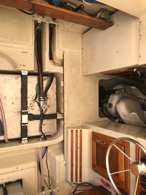

The Starboard rigging tunnel [refer to Fig. 6 and seen at the top] appears to have a small bulkhead separating it from the overboard drain sump ahead of the original bulkhead and outboard of the live well. Did you add that?

padrefigure wrote:If you had installed a 10-inch set back bracket, could you have avoided the hinged cut out [refer to Fig. 3] in the bulkhead for tilt clearance?
I originally thought about the 10-inch set back bracket to make clearance. But, these narrow bottom hulls don't perform well with a lot of additional weight on the transom and moving the engine back 10-inch adds dramatically to that equation. My goal was to keep the total weight of the engines and rigging on the transom equal to the original weight of twin 115-HP two-stroke engines. My design (with a raised kicker) added additional torque to the transom so I felt it needed to be reinforced to spread out the added pressures. For strength, I added full width by 13-inch high 1/4-inch aluminum plate both inside and outside of the transom.
I believe in mounting my auxiliary engine high to keep stern swell and waves from splashing into the power head so I mounted 1 x 12 x 19-inch aluminum plate to the transom to raise the auxiliary engine to the extra-long-shaft height; this brought the bottom of its power head very close to the bottom height of the main engine. I don't remember the figures now, but the weight of the aluminum added to the transom, the jacking plate, the 1-inch auxiliary motor mount plate, the 9.9 Yamaha High Thrust kicker, along with the 1986 Two Stroke Evinrude 225 came out very close to the weight of two 115-HP engines the hull was designed for. I'm a big fan of two-stroke power and this could not be done with a new V6 four-stroke-power-cycle engine, so I had the 1986 Evinrude 225-HP engine rebuilt from the flywheel to the propeller shaft. This keeps the boat to a retro mode, and the boat performs terrifically.
Now that I think about it, if using a newer engine that has a limit switch on the trim, then a 5-inch set back bracket would work without the door at the top of the new stern bulkhead.
padrefigure wrote:The Starboard rigging tunnel [refer to Fig. 6 and seen at the top] appears to have a small bulkhead separating it from the overboard drain sump ahead of the original bulkhead and outboard of the live well. Did you add that?
My boat is a 1980 22 foot Revenge. My goal was to stop any water from getting to the fuel tank and I achieved that goal in part by running the rigging down the gunwales instead of utilizing the factory rigging tunnel. This allowed me to add that bulkhead you mentioned bow side of the drain sump. The bulkhead is made from foam sheet cut to shape, fiberglass and west systems epoxy. This allows the drain sump to be utilized as designed but blocks water from getting into the original rigging tunnel. I put a 1-inch tube and plug at the bottom of that mini bulkhead for inspection (via access through the drain sump) to periodically check to see if water got past it.

Regarding the new bulkhead added to prevent the rigging tunnel from connecting to the cockpit sump on starboard:
Wouldn't water be able to get into the rigging tunnel at the cockpit end of the rigging tunnel if the deck became flooded with water?

Excellent work and finish work. Only small suggestion I'd have is (probably too late) to consider making the door for the engine clearance spring loaded. No accidental tilting up to far and cracking the great looking door!

jimh wrote:Regarding the new bulkhead added to prevent the rigging tunnel from connecting to the cockpit sump on starboard:
Hi Jim,
I didn't see your question until now.
The 1979 and 1980 Revenge models have a one piece floor cover over the fuel tank. This creates a huge job to remove the cover because both of the cabinets at the helm have to be removed for access. You are correct, originally the factory cut a square hole in the floor cover under the helm cabinet and ran the rigging down through the floor cover into the rigging tunnel. While I had the cabinets out and to prevent water from accessing the this factory access hole; I blocked it off with plywood, fiberglass and West Systems epoxy. While I had the cover off, I cut it along the cabinets similar to the factory change on later Revenge model boats. This way, if there is ever a need to get into the fuel tank area, the cabinets will not need to be removed.
