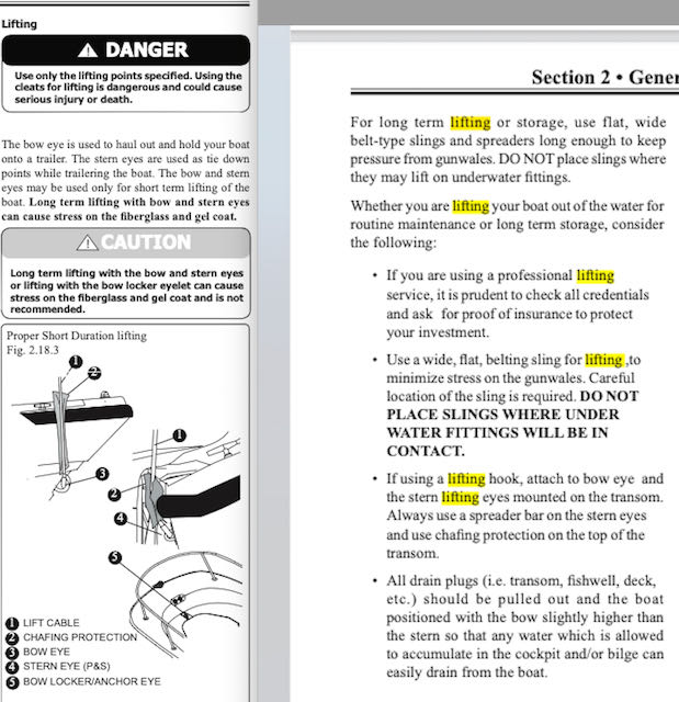

I was not thinking twice about using the bow eye and the two stern eyes to hoist the boat, but I received feedback from Boston Whaler (and read in the owner's manual) that those eyes are to be used only for short-term lifting.

Here are the pages from the manual.
Screen Shot 2021-04-07 at 9.31.50 PM.jpeg (85.21 KiB) Viewed 10956 times

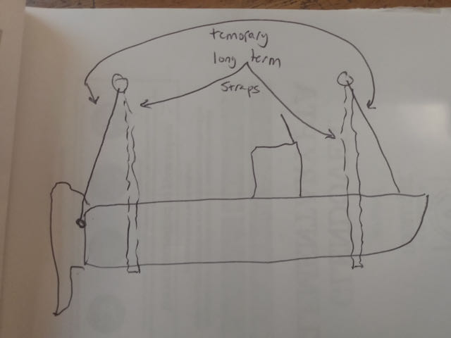

Personally I would lift the boat with wire cables then position wide lifting straps slightly forward of the transom and a second aft of the bow and support the hull that way.
The straps would be set at a fixed height and the wire rope would be for lifting and lowering only. All weight would be on the straps.
For storage for a few days, use the eyes.
Once you figure out the rigging, it should not be hard.
Here is a rough drawing.

With regard to the exact duration of a period of time described as "short-term", I would ask Boston Whaler for a specification. To me, short-term means an hour.
What Boston Whaler is clearly saying: don't hoist the 170 MONTAUK by the bow and stern eyes and let it hang that way for days or weeks or months. They must have some basis for giving that advice.
Whether some other 170 MONTAUK owner attests that they could hoists their boat in a manner contrary to Boston Whaler's advice does not seem particularly dispositive that it can be done with no harm.
Another solution: lift the boat with the bow and stern eyes as you planned. Then position two cross member timbers under the hull and lower the hull onto to them. That might be awkward, but perhaps it would be a better method for long-term out-of-the-water storage.
The notion of hoisting a Boston Whaler by the bow and stern eyes was probably more workable with the 13 and 15-foot hulls. The weight of those hulls was much less than a modern 170 MONTAUK. The strength of the bow and stern eyes and the points where they are attached was then the same as now--but the 170 MONTAUK is much heavier.

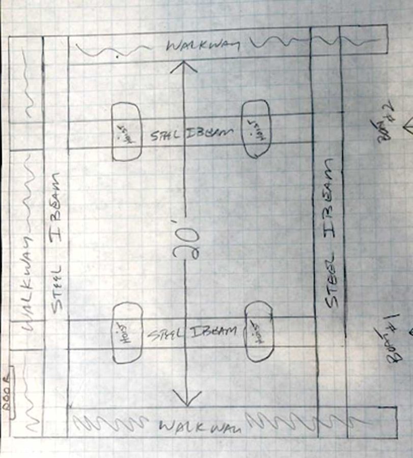

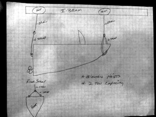

I decided to draw what the boathouse looks like since you all had some great ideas on how to add additional support.
[Changed topic to discuss how to upload images and make them in-line. Please visit the INTRODUCTION FORUM and read the article on adding images files to a post and maximum image size. The GAM forum is for boating topics. The INTRODUCTION forum is for help with using the forum software.--Moderator]
The width of the internal boat house prohibits me from sticking boards underneath because they would need to be more than 20' long. The boathouse is one big slip. It would also be hard for me to add additional wide straps to wrap underneath for extra support unless I got into the water or used a hook to grab one end of it from one side of the boat to the other. Nothing is impossible however doing these two suggestions would be something I wouldn't want to do.
The other alternative is to use the straps from each hoist to secure the boat from hitting the sides of the boathouse but then I would leave it in the water.

Fig. 1.

Fig. 2. Hoist strap detail.

Thanks Phil. My hoists are rated at 2-tons each they have a chain with a loop at the end which I then connect industrial straps to each hoist independently then to the boat eyes. The straps are nylon and rated for 4-tons each. My concern is more about the potential of damaging my new 170 MONTAUK rather than keeping secure. With the boat in the boathouse, it would be very protected and secure.

What is the dimension for the distance between the I-beams the support the hoists in Figure 1?
Is the location of the hoists on the beam supports fixed or moveable?
From Figure 1 I infer the boathouse is open to the sea on the right.
[Note: I reoriented the image files in Figure 1 and 2 to make the text upright when viewed as in-line files in HTML.]

Regarding why Boston Whaler explicitly cautions against lifting the 170 MONTAUK by its lifting eyes for "long term", it has been suggested that this is due to concern about exposing Boston Whaler to risk of being "liable" for some future harm.
I think the risk is clearly laid out in the cautionary statement in the owner's manual: what is at risk is the occurence of "stress on the fiberglass and gel coat." And the risk is that such outcomes "can occur."
These are really rather mild terms. The advice is just cautionary. The risk is something than "can occur." They don't explicitly prohibit the practice. And they further obscure the basis for the occurrence by limiting it to "long-term" practice.
The boat under discussion is a 2013 model, possibly made in 2012, so its ten-year hull warranty is going to expire in a year or two.
I'd try lifting the boat using the eyes with the strongback frame I described above, and then carefully watch for any indication of harm to the gel coat and fiberglass of the hull around the lifting eyes. If a big crack develops after one week, then you have the answer to how long a "long-term" use was.

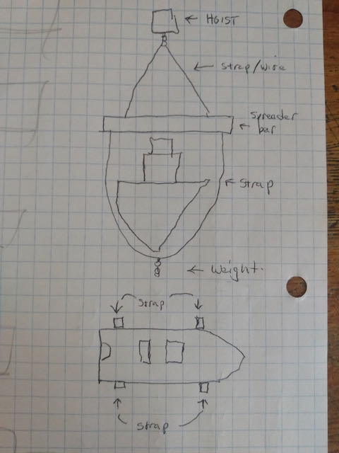

Instead of a two step hoist I described above, consider going with a spreader bar type setup.
From each hoist would be two straps/wire cable to a spreader bar the legnth necessary to span the beam of the boat.
From the each spreader bar a strap (with small weights) would fall from the end, down and around and back up.
One would enter the boat house with the straps in the water ~1ft. On reaching a location where the straps were lined up with pre-set marks on the gunwale, the hoists would raise the boat.
Given the boat only needs to be lifted a 1-2 feet off the water, if a strap did fail, it would not be catastrophic.
Horrible drawing not to scale:
Drawing

JIMH--I think the distance between the two I-beams the hoists are at least 10-feet. The width of the whole bay accommodates two boats to fit into the boathouse. The I-beams are rated at more than 15-tons. The hoists are connected to the lower portion of the beam and operate on wheels, and in that way they automatically adjust to the size of the boat, always creating vertical lift and reducing stress. The boathouse is on a large inland lake. There is a vinyl door that rolls up and down to protect the boats from any outdoor weather. Thank you for adjusting the images.
PHIL T--the spreader bar is a good idea; we used that for a jet ski connected to a cradle. I will have to look at that more closely to see if we have the height in the boathouse so that it didn't hit the center council. For our jet ski, the spreader bar was always in the way of our heads.
