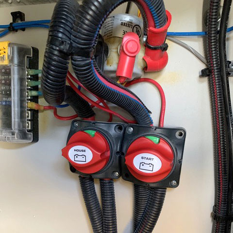

210 GUARDIAN owner Peter sent me this image of the Boston Whaler factory-installed battery switches:
Fig. 1. Two BEP ON-OFF battery switches for HOUSE and START batteries. Above the switches a remotely controlled solenoid places the batteries in parallel for emergency starting.
Peter--thank you for sending me the images. I hope some other readers will send in some photographs of the battery switch on their Boston Whaler boats. Only from participation in sharing information is there is information to share.
